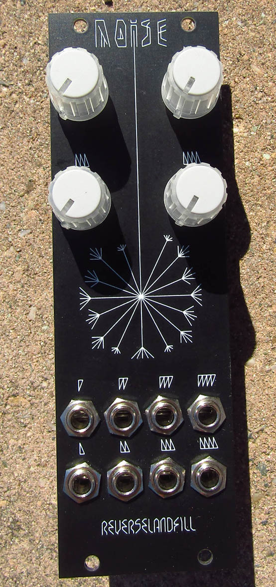

This is an experiment with my newest Noise Module v8.
I wanted to see if the outputs are useful for video. Turns out they are!
The Noise oscillator is very chaotic, so the noise image is not static (no pun intended).
Note: The audio track is unrelated (it’s a fieldrecording of a liveset I did)
Next up I’ll try to sync the image.
module2web
The Noise v8 module gives you a wide range of noise effects when used for analog video.
The outputs have to be attenuated to comply to the video voltage format.
I used my Matrix Mixer for this purpose. The range jumpers on the back on the module set the frequencies to a lower range.
When the noise is used together with a keyer, interesting results can be achieved.
For more information on the Noise module: https://www.reverselandfill.org/diy/noise-v8/

I did some testing with syncing this type of oscillators, with reasonable results.
I think I will build a prototype focused on video, with LM6172 buffers and the proper voltage scaling

My one thought is that it would be cool if the range selection could maybe be brought to the front panel (rather than a jumper).
Also making me realize I need to test out the noise capabilities of various audio synths I have with my LZX system! (Though it is probably all way more vanilla/boring-looking than what you’ve got here.)
#4 — reverselandfill · 2020-07-27
you got a point.
it is an interesting feature , so it should be accessible.
it is on the back now, because the pcb is very crowded already. as a sort of expansion option if you make your own panel for it.
But 2 pcb’s stacked would be possible (and necessary when those buffers are added)
