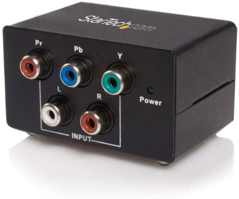

i am having trouble sending a signal to my very old and heavy Sony multiscan 200es CRT computer monitor. I am sending a signal from the visual cortex ypbpr output to the VGA socket of the monitor. The Sony monitor displays OUT OF SCAN RANGE.
here is a link to the monitors manual which includes its signal specs. https://www.sony.com/electronics/support/res/manuals/W000/W0002477M.pdf

for any other lost souls out there also stumbling across deserts of ignoramus like myself. re: the component out > vga in connection; you need some kinda hardware converter… i think…
praps like this >

https://www.amazon.com/StarTech-com-CPNT2VGAA-Component-Video-Converter/dp/B0014BL9POAmazon.com: StarTech.com Component to VGA Video Converter with Audio - Scan Converter (CPNT2VGAA),Black: Home Audio & Theater
Link: Amazon.com: StarTech.com Component to VGA Video Converter with Audio - Scan...

just ordered a converter box. i’ll let you know what happens. but good to know there are other options. i read somewhere that a vga signal is totally different from component and needs unscrambling/scrambling. obviously the monitors you’ve noted are simply taking a component signal via the vga socket?
#5 — horacio2222 · 2020-08-04
well, the converter does the trick - however a little disappointed with the monitors’ brightness and detail.
#6 — Vdot · 2020-08-04
