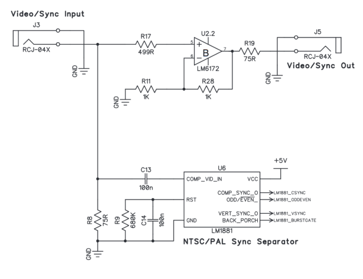

I’m designing a module(1) that’s going to have RCA Sync In (to a LM1881) and I’d like to have RCA Sync Thru also, but I’m not sure the best way to accomplish this. I had been planning on using the portion of the Cadet 1 schematic that does this. Video/sync in, terminated by 75R to ground, and it goes to a LM6172 buffer via a 499R (and to the LM1881 via a cap), and the buffer outputs the thru signal:

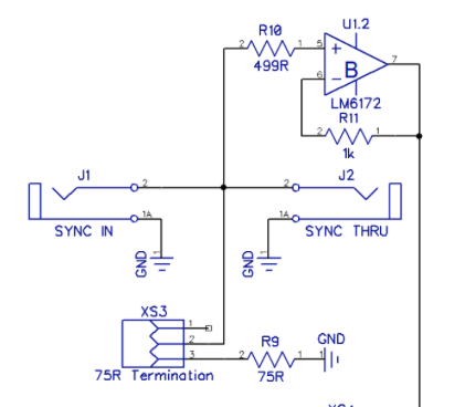

But recently I noticed that Syntonie’s VU001 handles Sync Thru a little differently… Input is directly tied to output, a jumper can terminate input to ground if you want, and input goes to a LM6172 buffer via a 499R and continues to the rest of the circuit:
vu001-rca-sync
So, I’m curious if @creatorlars or @syntonie (or anyone else who understand video electronics!) would care to comment on benefits/drawbacks to the different methods. One thing I like about the Cadet method is that users never have to deal with a termination jumper, since the input is always terminated. I don’t have anything that syncs via RCA, so I can’t test for any noticeable differences in behavior.

#2 — creatorlars · 2020-08-12
Both approaches are valid. Generally there is a buffer when it’s a frontpanel jack, but maybe not one if the sync is just going to an LM1881 and meant for backplane distribution. The primary advantage to the second circuit is that you do not necessarily need U1.2 (the opamp buffer) if, for example, you are terminating the sync at the LM1881 and not going further with it. That may be just perfect for your project’s needs.

#4 — syntonie · 2020-08-12
Hi @joem and @creatorlars, the buffer (U1.2) can probably be bypassed and the circuit will work in a similar manner. I’ve added it so the front RCA input and the sync in on the back have independent input load (so you can set the sync termination without affecting the front input termination), so it avoid having the signal at the front RCA to be unterminated when using it as a distribution amplifier. Also, felt bad having this extra op amp with no use
:upside_down_face:
The schematic you posted looks right, no need for an op amp if you send the signal to the sync extractor directly and doesn’t require further processing.
