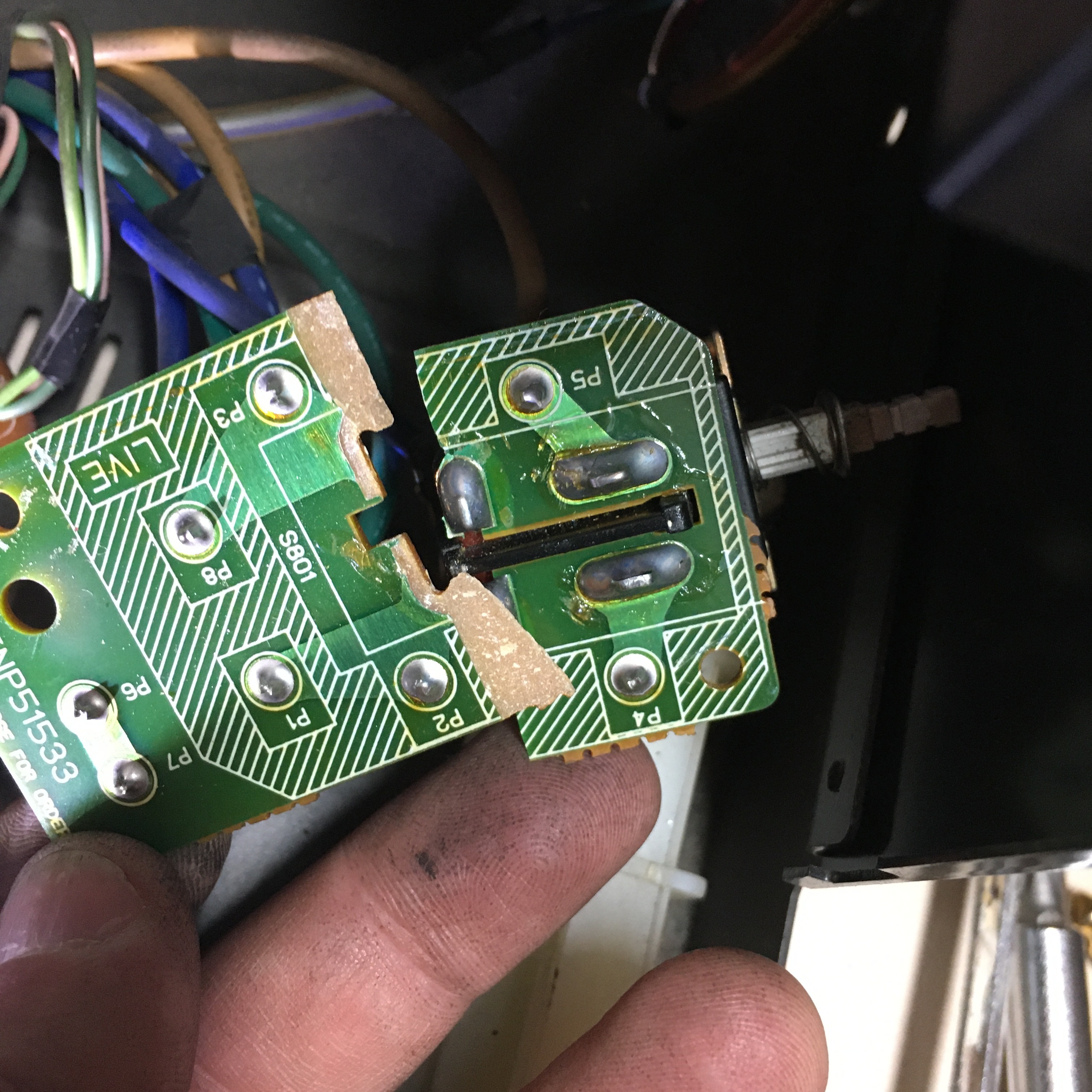

I bought a Panasonic BT-M1400psn off of him. He sent me a few photos of the unit in action and I asked twice about his ability and commitment to safe shipping from DE to Austria. He assured me that he could do it with no problem.
It came in a decent enough box but was without arrows marking ‘which way up’ and no warnings of fragility on the box. It was left in front of my door on what would turn out to be its face (glass down).
Unit does not power up. Packaging was quasi-decent with foam blocks taped to the sides but LOTS of loose newspaper stuffed in the spaces as if that would do anything to prevent shock to a monitor.
Dude cares not and told me that even shipping it to me was ‘a favor’… I’m not even going to go into that ex post facto absolution of responsibility.

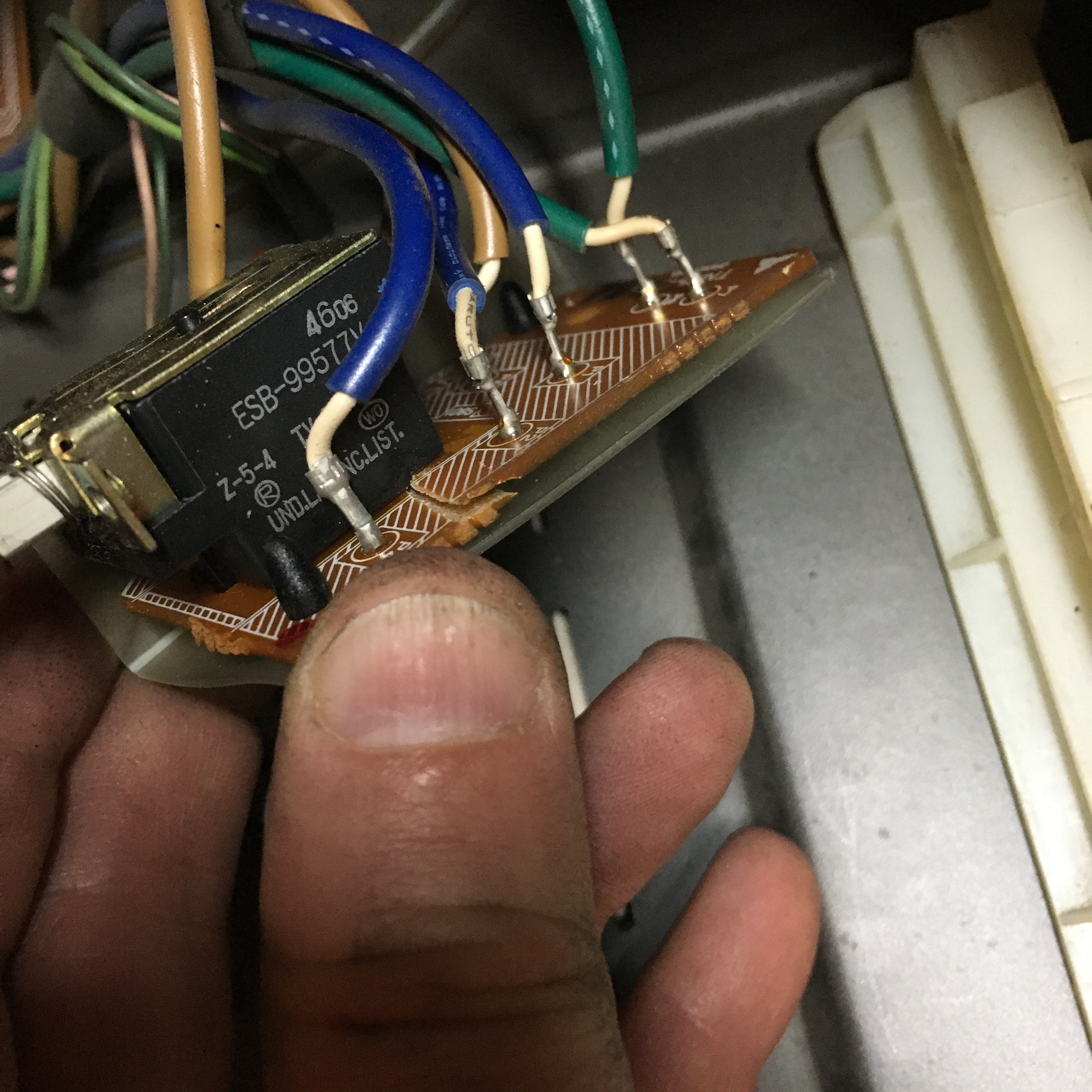

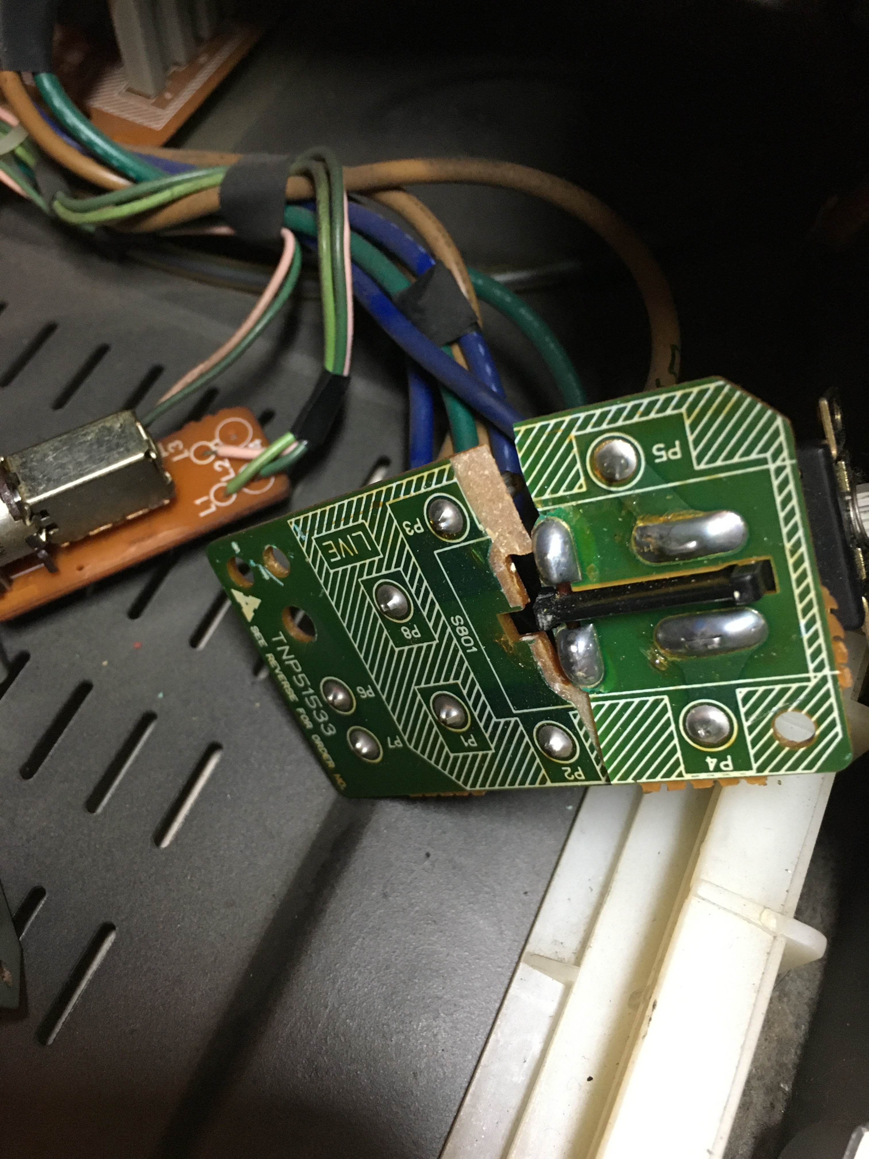

Cracked it open last night to start the investigation (naturally, focused upon the power button area first (yeah, yeah, yeah, discharging through a 100W resistor and other safety precautions were actually first, etc…)
I don’t see how this could have happened in shipping given the fact that the box is in ‘good’ and monitor is in ‘very good’ cosmetic condition. I think that he did a switcheroo on me. There is no damage to the button or that area.
I’ve got two words to describe that guy: one starts with “F” and the other with “A”.
First and last time I’m buying a CRT without inspection and personal pickup. I should have listened to myself about shipping CRTs by persons lacking the track record; or care!

Sadly, that service is not offered with the small ads. I’ll fix it tonight and carry onward.
#14 — Kent · 2021-04-29

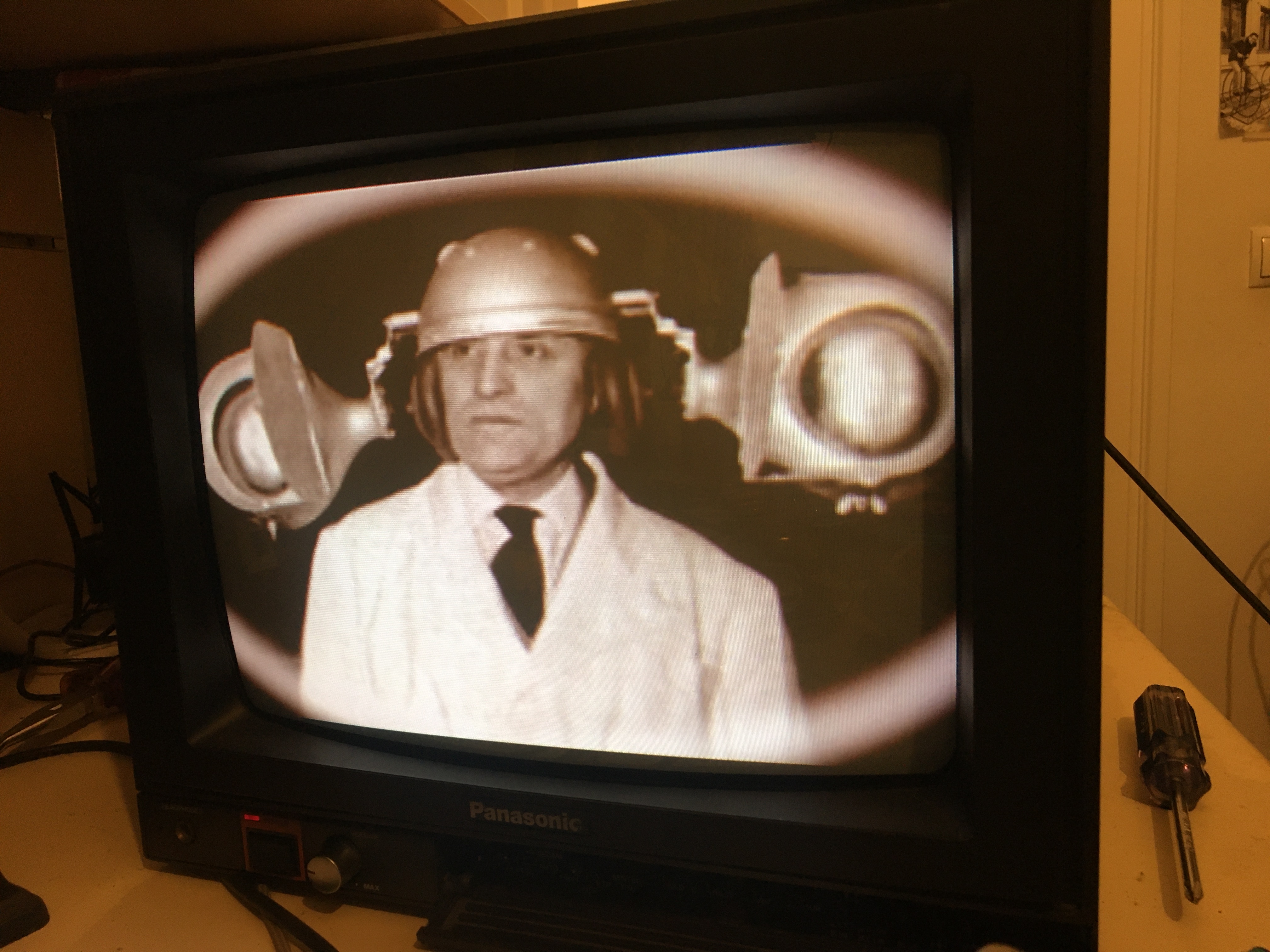

Repaired and will calibrate in the morning.
Let’s all heap praise upon Xacto knives, compressed air, component legs, toothpicks and hot/Krazy glue.
The split was right at the weakest point where 2 solder points were through the PCB.
