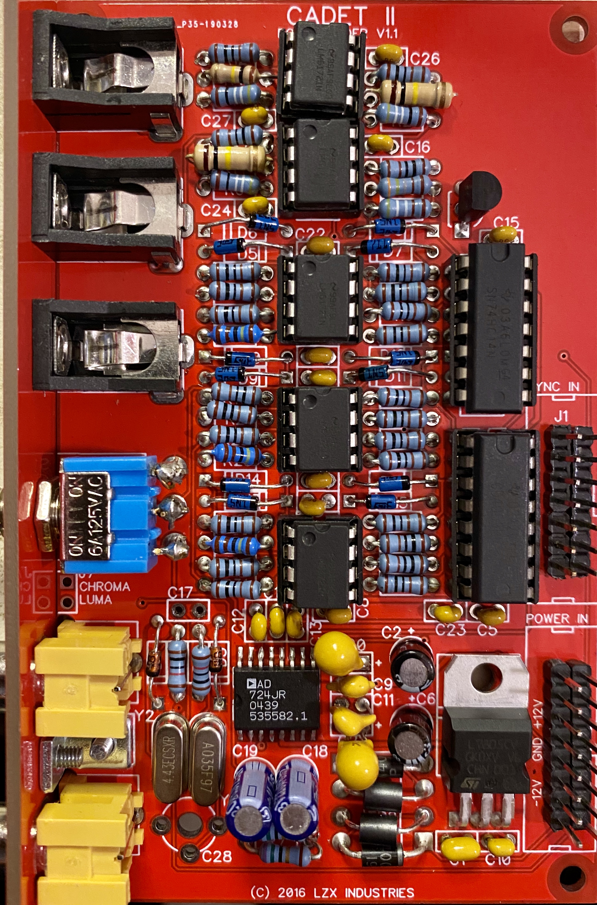

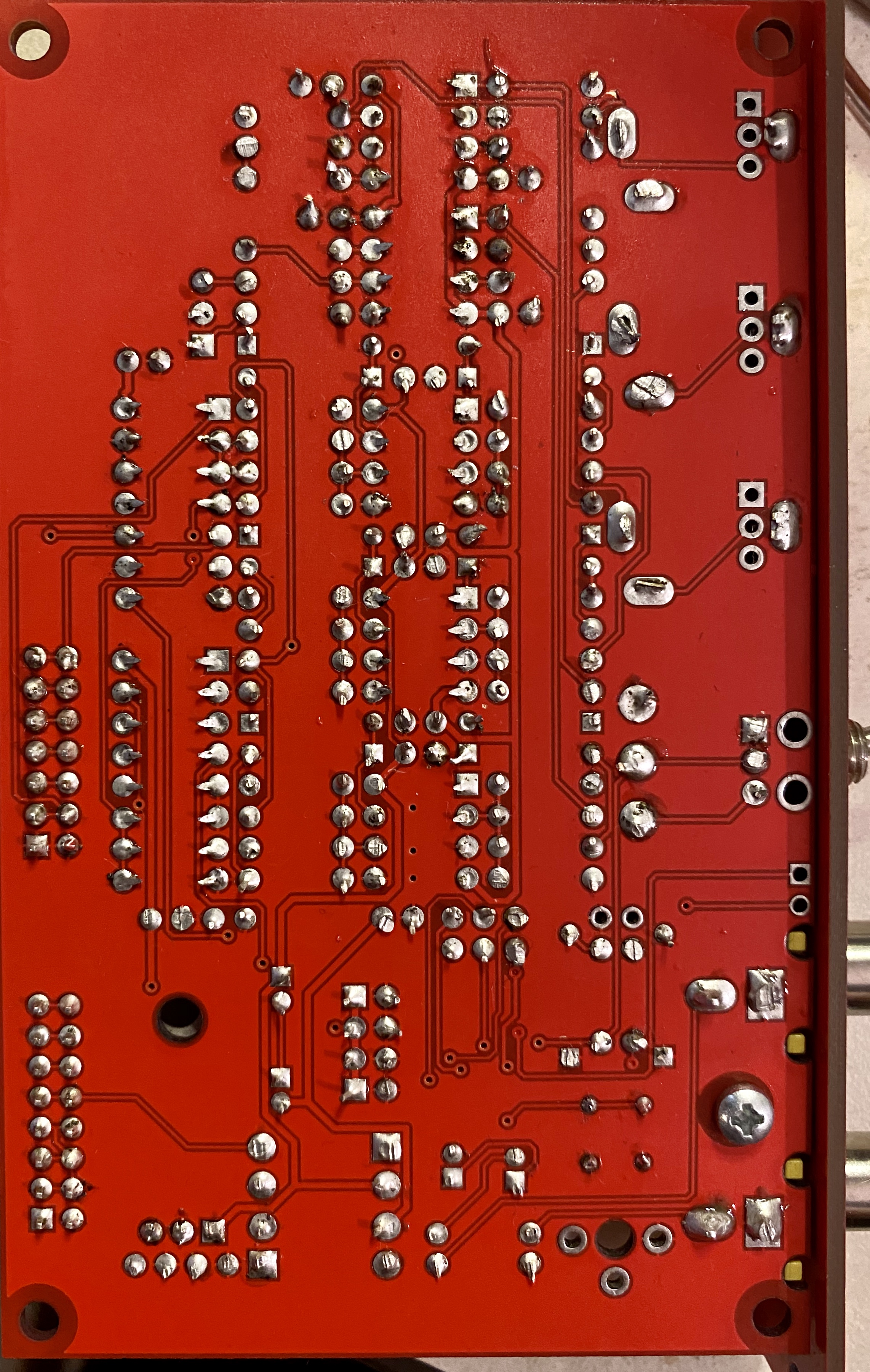

#3 — BittahWizard · 2020-08-17
Here are photos, keep in mind though it was working properly (to the best of my ability to tell anyway) for a few months. I added the voltage regulator in, after I realized it wasn’t there.
#4 — rempesm · 2020-08-17
Hmm, I wonder how the ICs that run on 5V, especially the AD724, were being powered to encode the composite signal.
Do you have a multimeter to check if you are getting +12V/-12V/+5V on the power pins of each of the chips? This is probably the best place to start debugging. If you look up the datasheets for each IC, it will tell you which pin to check but just be careful not to short pins when probing.
A good number of your solder joints could use reflowing, too. I’m not certain if some of those are cold joints because the surface was disturbed with how you trimmed the excess component leads. It is important to keep your component leads sticking out of the board short but you can potentially disturb a solder joint if you cut into them too much. You should aim for a smooth, volcano/Hershey’s Kiss shape on every joint.

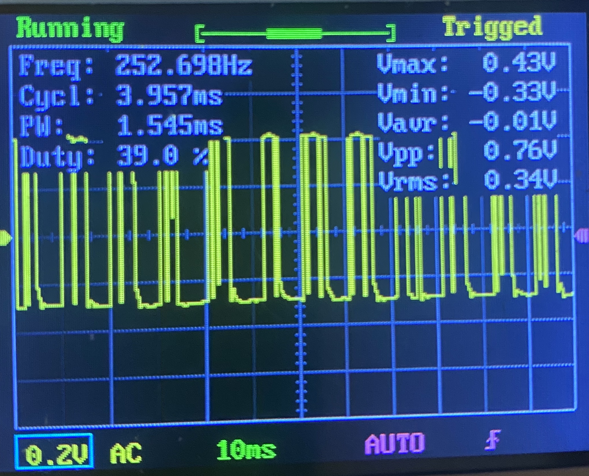

I checked the out put of the RGB Encoder on my scope and this is what I am seeing. Just got my scope so I am still learning how to use it, so I hope I measured this correctly.

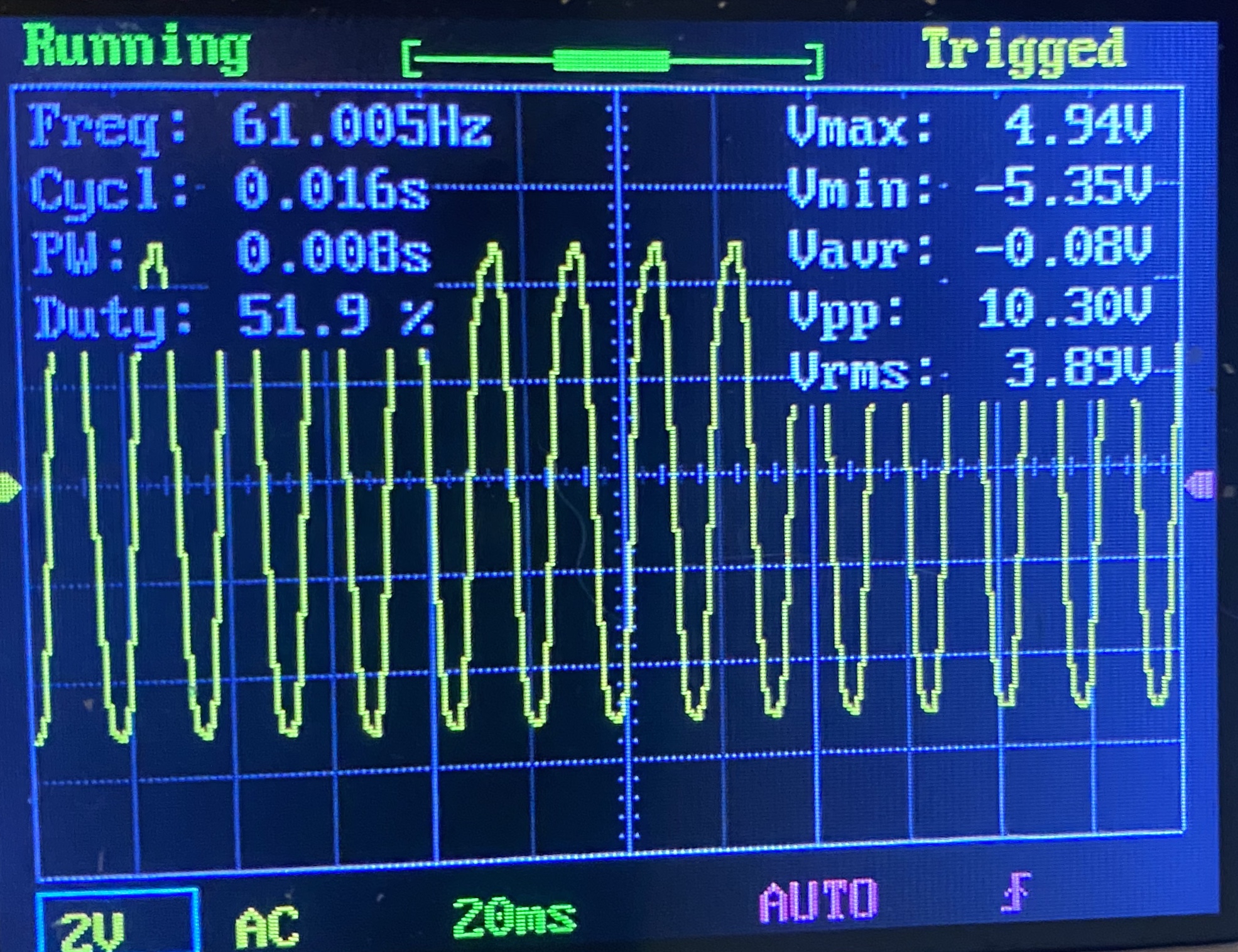

Here’s what I am getting on the oscilloscope:

Are you sure you have proper grounding for your probe? the 10Vpp AC signal certainly does not look right for video, but does not really look right for any plausible error mechanism either. it does however look quite right for a floating probe/ground hum.
If you’ve swapped the analog switch and inverters, my gut feeling is that either it’s the AD724 (i.e. extremely hard to fix), or the fault was unrelated to the 5V issue.

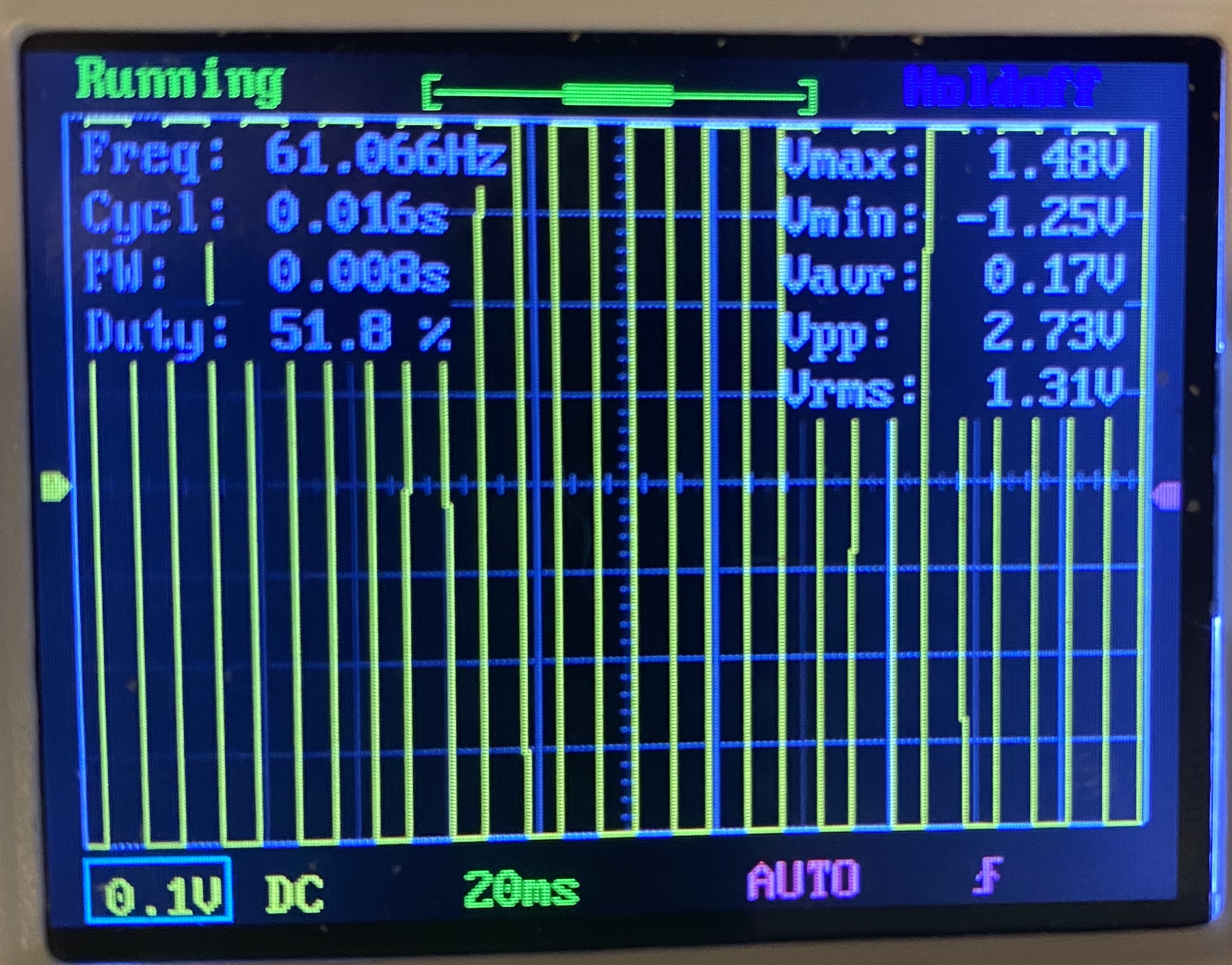

I do have a square wave coming from C14:
My gut feeling is the AD724 is shot too.

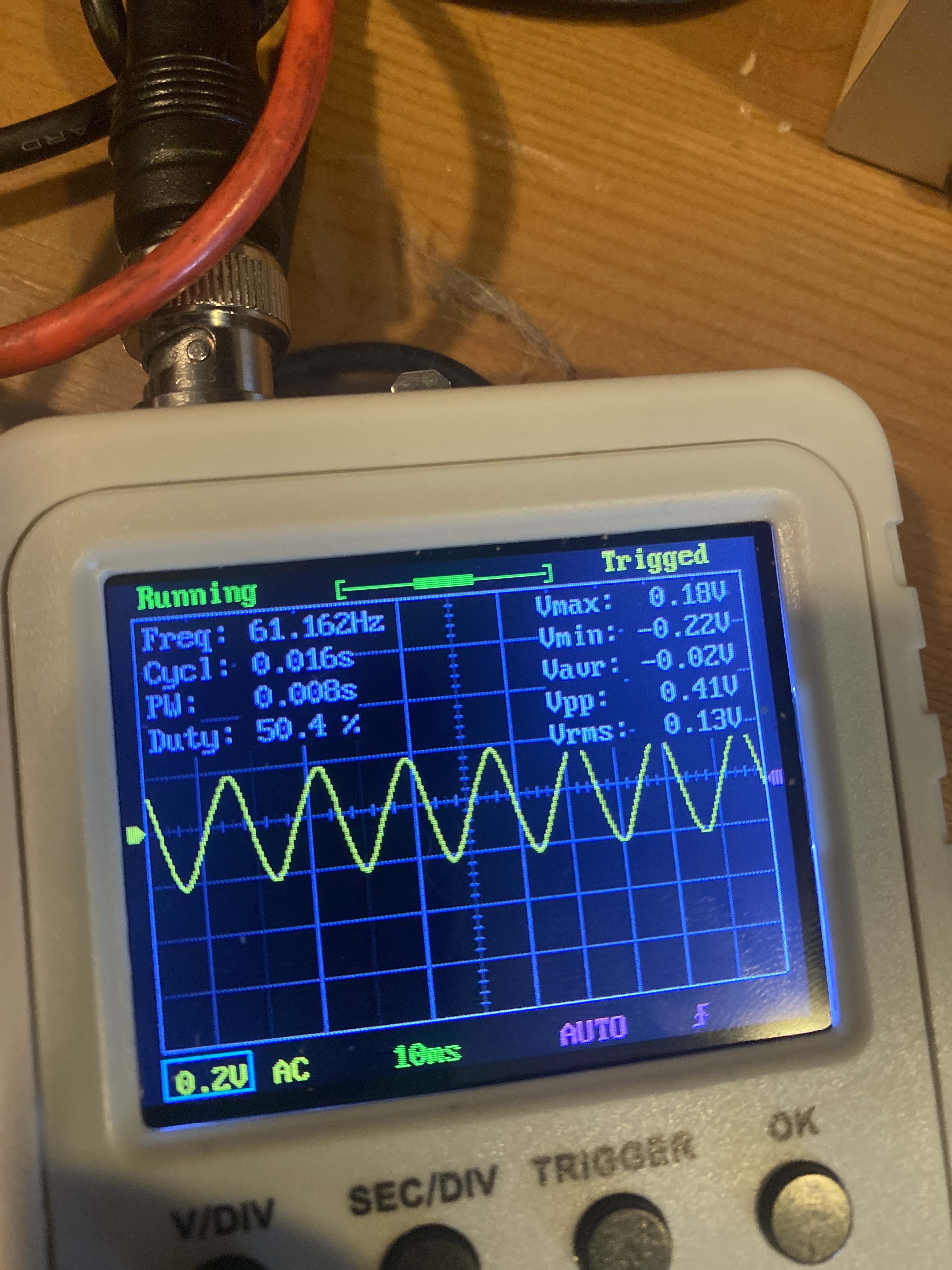

The output of J7 looks like a sine wave:
