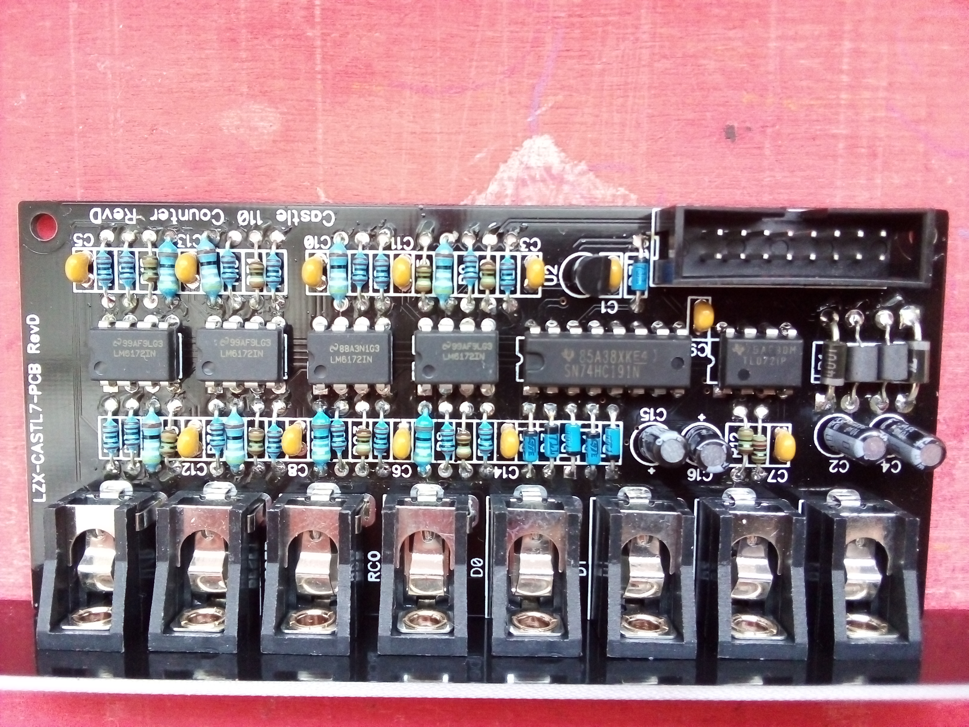

Hello, I’ve finished building a Castle 110 Counter (LZX-CASTL7-PCB RevD) but on powering it up, my whole system wouldn’t switch on until I plugged it out
:ok_man:t2:
I’ve given it a thorough look over: no ICs, diodes, or polarised caps in the wrong way but amazingly, I can’t see the trace for the C2 cap that can be clearly seen on a couple of the other Castle PCBs I have here. (Update: its on the bottom :man_facepalming:t2:
I’m an total noob at circuit diagnosis)
I’ll take a couple of photos, any help would be greatly appreciated. I’ve got a basic multimeter and a slightly wonky oscilloscope but I’m a total novice with them.
I’ll tag a few of you techie regulars on here & untag you if you consider this unnecessary or a nuisance. Apologies in advance. Also thanks for any tips or help offer :+1:t3:
@reverselandfill@transistorcat@Fox@VanTa@VisibleSignals@syntonie

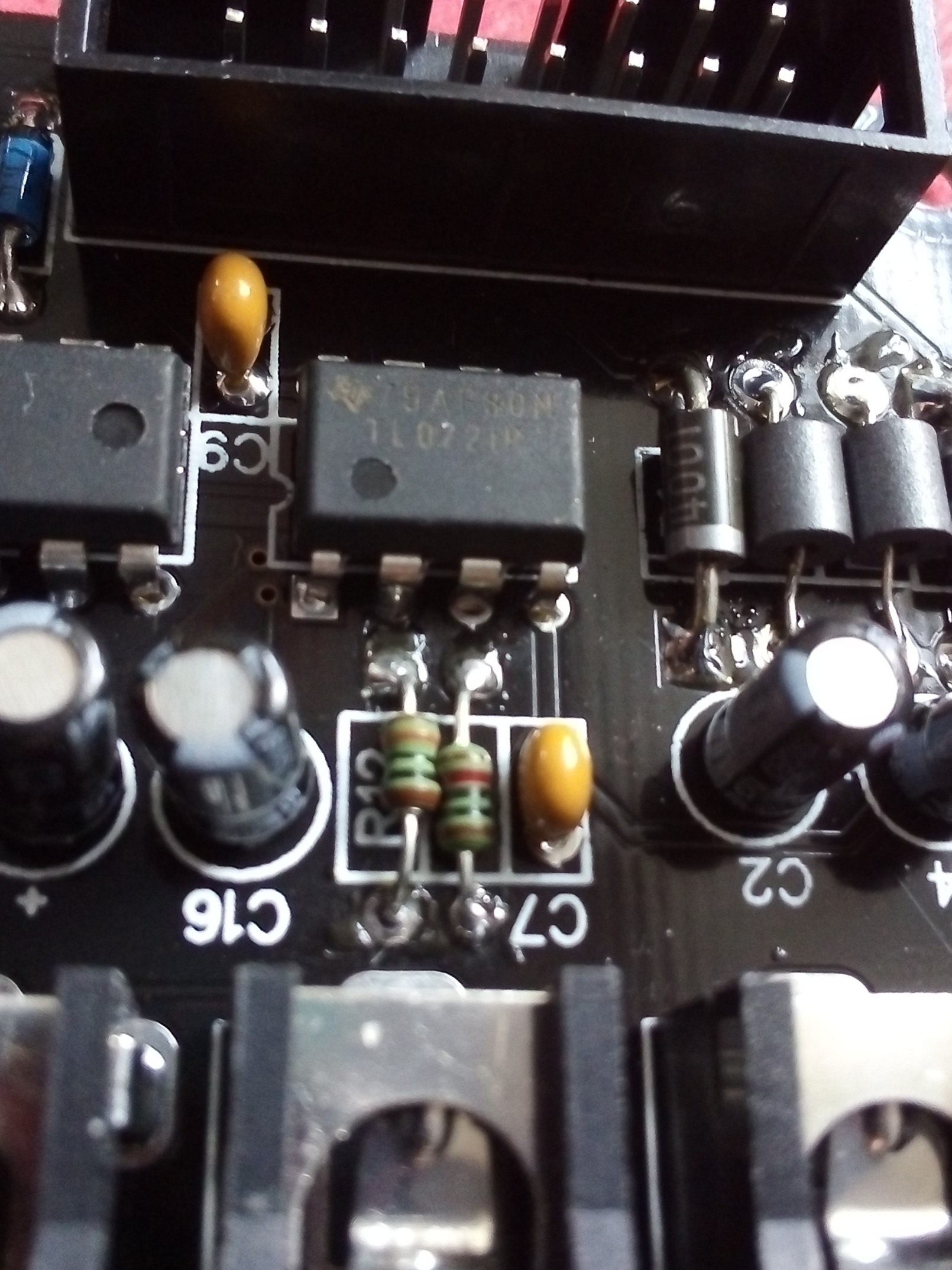

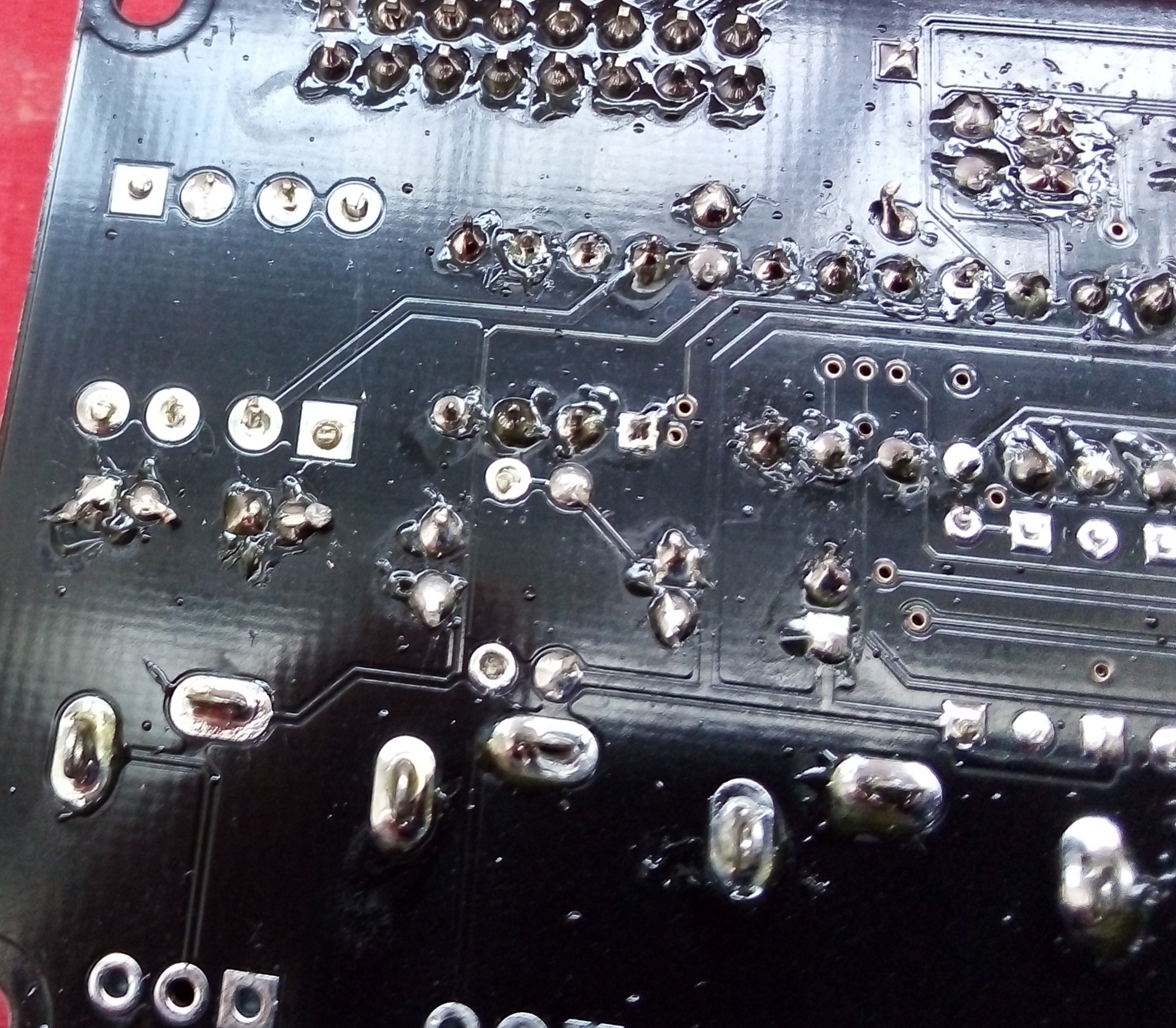

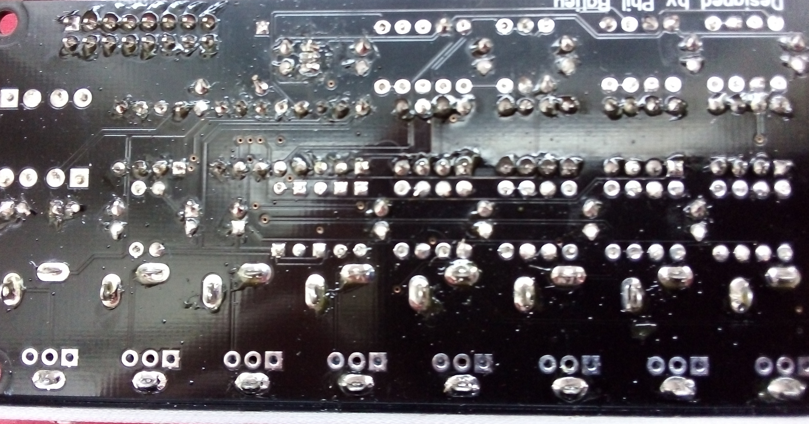

Here’s the back of the pcb.
IMG_20201017_155208
#4 — Robbertunist · 2020-10-17
Here’s a closer up of the C2 cap from behind.
IMG_20201017_155132
& another photo from the front but surely my thought of the C2 cap not being connected is nonsense because there’s the trace on the back from the Ferrite Bead.
IMG_20201017_160134

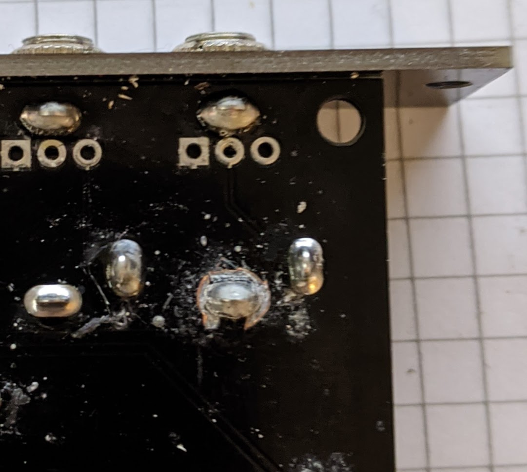

By any chance do you still have the castle module that gave you that trouble @transistorcat? If so, could you please take a photo when it suits you of where you made that cut, I’m really curious.
#16 — transistorcat · 2020-10-17
I realize now that this module could have benefited with a flux cleaning
:flushed:
Anyways, there turned out to be a short around the pad for one of the jacks - This got it working again. image
