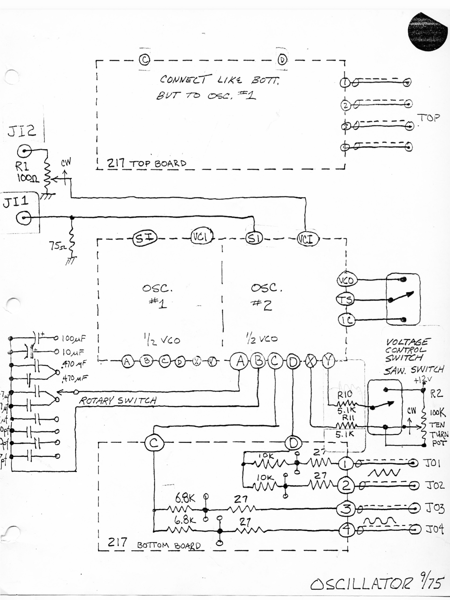

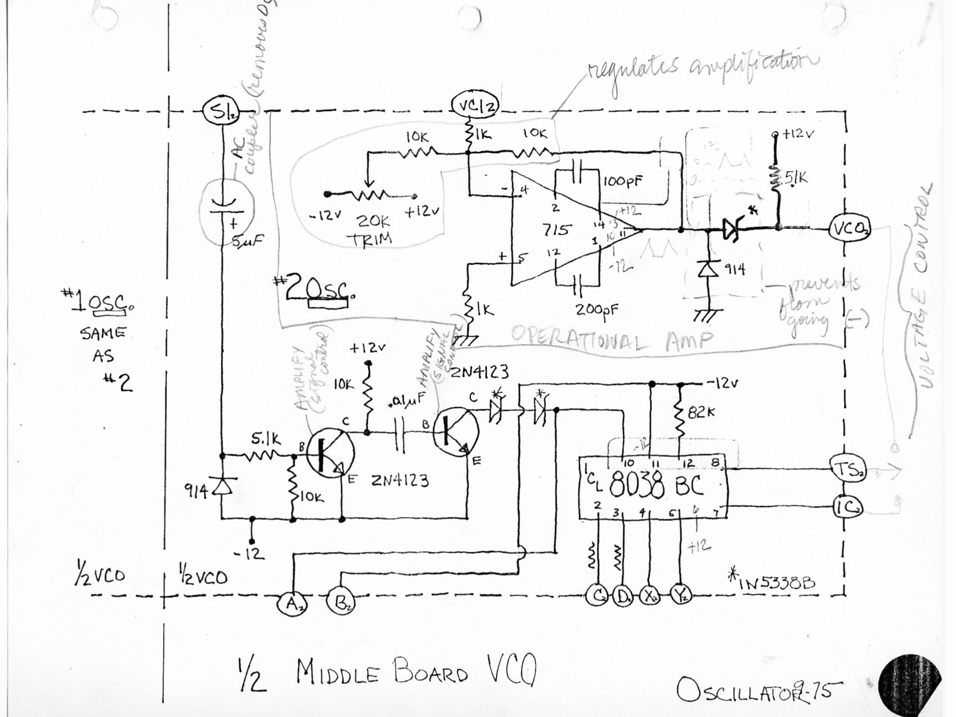

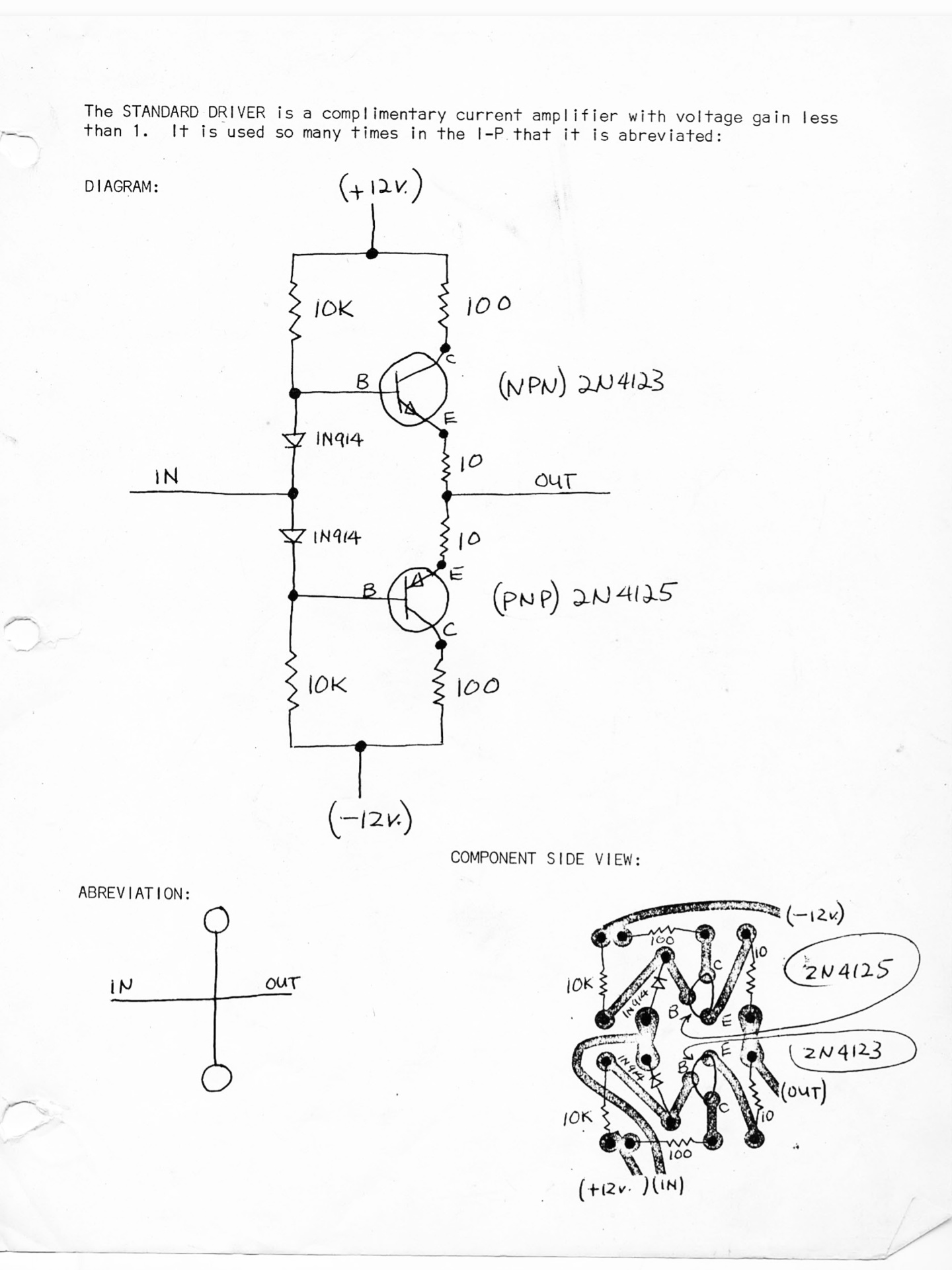

Check out the sandin Ip vco. This would be a decent starting point for a diy oscillator. There’s a lot of things that would need to be changed, such as the output would need to be scaled to 0-1v. I believe originally its +/-1v.

Wow, that uses an 8038!? Those things are unruly beasts!
#7 — pbalj · 2020-10-24
I don’t find the 8038 so bad. What have you found?

Tuning it to perform within an audible range was disastrous, at least for myself. I only attempted circuit examples in the datasheet but the outputs would swing from sub- to post-audible frequencies with the single turn of a relatively small pot. I wasn’t looking for video rate frequencies at the time, so maybe it is a lot more useful here. (and obviously it is, based on the legacy left by Sandin.

I tried to get an 8038 into the high hundreds kHz for nice tight vertical lines and found the waveform shapes were horrible and getting frequency stability was challenging. I only breadboarded it though; a prototype on a PCB might do better.
