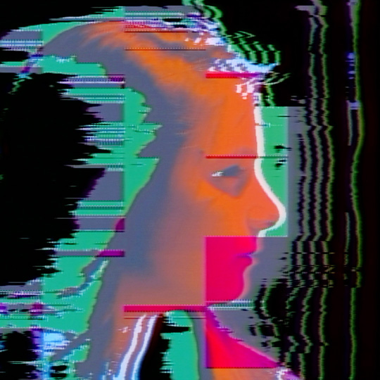

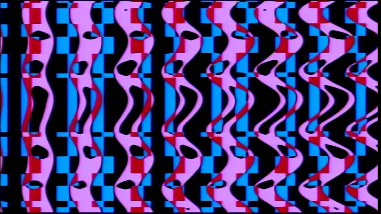

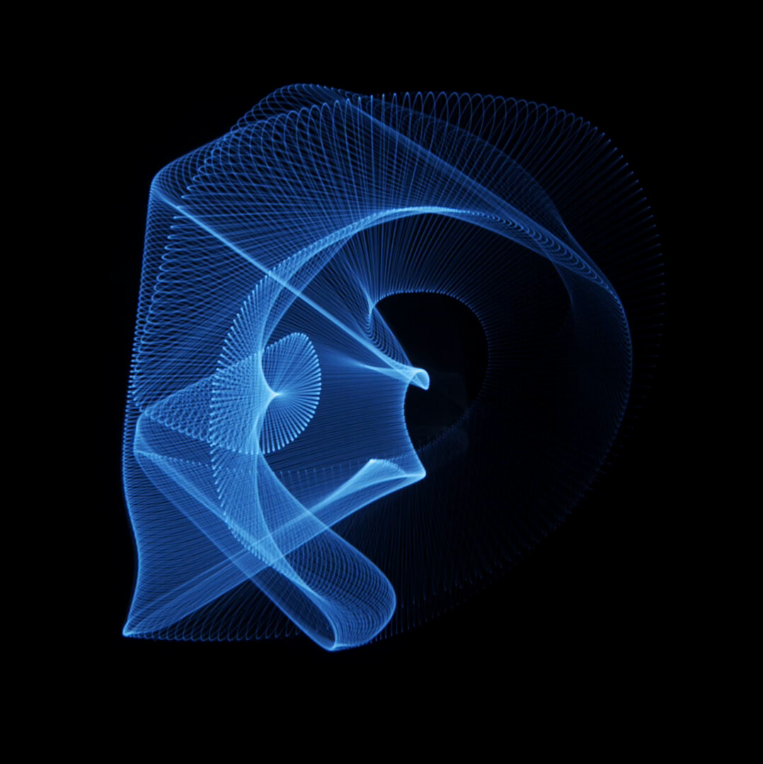

Some video synth possibilities:
- Pure synthesis, pattern-making, and so forth
- Vector synthesis, lissajous, Rutt-Etra, lasers
- Image processing/effects
Many workflows involve some combination of the above. Other possibilities are also, well, possible. But I’d say those are the main things.

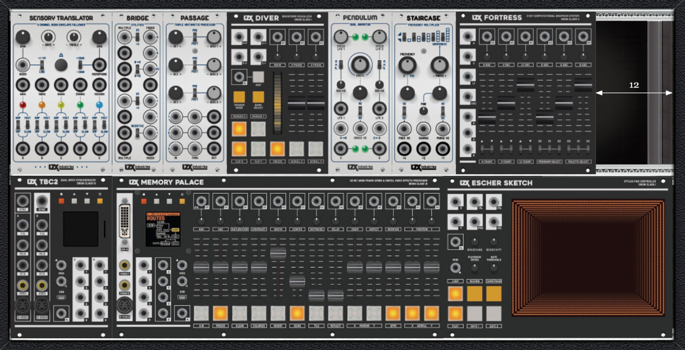

Another consideration: TBC2 + Memory Palace + Fortress + Diver + Escher Sketch. This is essentially a digital video synthesizer, but capable of wild pattern making and deep processing. There are some Fortresses and Escher Sketches available online now. Memory Palace and TBC2 will be in stock and ship this year, and Diver isn’t to far behind. In addition to this setup, you could add Sensory Translator for audio reactivity, then Bridge, Passage, Staircase, and Pendulum for essential analog utilities.
