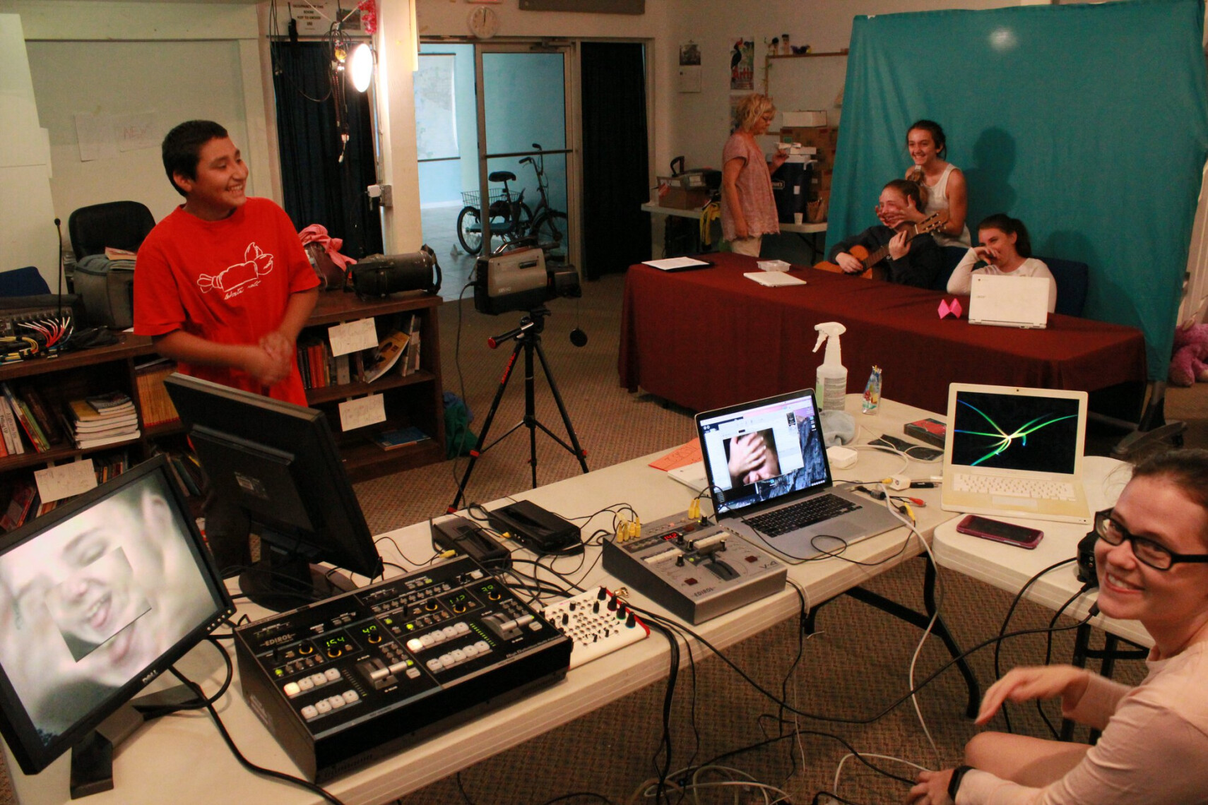

just for fun here is a picture of a tiny setup for a “news” day we had with our afterschool program a couple years ago. Less video synth and more mixer for this setup but it was still fun. You can see a vidiot nestled inbetween the v440 and v4.
