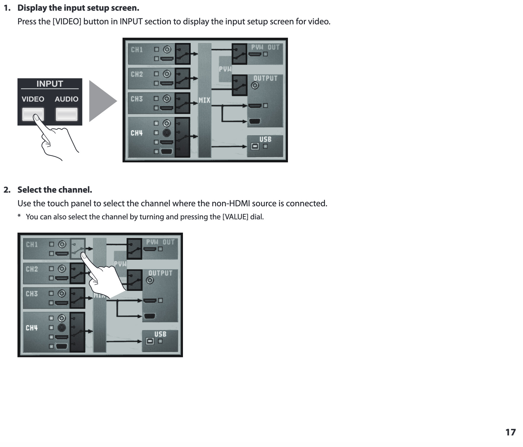

I just purchased a Roland v 4ex and realized the only input that my LZX Visual Cortex via a BlackMagic Shuttle works with is input 4 that has a scaler. Inputs 1-3 are for at 480p. Is there anyway to down scale from 720p or 720i to 480p so I have use the hdmi inputs?

I use a V4EX and do not have any problems using the Visual Cortex as an input into channels 1-3 with a standard RCA to BNC cable. From an initialized state this is the only menu option that needs to be addressed to confirm this configuration:
Screen Shot 2020-12-03 at 7.13.44 AM
I don’t use an intensity shuttle, so perhaps you can explore this signal path to identify whether or not its the V4EX or the shuttle causing issues.

Thanks for the tip! Works amazing!
