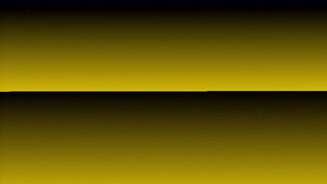

I have a Video Waveform Generator and I’m wondering what the cause is of these artifacts along the edges of the lines is. Is it a power supply issue?
https://www.youtube.com/watch?v=DTQUidejVisThe case is a Tiptop mantis, and it’s running only into the Visual Cortex in this patch. But the case has a few other LZX and BSO modules in it and powered on. The VWG is on the same power bus as the VC (to get sync).
Thanks in advance for suggestions on how to get a clean line with this module!

If you are referring to the inconsistent line that jitters at the end of the saw (or square) cycle… That’s analog, baby. Since the waveform is only synced at the beginning of the frame there is possibility for frequency jitter to manifest itself within the frame. An oscillator would need to be prefectly stable to mitigate such an artifact.
#4 — scavengers · 2020-12-19
@pbalj yep, that would be it! At least I think so. Well, I’m sort of relieved. Now I can just accept the analog glory and have fun.
