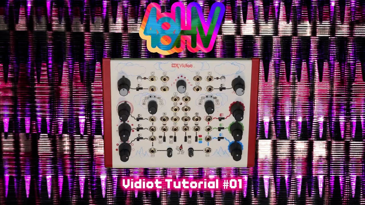

NOTE: this arrangement doesn’t produce significant feedback. One could feedback Video 1 output back into the G and/or B channels of VC2s channel A inputs to get some feedback going. The first patch that I gave definitely gets much more feedback. I think what we’re bumping up against is my lack of hands on experience with Vidiot and the lack of a dedicated Luma/Monitor output on VC. There is Luma out on the VC Input Decoder, but if I run that straight into a TV monitor there is nothing on the display. This makes sense as that Luma output is the LZX patching standard and pre Output Encoder … in other words, not a valid signal for a monitor to display. I’m basing my Vidiot setup/understanding on this video:
https://www.youtube.com/watch?v=nk888BzJVOMThere’s an older thread over on Muffs which may be of use to this conversation as well:

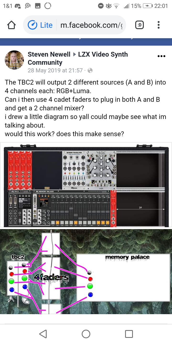

#8 — Robbertunist · 2020-12-26
I didn’t see much in the thread about cameras, it was mostly focused on mixing. Is this the right one you wanted to link to?
Screenshot_20201226-220118
#9 — 337is · 2020-12-26
Yup, that’s the one. No camera talk, but reckoned the mixing discussion might be useful.
