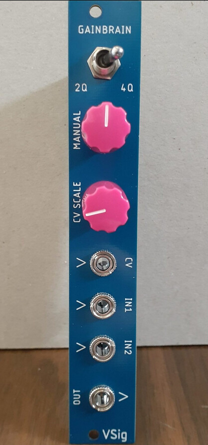

#3 — VisibleSignals · 2021-01-04
After a few people asked me about it I made a DIY 4HP design for a video VCA / crossfader / analog multipler (based on the circuit in the LT1251/LT1256 datasheet). The first batch sold out very quickly but I’ll have some more by mid January. Like all my boards they are fully LZX compatible. If you’d like one (or a 4-pack for a discounted price) they’re here: Gainbrain – Visible Signals

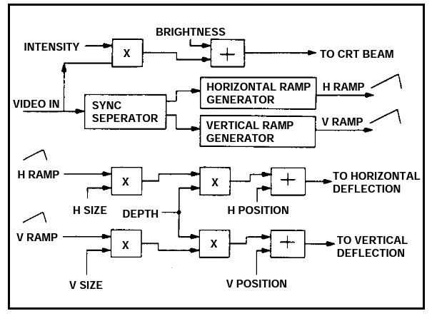

#8 — VisibleSignals · 2021-01-04
Maybe as per the Rutt-Etra diagram?

#10 — Rik_bS · 2021-01-04
Great suggestion by Aladan, quad multipliers normalised as per that diagram (2 pairs of 2) would be a great option for vector video!
The fifth multiplier in that Rutt-Etra patch doesnt appear to be critical
Such an arrangement would create differentiation in the market too, to make your module stand out

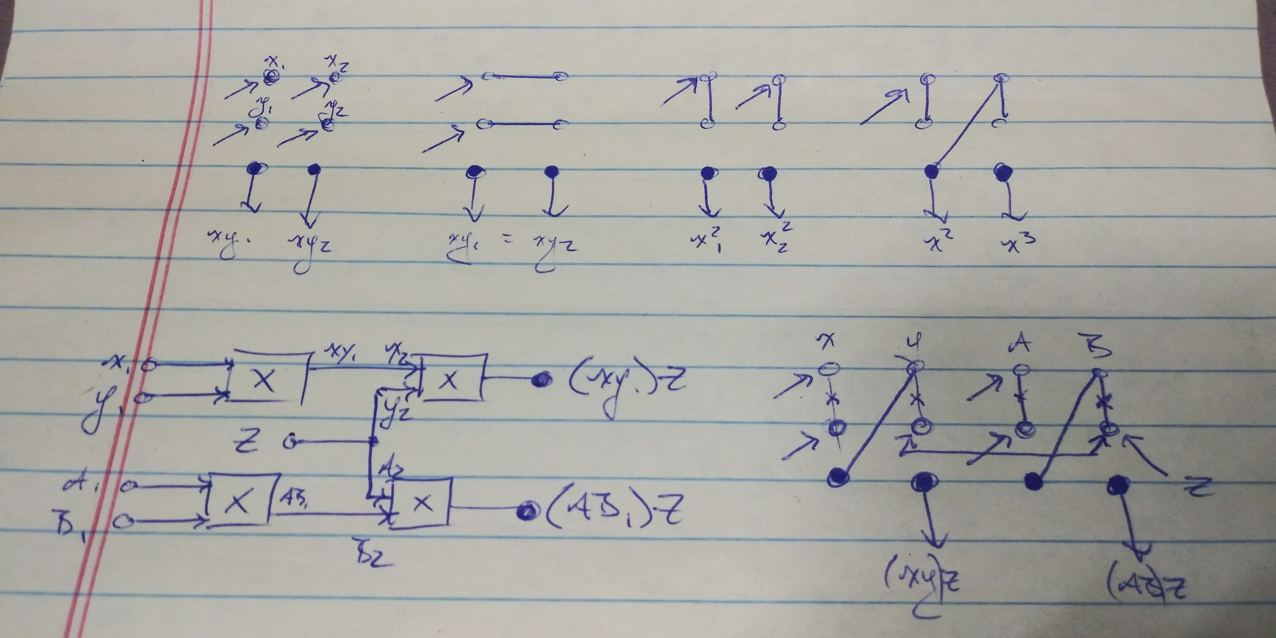

#11 — KludgeDredd · 2021-01-05
If you’ll forgive the low tech diagram and lack of mathematic rigor, the following is a little sketch of all thats been discussed. The top outlines what appears to me as the most relevant norm schemes for a dual multiplier, followed by the Rutt Etra computation block using 2 modules normed for x^3.
20210105_121807
The only caveot here is that the Rutt Etra block using two dual multiplier modules would require the use of an external mult or stacked cables for the shared input. Of course, this would appear to still be the case for a quad multiplier, unless the module is hard wired specifically for the application above.
Thoughts?
Edit: I now see that the xy/ab labeling along the top of the last diagram is incorrect. Disregard.

#14 — meudiademorte · 2021-01-05
Are their any Videos out there with gainbrain? Wondering whats the diffrence between a cadet fader and how the multiplieng function looks.
#15 — VisibleSignals · 2021-01-05
International mail is slow and I only sent out the first batch of boards a few weeks ago so I’m not sure if anyone has built one yet and done a video yet.
You could think of it like a combined Cadet fader and multiplier. Input 1 is wired to one side of the crossfader chip, but there’s a switch to also optionally connect it to the negative feedback path of the other side of the crossfader to effectively make that side of the fade an inverted version of Input 1 (cool trick from the LT1251 datasheet). That means the CV input fades between a positive and a negative version of Input 1. By adjusting the offset of the CV via a knob on the panel to centre the crossfade position when CV=0V you effectively end up with a four quadrant multiplier.
I wrote a note about the multiplier function in the build manual: The LT1256 works approximately linearly from 0% to 100% VC input, which is preferable for voltage multiplier tasks (use the IN1 and CV inputs for this). The LT1251 has a ‘snap to zero’ function as it approaches 0% and 100%, which introduces a small error when used for linear multiplication. However, that ‘snap to zero’ function in the LT1251 makes it perfect for VCA (CV input sets the gain of IN1, or the inverse gain of IN2) and crossfading duties (CV controls crossfade from IN1 to IN2) since a slightly non-zero CV signal input won’t result in a ‘ghosted’ IN1 or IN2 signal source leaking through to the output.

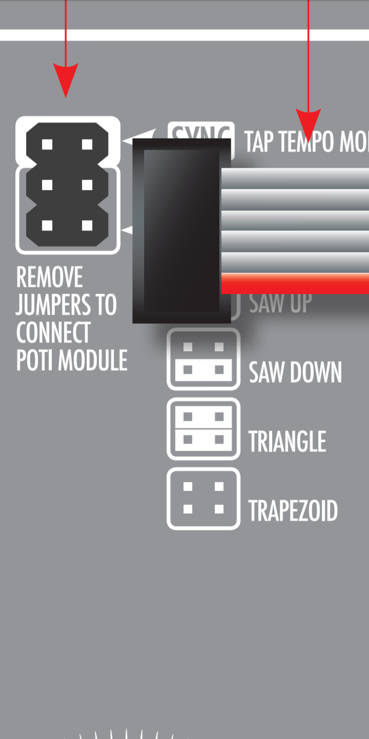

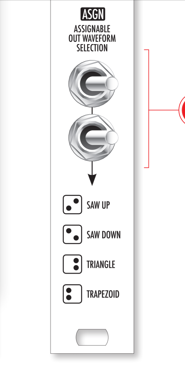

#18 — Robbertunist · 2021-01-06
KludgeDredd wrote:
Inputs 1 to 2: X2=X1, Y2=Y1?>>>> Output1 to Input2: X2 = XY1?>>>> Cubed: Y1 = X1, X2 = XY1, Y2=X2?>>>> etc…
KludgeDredd wrote:
Personally, I find myself settling towards an 8hp Dual 4Q with some variable gain on the inputs
Recently I’ve seen an XAOC module, the Poti expander, that has a simple yet ingenious two switch (2x SPDT ON-ON I’d guess) configuration for selecting one of four options. If this could be implemented so that all 3 of the normaled possibilities were easily selectable from the front panel instead of jumpers on the PCB, this would be really helpfully for a dual 8HP module I think.
The Screenshots are from the pdf manual found on the product page below.
