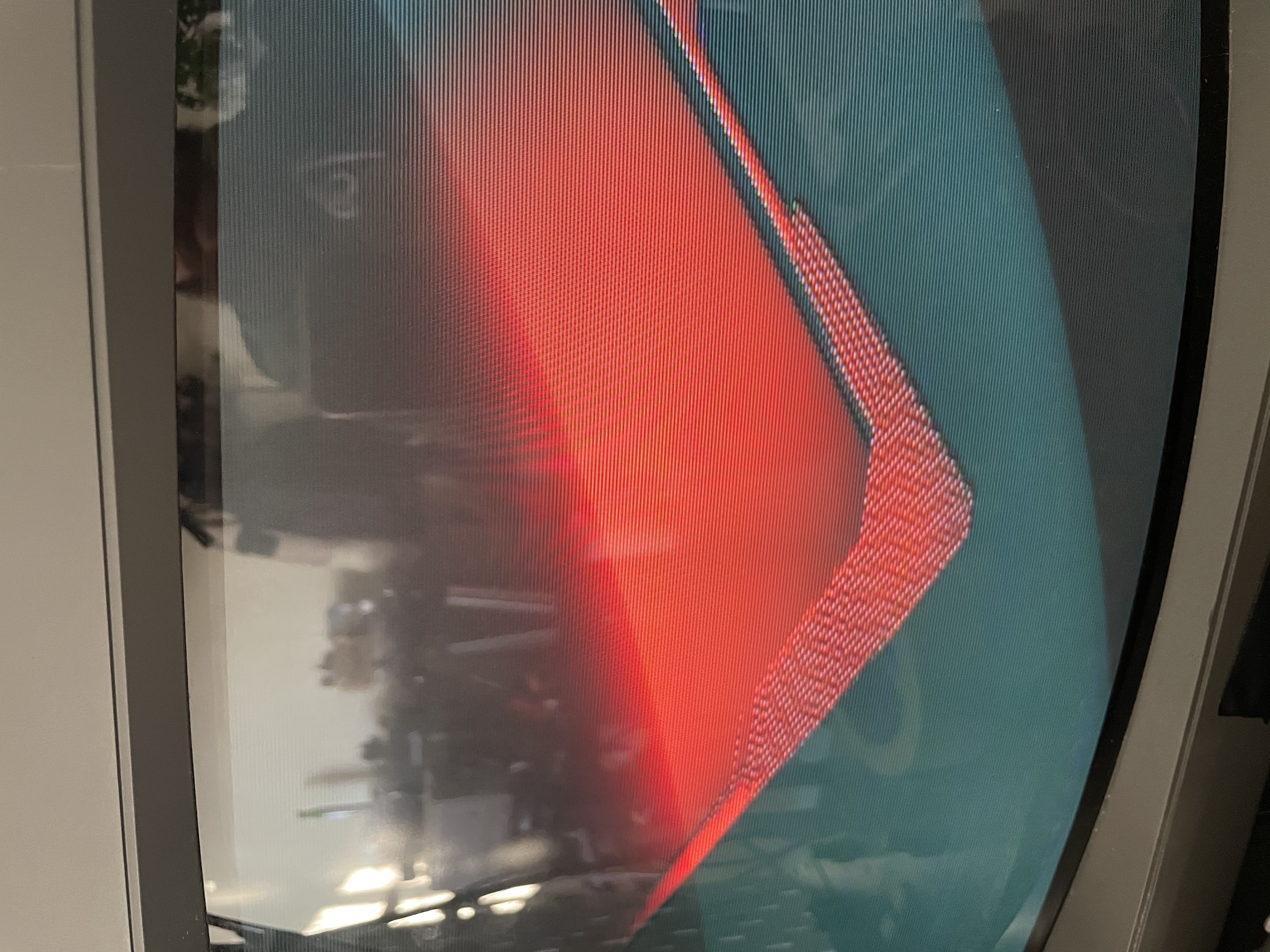

I’ve just picked up a 2nd hand Shapechanger and after patching in Cortex (VC H Ramp to SC H Ramp in, VC V Ramp to SC V Ramp in, SC H Ramp out to VC Red in and SC H Out to VC Green in)…
I’m getting some weird distortion to the image that seems to disappear only when shapechangers Size knob is dialled above 50%. Is this normal? Should I be concerned of a fault? (See image, red dip/triangle shaped distortion)
VC and SC are power isolated so no other modules intruding
#2 — Z0NK0UT · 2021-01-07
It’s a little hard to tell what’s going on from the image. Could you post a video?
