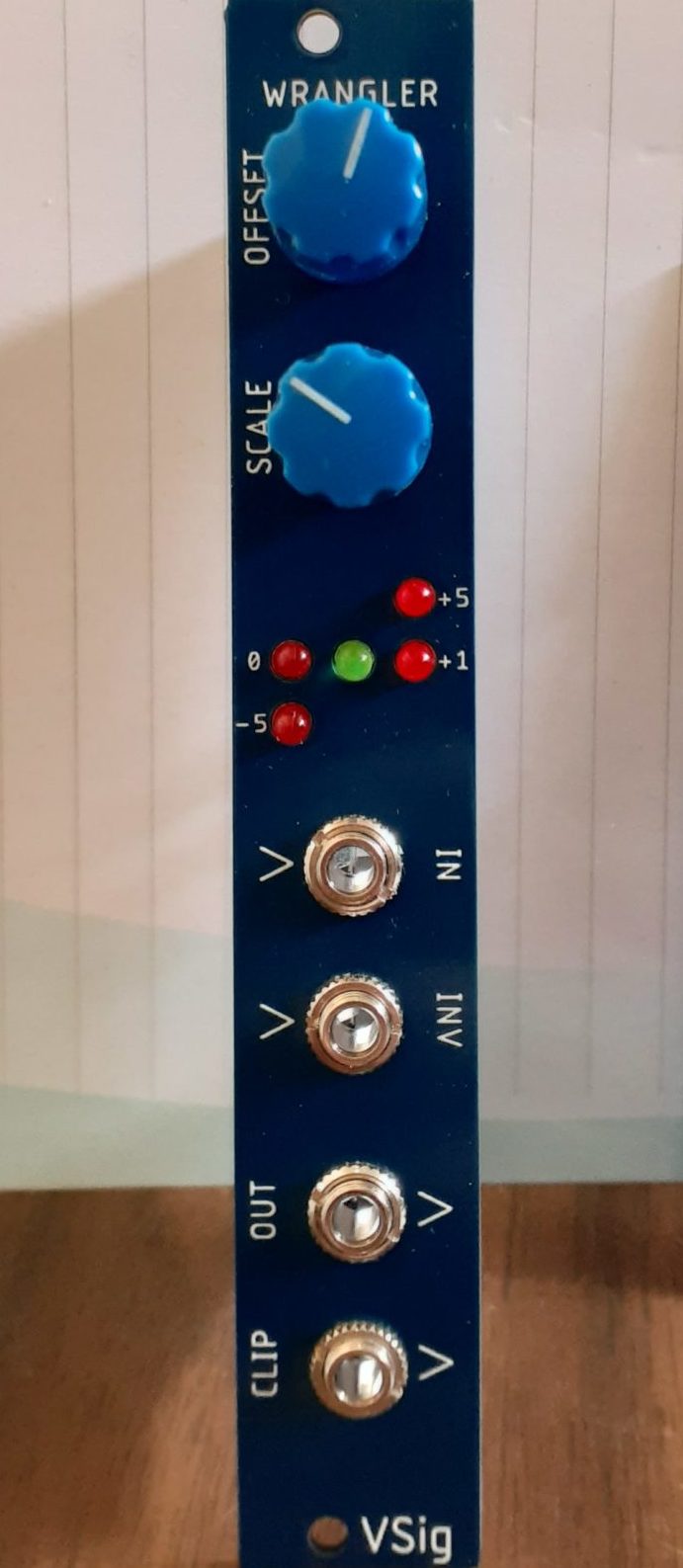

The #Wrangler from @VisibleSignals’s recently launched Visible Signals biz in Australia has to be considered to. I’m building one atm, if you’re in Europe I can mail it to you for a home demo session, at your expense of course
