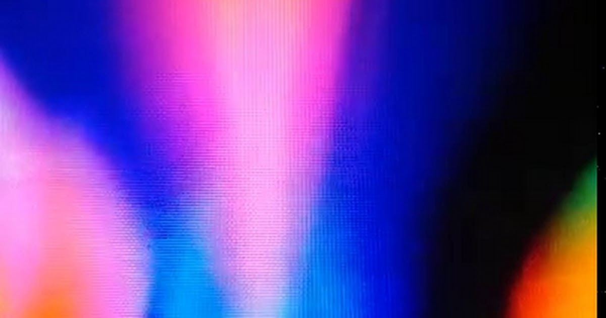

I seem to be getting scrolling horizontal lines with my LZX setup, which just consists of the Visual Cortex and Memory Palace. I can’t tell where the interference is coming from— is it the component inputs on the Memory Palace, something happening with the sync between the two, etc?
I was hoping maybe someone here has seen this before and knows what the issue is.

Likely culprit is power. What is your power supply?
#3 — bleunuitvideo · 2021-01-10
TipTop Happy Ending rack.
1 x µzeus 4hp psu with 2 x flying bus boards
1 x 15v DC 1000ma Triad external power adapter (for 110v only)
#4 — rempesm · 2021-01-10
I’ve used uZeus before and it gives really unsatisfactory results for video synthesis, unfortunately. Their Studio Bus solution works pretty well.

Hey y’all, just want you to know that I solved this problem!
The uZeus supports two ribbons, I had a second ribbon plugged into the uZeus with nothing else attached to said ribbon. I removed it, no more distortion.
