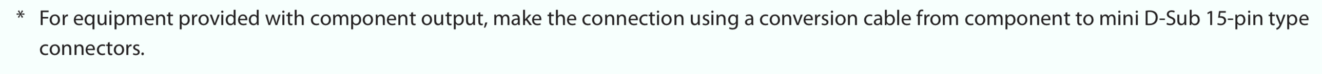

Thanks for the ideas, the V4ex manual states
Screen Shot 2021-01-14 at 12.08.38 PM
So I am assuming this 15 pin vga to component cable I ordered from Monoprice is correct. @Genlok also confirmed this is likely the correct cable, has had success connecting to v4ex with a similar cable, and thought maybe I had a bad cable the first time. He also suggested setting input 4 settings to 480i instead of auto.
Cable shipped yesterday, so I’ll report back once it arrives and I do some testing.
