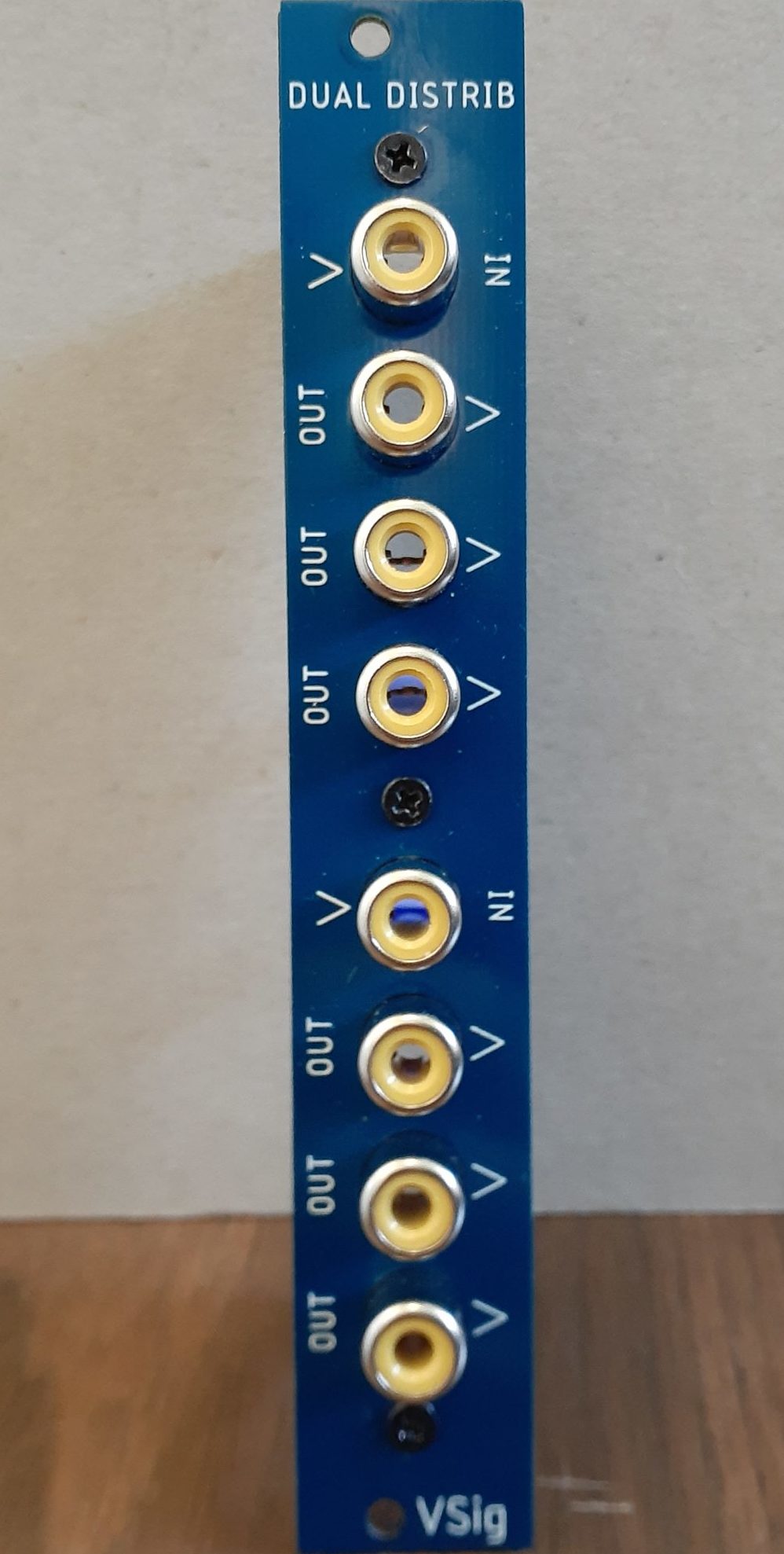

I’ve got a nearly complete complete Visible Signals (VSig) Video Distributor here in Berlin on workbench. They final components arrived yesterday so I’ll be able to finish it when I get home in about 4 or 5 hours. I’ll take some photos later.
I’ve recently sold stuff to a LZX user in the UK (via the Facebook group page), postage took about a week, no issues with customs thankfully :+1:t3:
Please write to me on here if this sounds promising to you :grinning:
And here’s a link to the Video Distributor module by Visible Signals:
visiblesignals.net
https://www.visiblesignals.net/product/dual-distrib/Link: Dual Distrib – Visible Signals
