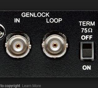

#4 — creatorlars · 2018-08-16
Both jacks are connected to the same node, either can be input or output (patch them in the order that makes sense for your cable routing.) It is essentially the same as what you see on broadcast gear, with in/loopthru and terminate switch:
Capture
