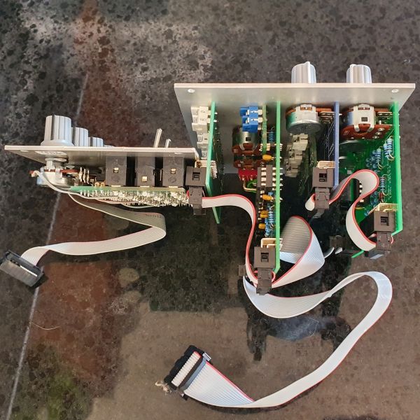

Just had a couple of modules arrive, for my video case being built in 2x Rackbrute 6U…
sure, the Rackbrute can fit the Cadets, but I wasn’t expecting this!
20210224_172126
it’s an Elby ChaQuo, 85mm deep
:dizzy_face:
following the above advice, I jumped straight on to ebay and bought 10x M3 Standoff 15mm. It’ll be ugly, but it’ll work. Will share pics when it’s fitted.

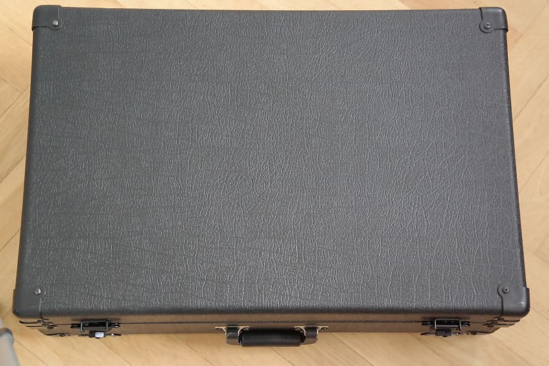

reverb.com
https://reverb.com/item/39602172-monorocket-m9m-high-current-high-power-case-2015-blackPlease email me for more pictures. The Mission 9M is specifically designed for Metasonix modules, and particularly the new R-55 oscillator module which, on its own, draws enough current to shut down any other eurorack power supply on the planet. This...
Link: Monorocket M9M High Current / High Power case 2015? Black | Re: Music Synths...
One could always buy my Monorocket High Current case and never worry about space or power again!

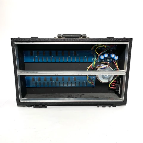

Monorocket’s switchmode power supplies are unlikely to be great with LZX modules, be careful.
#18 — Kent · 2021-04-10
I’ve never heard of a case of this. However, I’m new to the video synth game. Do you have links to this issue? I’d hate to sell something to somebody and have them come away less than pleased.
#19 — jnoble · 2021-04-10
Power supplies that are really good for music modulars, like the excellent Intellijel powered bus boards, have too much high frequency hash on the rails–which shows up as visible fuzz/lines/bands in video synths’ outputs.
General purpose switchmode supplies like the ones in the Monorocket cases should be approached very carefully by video synth users: test first, if possible.

Early Monorockets had linear supplies, yes, like this one:
monorocket
But Kent is talking about a switchmode version, which I would approach with caution for video use.
