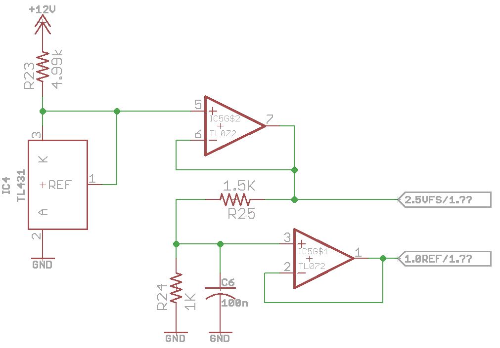

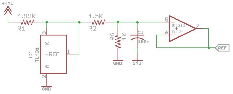

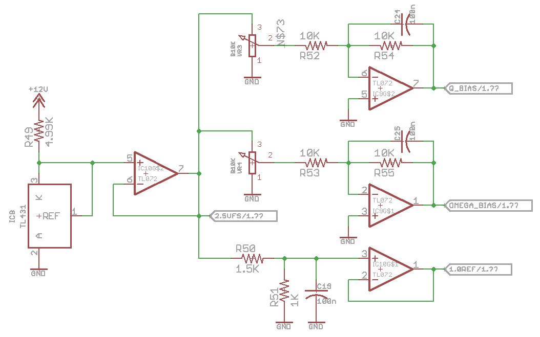

#4 — Fox · 2021-03-04
For some of my designs, I need several references like 2.5V, -2.5V and 1.0V. As long as you buffer the source from large resistive and capacitive loads, you can divide it how you like. The unity gain buffer will fight tooth and nail to ensure It’s output matches the +input regardless of what you connect afterward.
Here are a few examples. I added a few capacitors arbitrability for filtering.
Examples
1vreference
2.5and1vref
manyrefs
There are of course alternate voltage refences and other low-noise op amps available; these are simply tried-and-true.

#7 — phosphenes · 2021-03-05
I’d put the buffer after the 1V reference, in theory no current flows into the op amp so you don’t need to worry about the reference being a suitable current source, just ensure the op amp can push enough current for your requirements
#8 — VanTa · 2021-03-05
Perfect!
Thanks a lot.
The second example is exactly what I needed, I had half a tl072 unused and looking sad in my design.
