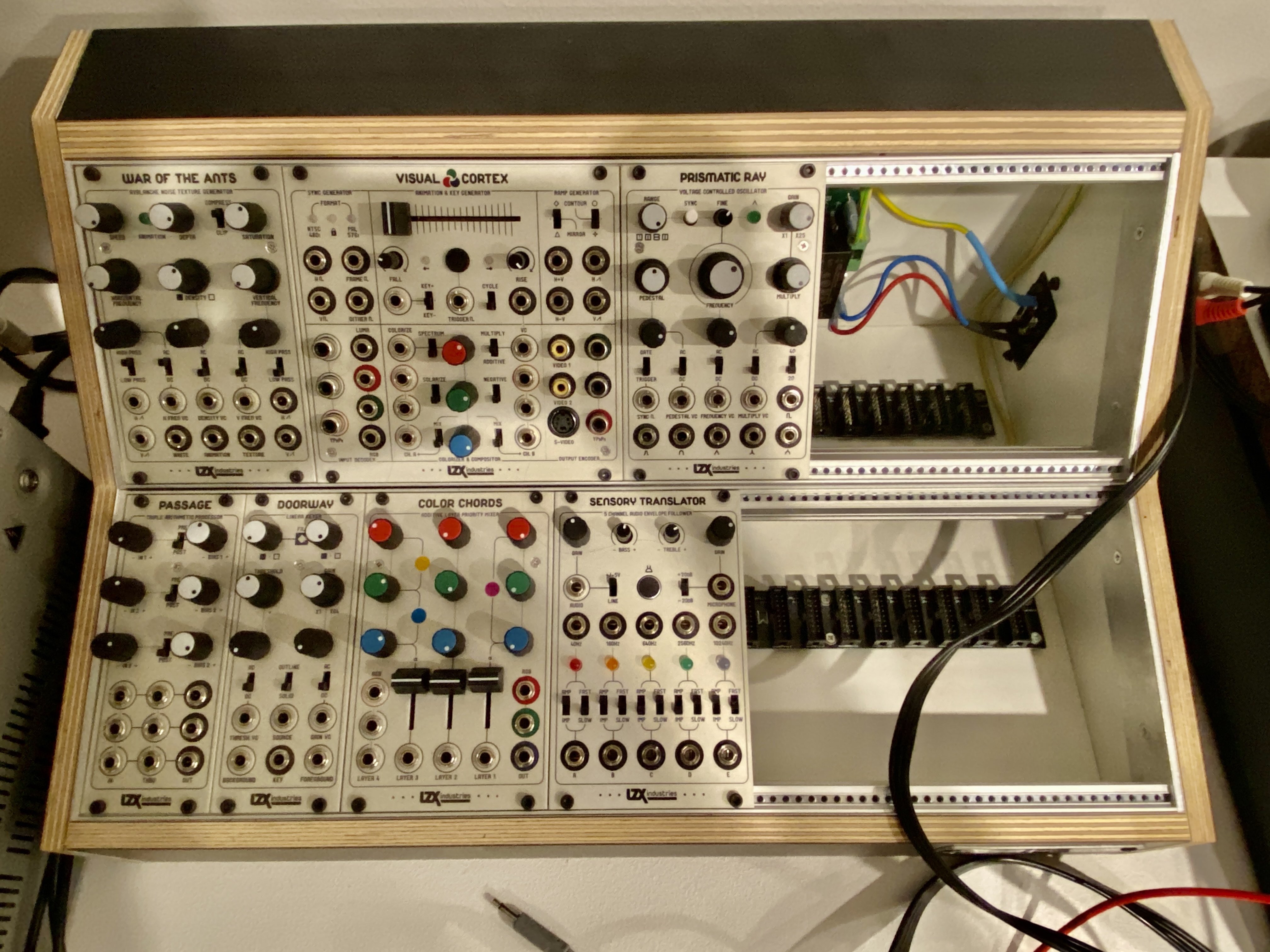

I recently acquired this setup and have just started my video endeavors with LZX. Any thoughts on with where I am at right now?
- Visual Cortex
- War of the Ants
- Prismatic Ray
- Passage
- Doorway
- Color Chords
- Sensory Translator
Would Staircase be an essential addition?

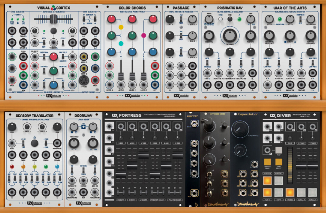

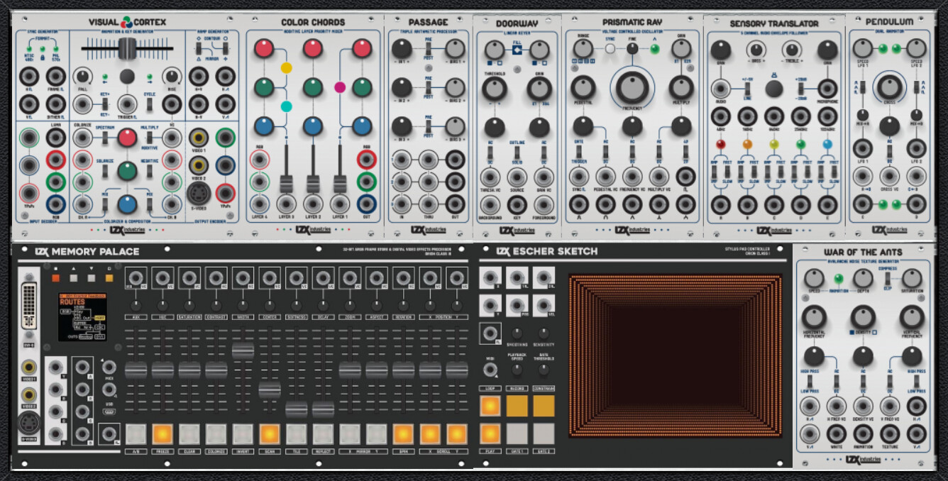

If you have 208HP total, you might consider something like this. You could sub Staircase for Pendulum, of course.

I would totally recommend Diver.
Together with sensory translator and Memory Palace is a killer combo.

Thanks for all the responses! Right now everything is housed in a 6U 84/114 HP powered case with Doepfer PSU-3 power supply, so I have a bit of extra space. I own no other Eurorack gear, but I do have this chained with an Edirol V-4 and some circuit-bent processors. Seems like I am lacking modulation
at the moment.

Pendulum or any LFOs that can be natively scaled to 0-1V would be useful. There’s far more than this available, especially if you don’t mind using rack space to attenuate or scale voltages, but a few ideas:
BSO Bajascillator
ALM Pamela’s New Workout
Ornament and Crime
Xaoc Devices Zadar
