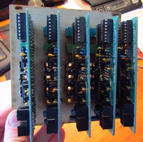

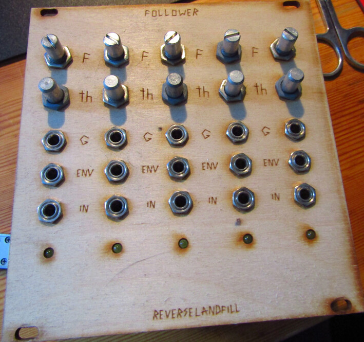

And for DIY: I did a project with the 5x Harry Bissel design by Miscreant env. follower in one panel and then I use a 10 band Equalizer (Serge Resonant EQ mk2) to isolate the frequncy inputs, to emulate the sensory translator
front
back

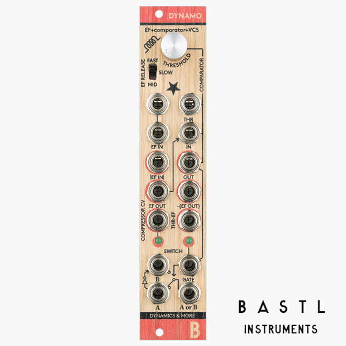

Thonk has some Envelope follower stuff / modules that can be used as such function:
thonk.co.uk
https://www.thonk.co.uk/shop/bastl-dynamo-wood/Link: BASTL Dynamo – Full DIY Kit – Thonk – DIY Synthesizer Kits & Components

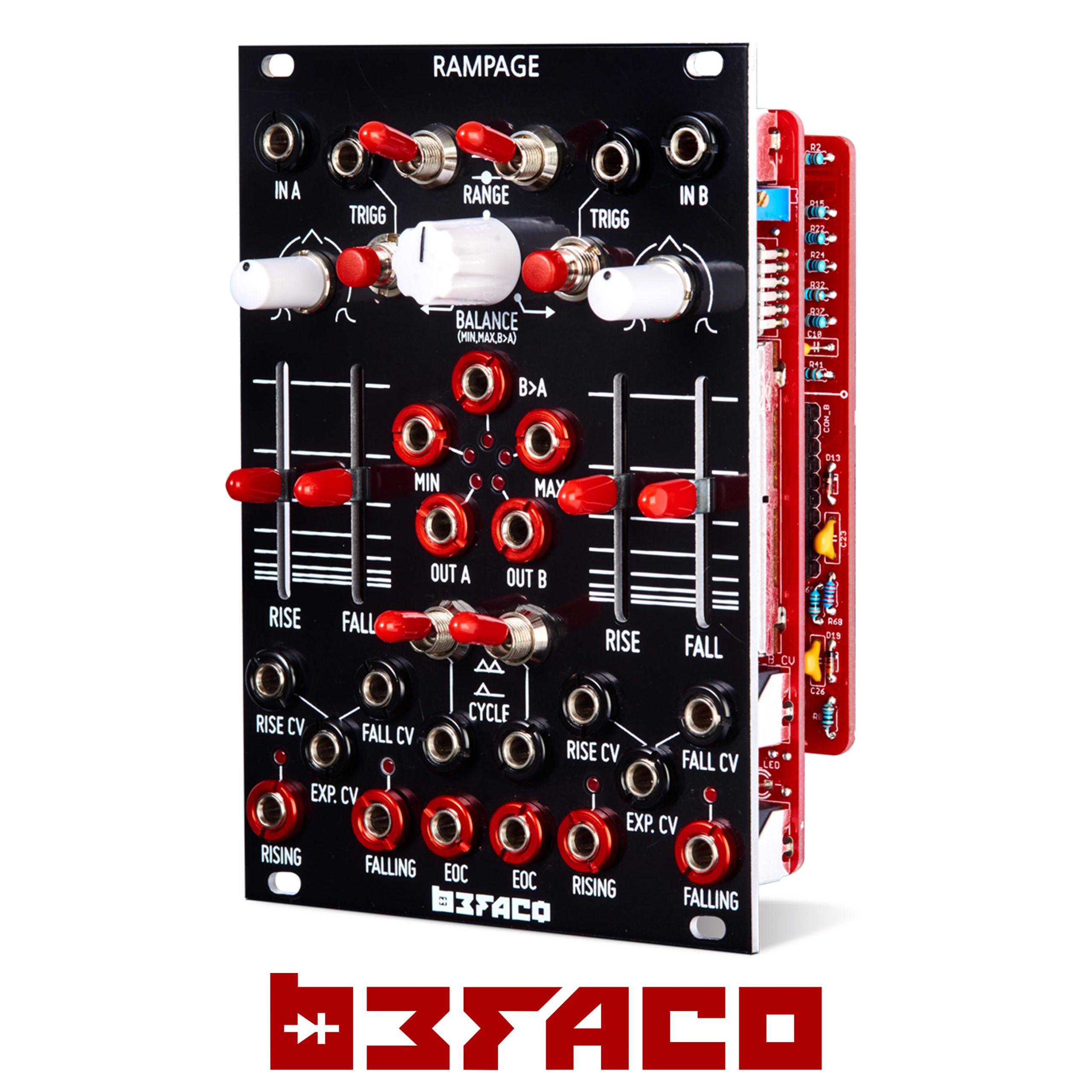

I have the Vidiot but have also use the Make Noise Maths which can act as an envelope follower. I believe Befaco’s DIY Rampage module is almost a clone and can do the same.
There must be cheaper options out there for a dedicated follower but I would vouch for a complex function module’s many applications in video synthesis. For example, the ability to adjust the slew rate for the up and down ramps individually can really help smooth out and shape the animation of abrupt percussion voices.

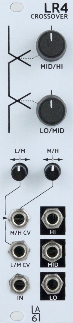

3-band crossover here - pair with one (or three) envelope followers and you’re good to go.
ModularGrid
https://www.modulargrid.net/e/la-67-lr4-crossoverLA 67 LR4 Crossover - Eurorack Module - Voltage controlled 3-way crossover with 24/db filter slopes.
Link: LA 67 LR4 Crossover
