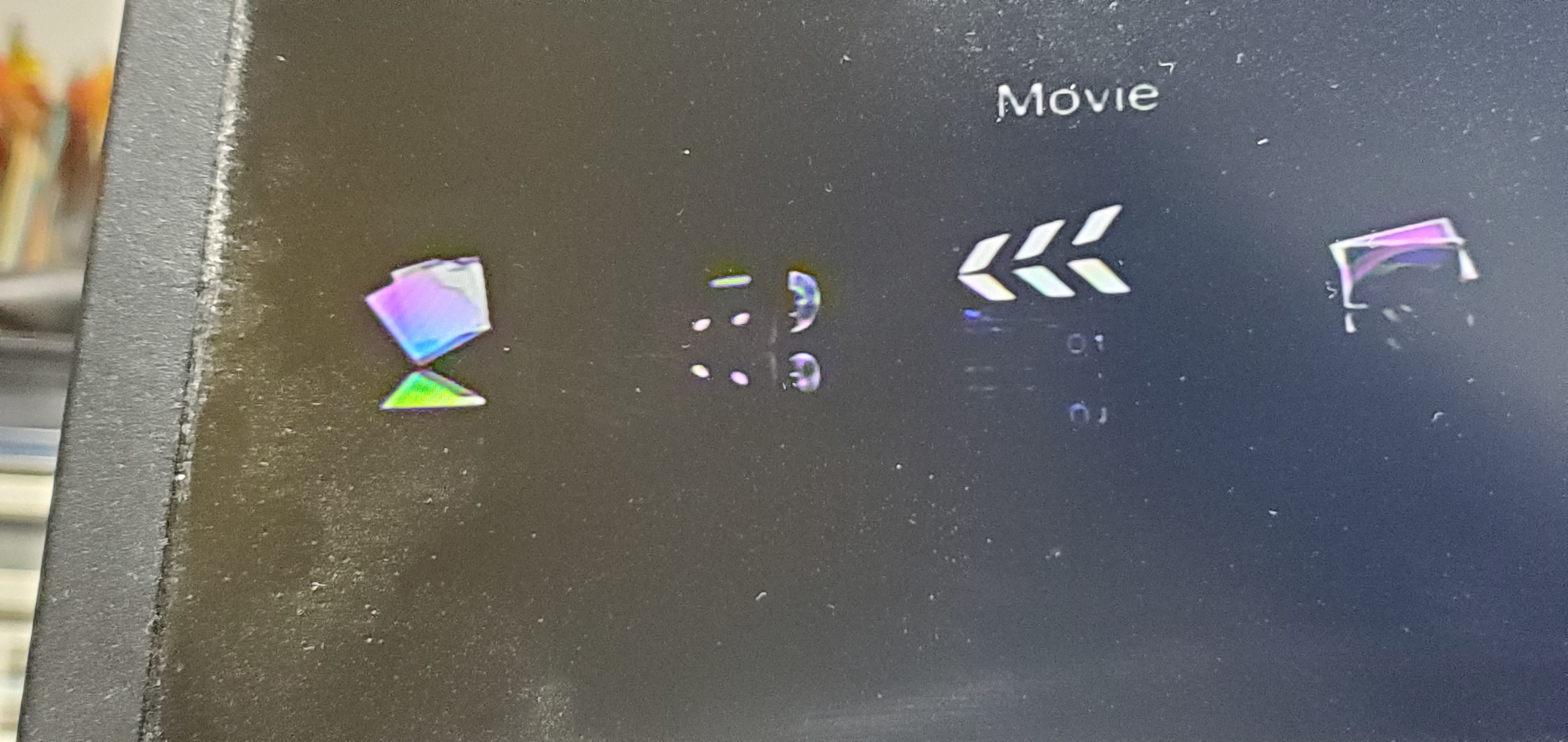

I’m trying to get rid of some artifacts in my LZX system’s output. Problem #1 looks like this:
20210425_152222
The rainbow colors you see are scrolling by quickly. The patch is external media player composite output → Cadet III → Cadet VII for scaling + offset → Bridge mult → RGB inputs of Cadet II encoder. Additionally, the composite out from the Cadet III is going to the sync input of the Cadet I.

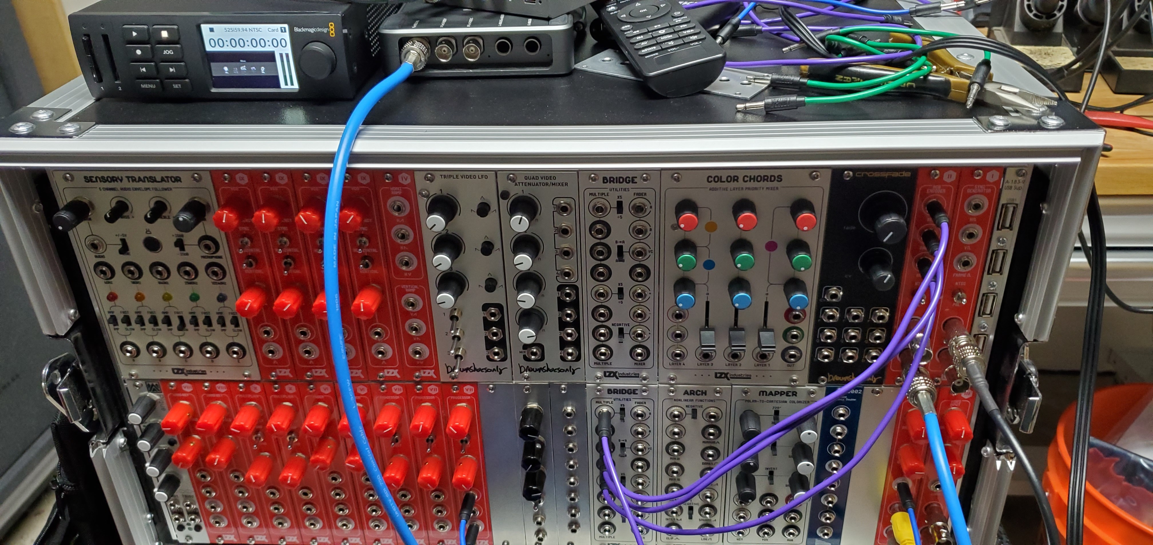

The rig is built into a 6U rack case, and this is the test patch:
20210425_152317

I did a little test on this yesterday: with the Malekko Power being fed by my bench power supply and only a limited number of modules powered up (added Cadet ramps and two VCOs to the above test group), I’m getting very nice clean lines on the Hard Keys.
