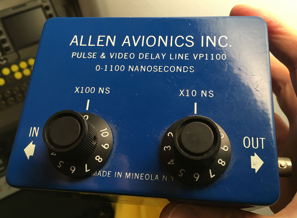

Potentially relevant:
scanlines – 26 Jan 21
https://scanlines.xyz/t/video-delay-lines/374So I picked up this video delay line box off Ebay: My expectation was that it would provide a very tiny amount of, you know, delay to a signal. But maybe I misunderstand what these things do, because I see absolutely no effect whatsoever. First...
Reading time: 2 mins 🕑Likes: 37 ❤
Link: Video Delay Lines
