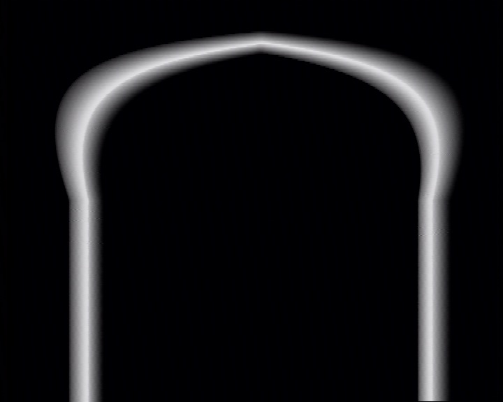

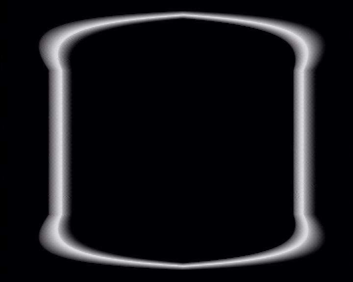

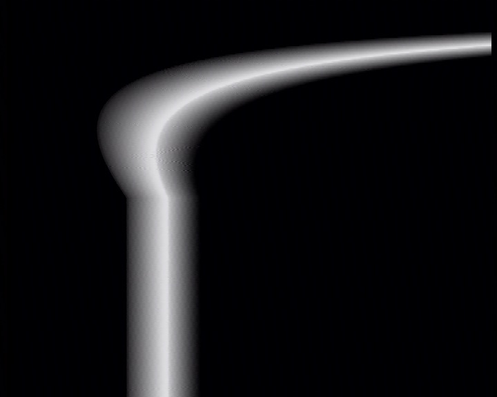

#5 — destroythings · 2018-08-28
Here is what i have so far. Ive made the first part of it and it gives me some nice variations when using the VC mirroring but not quiet there.
What have i patched wrong here?
Ramps set to centre mirroring off.
26
No mirroring. Ramps set to centre.
Untitled%2003%201
H output mirrored. Ramps set to centre.
Untitled%2003%202
H+V Output mirrored. Ramps set to centre.
Untitled%2003%203

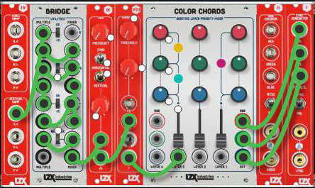

#7 — JunkRhythm · 2018-08-28
Thank you for the recipe. I patched it out, tossed in a VCO with a key and now have a new avenue to explore.
LZX%20Half%20Circle%20Patch
LZX%20Half%20Circle%20Capture

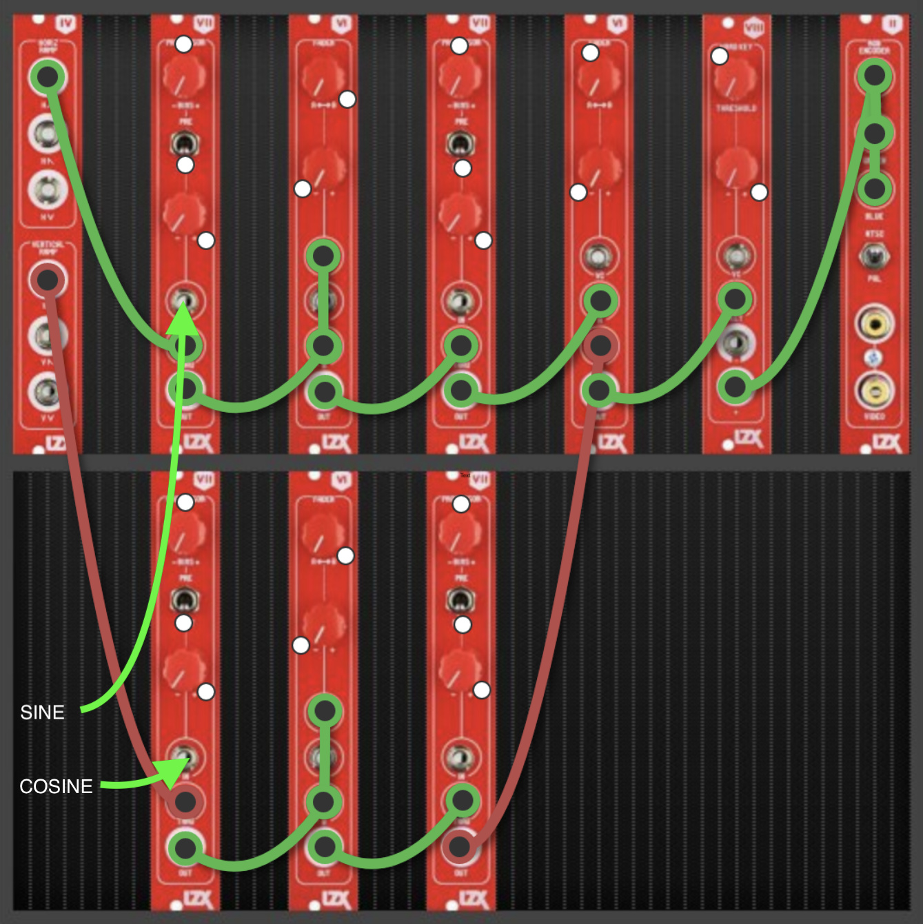

#10 — rempesm · 2020-06-27
Sorry for a necro bump but for anyone searching how to make a moveable circle shape with all Cadet modules, here’s a patch based on Lars’ notes above. If you want a basic rotation, any VCO/LFO that has sine / cosine outputs or a pair from quadrature outputs will work for patching into the first set of Processors. I don’t think this is quite what Navigator’s Rotate does but it’s passable.
Cadet Circle Ramp
