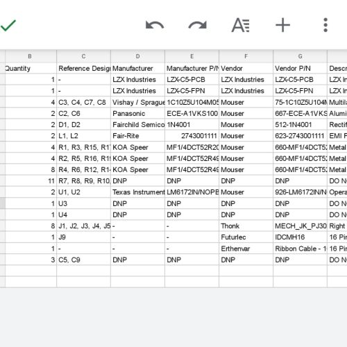

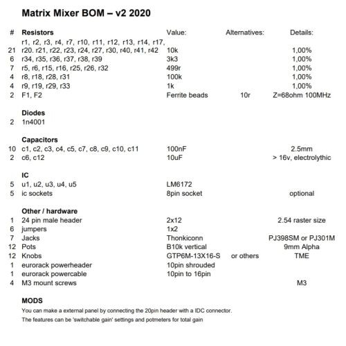

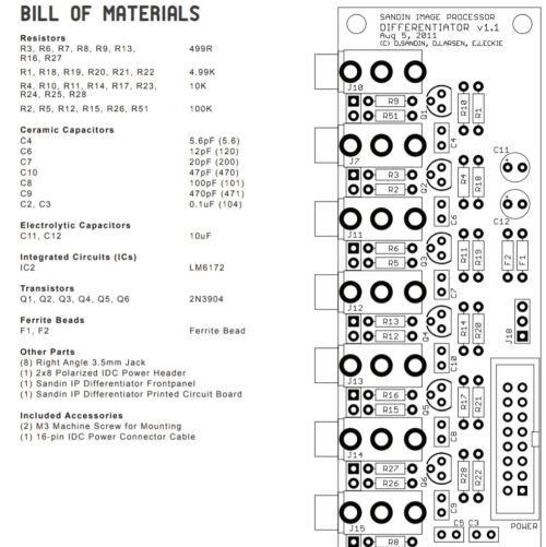

Bill Of Materials can be presented in many ways. Here are some examples - the first two are basic lists and the third is a well formatted and detailed spreadsheet as per LZX Cadet and Castle modules.
Each maker will have their own way of sharing this info…
Since I started off with the Cadets, I found myself either amending the BOM to mimic that format, or just straight out retyping it in excel so they’re in the same format.

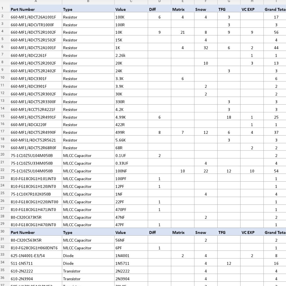

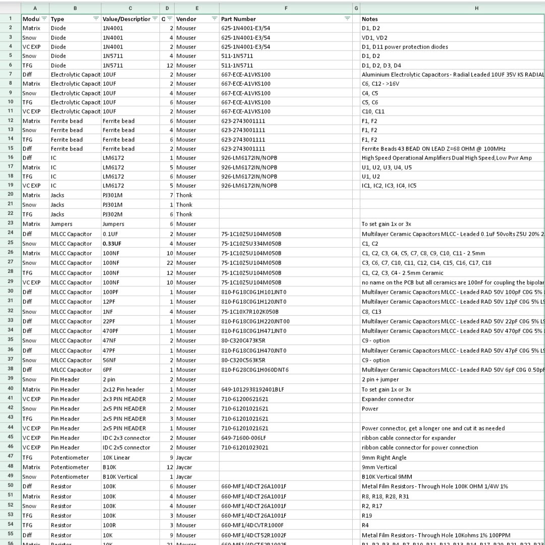

With all my required BOMs organised per-module on different tabs of my spreadsheet, I copy them in to one big list:
From here the data is cleaned up a bit, ie making sure descriptions match for the same component values (which can be as simple as removing spaces, or as involved as re-typing everything) and then populate the component number I plan to buy - generally by following whatever is listed by one maker or has been bought previously by me. This is one area that I find daunting, to start from absolute scratch with a billion components to choose from! Thankfully I’ve had a starting point of sorts for each build so far.
This is where it starts to make sense, the full list is then pivoted out to components per module and when I place my order I can make notes down the right hand column. These notes could be “qty discount” if I’ve ordered 10 instead of the required quantity, or if I’ve chosen to substitute the part.
Since I take the easy option and just use Mouser, I can copy the order list in to their BOM builder tool then add to cart, or if I want to ensure I’m getting discounts then go through line by line to place the order.

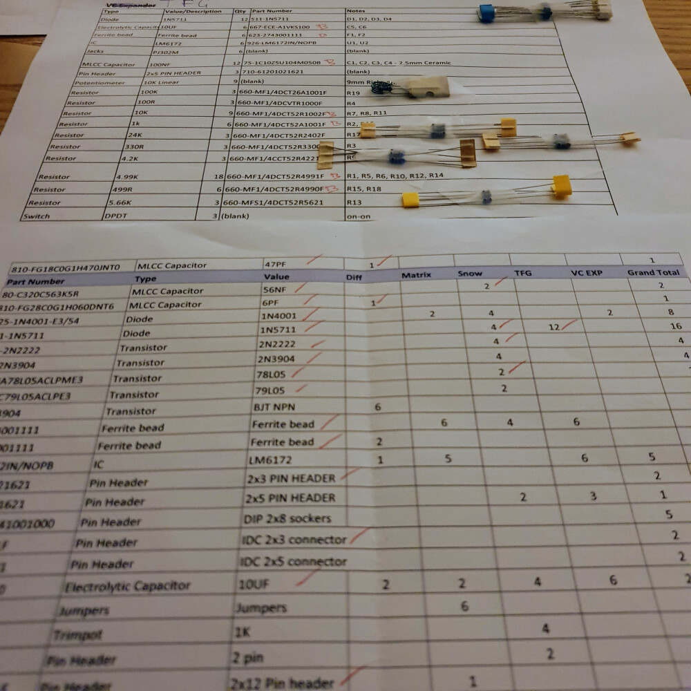

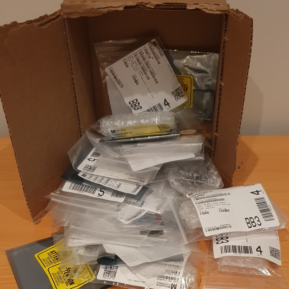

When the parts arrive, they’re all individually bagged with a part code, that matches what is listed on the order sheet

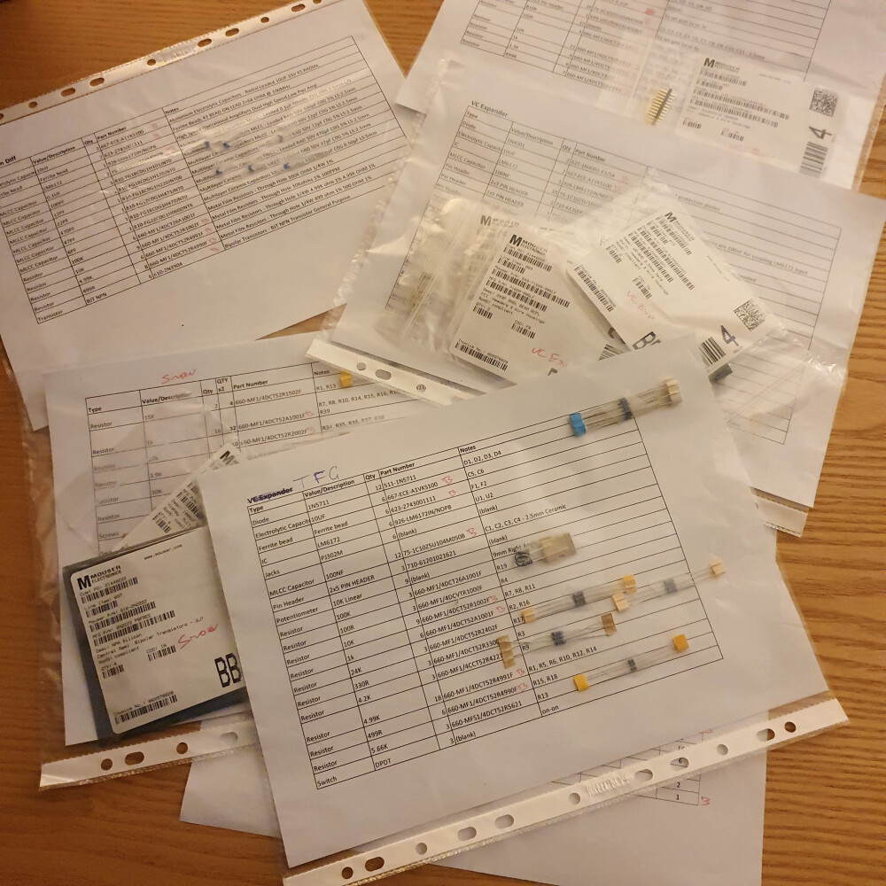

I print off the main checklist and also a sheet per module, sort through the parts ticking off the list and also sticky taping the components to each module’s sheet:
The individual sheets are slipped in a plastic sleeve, with any specific parts from other sources (ie, stash of switches or pots) and the PCB and panel. You’ll see on some lines I’ve noted “B” or “Bag”, for components where there are too many to stick to the sheet. On the parts bag’s label, I’ll write the quantity per module so when I need to pick out the parts I can double check what is required.
With each module’s parts all sorted, these sleeved lists are kept in a box ready to go as soon as I want to start building.

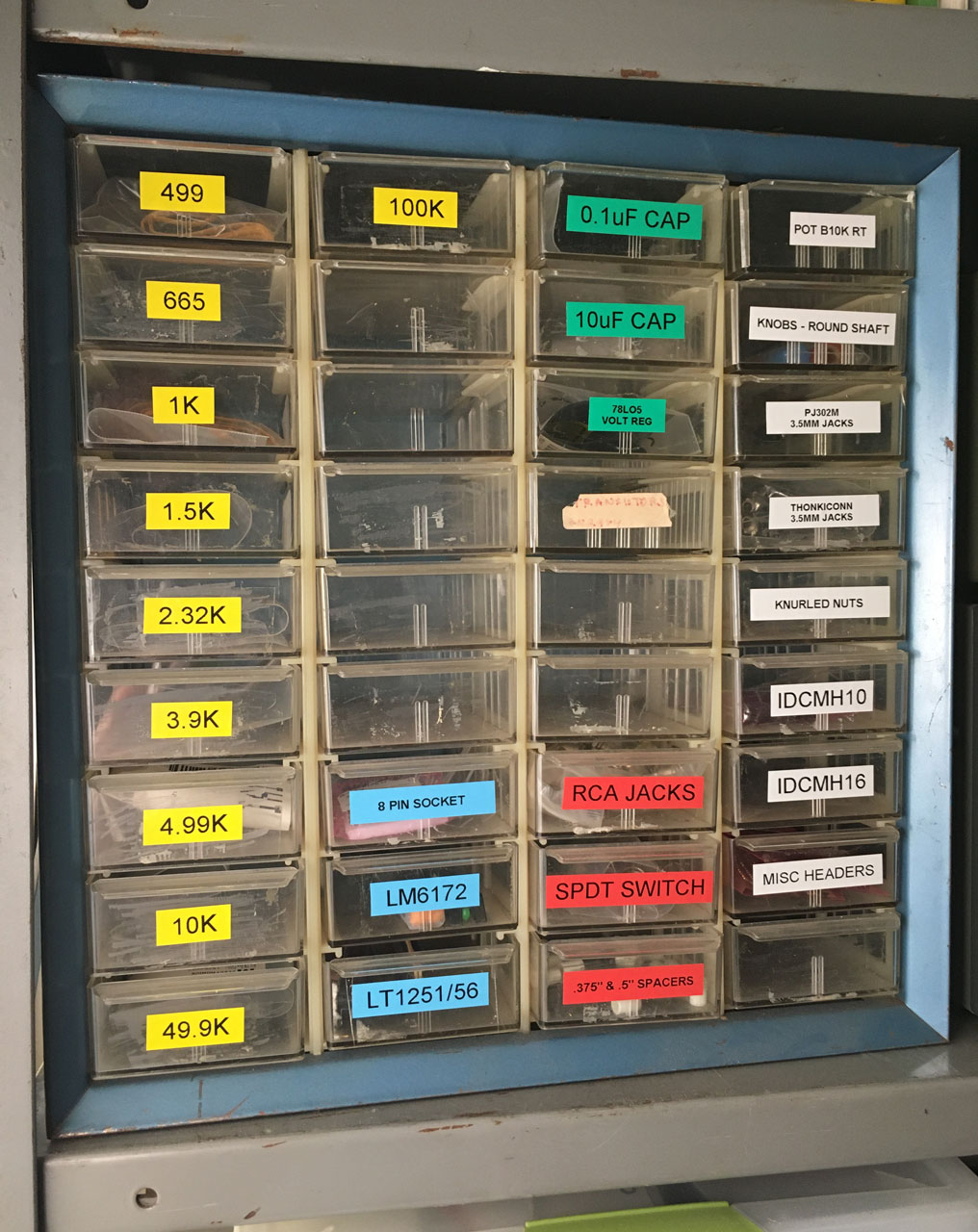

Drawers. Your way is better, I have spent so much money on 100x quantity discounts lol. But when I’m designing a module I don’t necessarily know what I’ll need in advance, so I try to have stock of all the common stuff.

After doing my first few batches of DIY modules in groups of 3 or so, I decided to save up a bunch of projects and order all the parts at once. Well, that quickly went from a little cost-saving endeavor to kind of an overwhelming issue and have now sort of been dreading/avoiding doing that massive spreadsheet task for the dozen or so modules I have waiting… Sigh. Maybe once my order from the CFOGE Kickstarter arrives?
But also have definitely started buying common parts in bulk (though nowhere near the bulk of Aladan!) and trying to keep those somewhat organized:

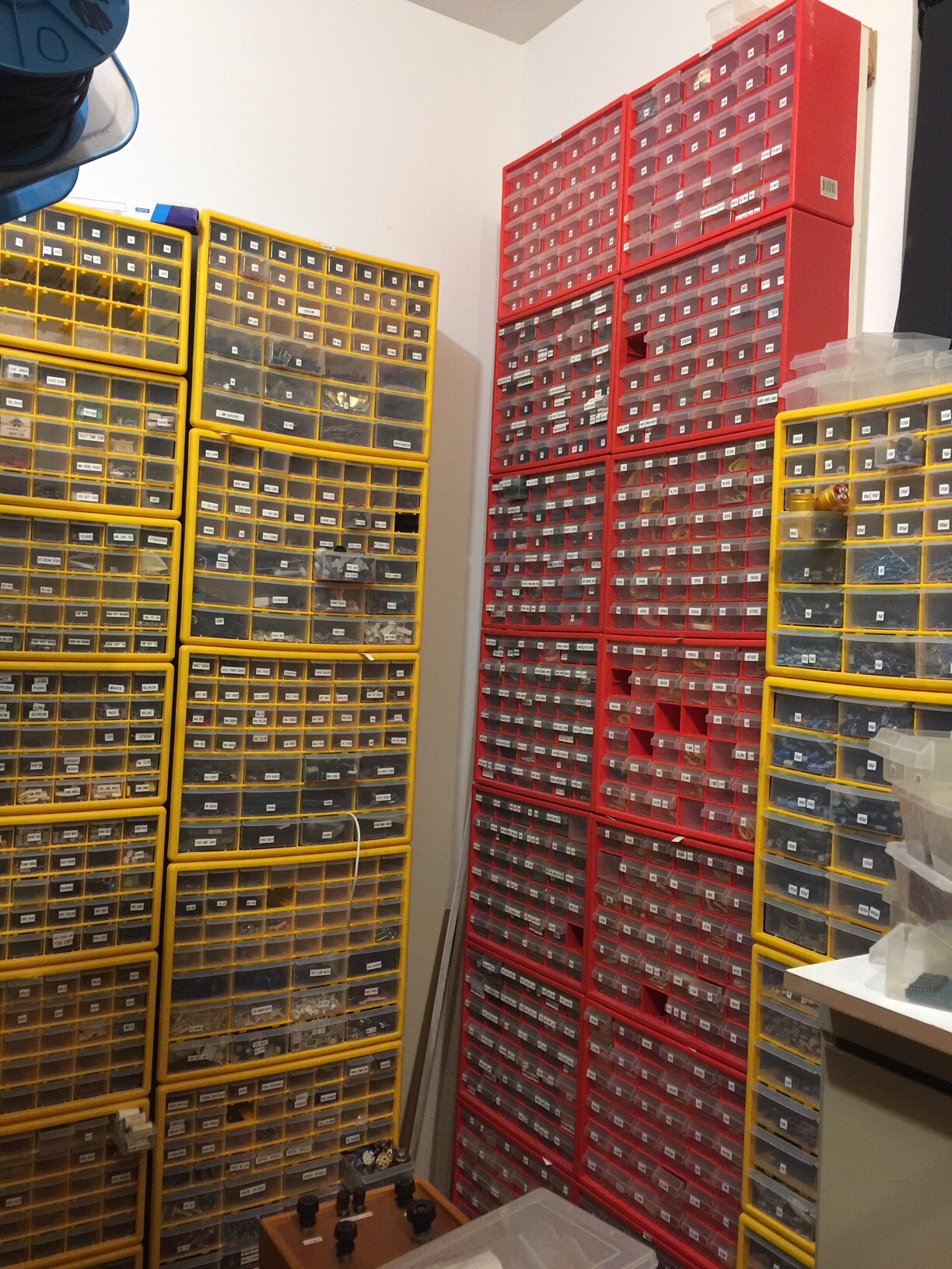

#4 — VisibleSignals · 2021-05-11
To the left of those drawers is a 3.5m wide x 1.8m deep 1.8m high compactus for the bigger stuff

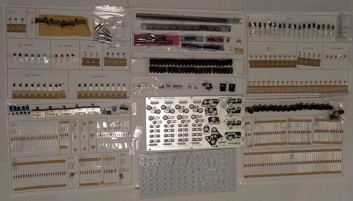

Seeing Russel Kramer’s Mainbow listed on Etsy, once I overcame the excitement of a new DIY video synth on the market, I couldn’t help but notice how the components were presented
:grinning_face_with_smiling_eyes:

Haven’t built the Mainbow since I missed out on buying one, but just used that image as an example of how this “stick parts to paper” method can work on a larger scale.
