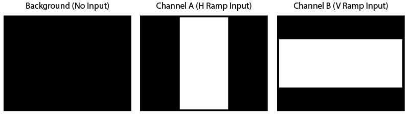

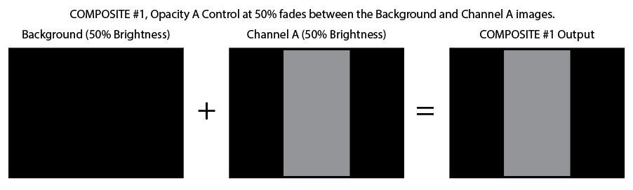

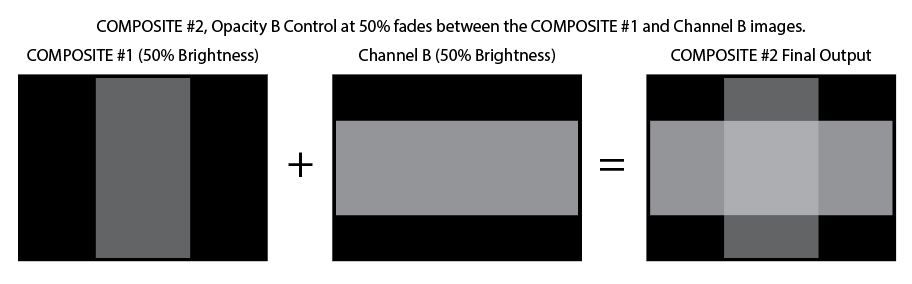

Marble Index uses Alpha-channel based mixing to create layered composites from three different RGB images (Background, Channel A, and Channel B.) Here are some illustrations that show how this works using similar sources to what you’re doing. If you’re more used to thinking in terms of crossfaders than alpha channels, you can think of Opacity A as a crossfade between the Background and Channel A inputs, and Opacity B as a crossfade between the first fader’s output and Channel B. Another important thing to remember is that with no input, the image for the channel is simply a black/blank screen. The RGB offsets make it easy to dial in a background matte color if applied to the BG inputs only.
