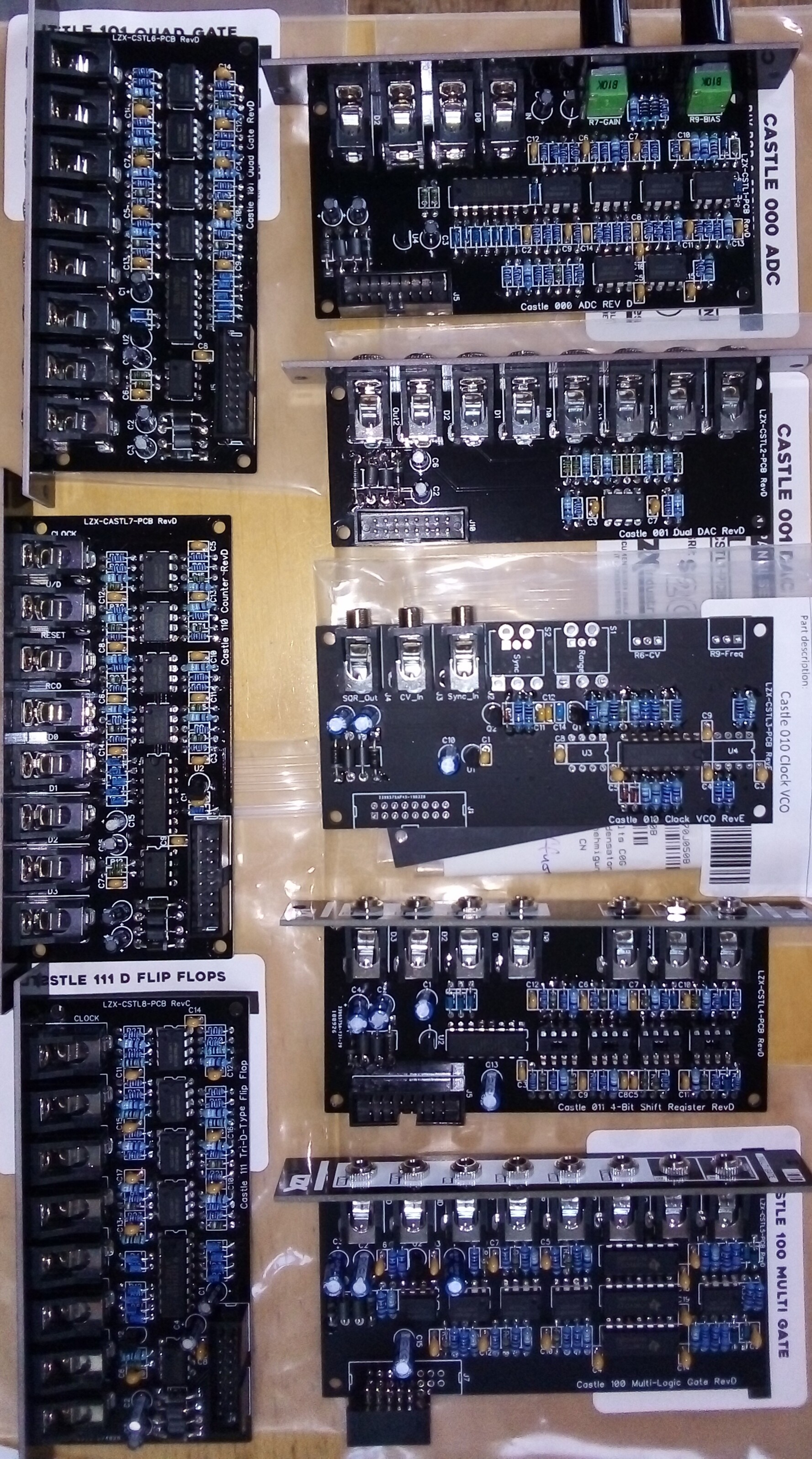

#6 — Robbertunist · 2021-05-27
Definitely the Castle DAC because its sparse & uses only a single LM6172 IC. The ADC uses 6 for instance and most of the other Castles use a variety of 4 or 5 ICs. I can post some photos here later or pm them to you @hewed

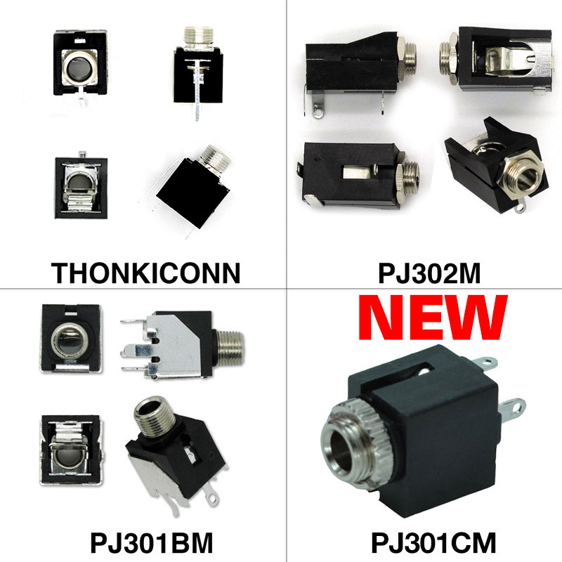

Update: Bastien makes some great suggestions below regarding various components to buy in bulk: resistors & the 100n bypass caps are obvious ones, but also the right angles PJ-302N jacks from Thonk or elsewhere. Bastien’s Syntonie range & a few if not most of Martijn’s Reverse Landfill range use the vertical Thonkicon jacks so I’d recommend getting 25 if not 50 to start with as you’ll need more if you keep DIYing and you could easily offload them if not. The entire Castle range may use as many as 49 of the right-angled jacks, if not 63, that number is strong in my head.
At Thonk the PJ-302N for 10 is £0.36 but for 50 the unit price drops to £0.24, next price break (bracket) is 250 at £0.23, that’s in way too deep
:wink:
Don’t forget the nuts & washers of course.thonk.co.uk
https://www.thonk.co.uk/shop/3-5mm-jacks/Link: 3.5mm Eurorack Jacks – Thonk – DIY Synthesizer Kits & Components

#9 — Robbertunist · 2021-05-28
hewed wrote:
Photos would be great.
Here it is, let me know if the resolution is shit, just incase it gets compressed on the upload. I’ll take individual photos for future reference & can upload these if necessary or requested.
IMG_20210528_172236
Edit: Now that I’ve just looked at the photo on here, the Castle range don’t need the 16 pin power connector except maybe the VCO but I believe it only syncs via its front panel. On the Multi-Gate I’ve used a 10 pin right angled power connector but I had to take the plastic part of first because its was the wrong orientation, pin by laborious pin. I’d recommend soldiering it in, then reform the plastic & put it back on with the correct orientation but that might be difficult: choices; dilemmas; stumbling blocks!
:rofl:
Anyhow if you’ve got a bunch of 10pin power cables looking for a module to call home, but the 10pin power sockets. Better yet, a 40x2 row of pin 2.54mm headers because the modules have the 2x 1n4001 reverse polarity protection diodes so in principle, a socketed power connector is arguably redundant.
#10 — hewed · 2021-05-28
Resolution is perfect. Thanks!
