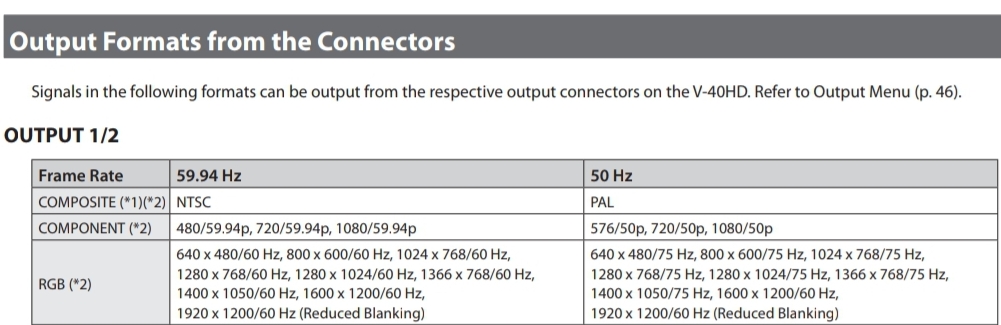

Below is from the V40HD manual, and like almost everything that outputs HD on Component, it can’t go down to 480i 29.97:
Screenshot_20210606-082640_Drive

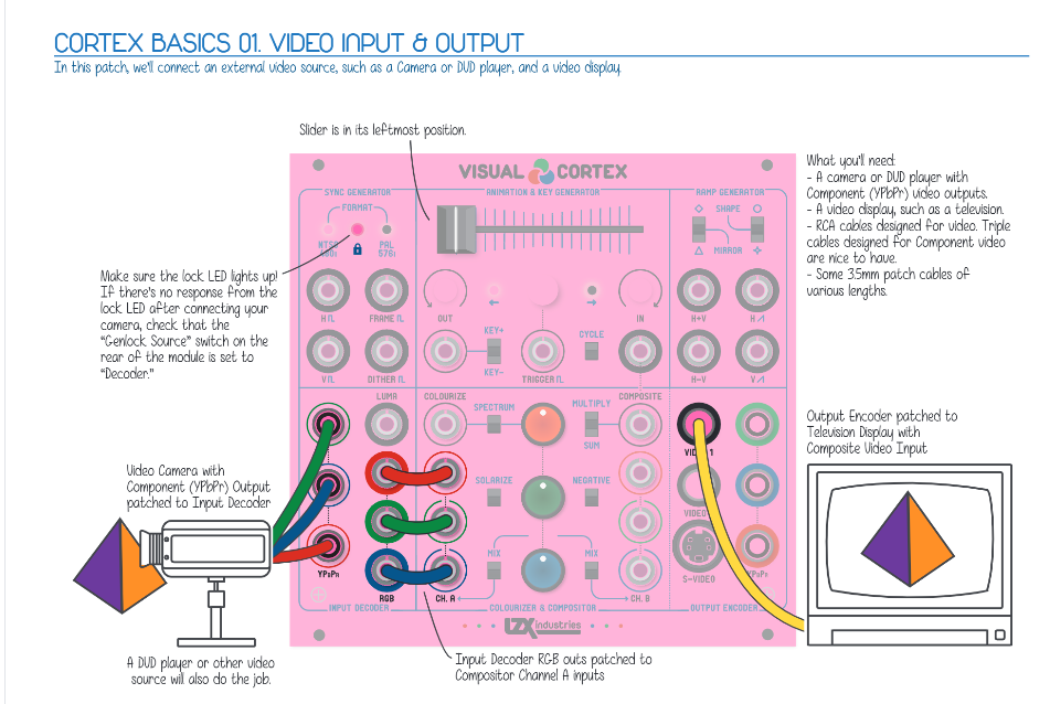

I’ve reread your setup description. When set to 480i, are you also manually patching the Red Green and Blue outputs from the decoder section to one of the input channels of Visual Cortex?
Capture

Specs can sometimes be wrong about 59.94 vs. 29.97. If something says it spits out interlaced video at 59.94, it very well may be talking about the field rate, not the frame rate (which would be half that, i.e. 29.97).
Looking at the specs, it appears that mixer does indeed only do component as progressive video (because it is likely expecting you to plug into a computer monitor or projector that itself expects a computer signal) but it does send out HDMI as interlaced. My guess is that that is indeed actually 29.97 frame rate.
So your choices are to downsample the progressive analog signal to interlaced (not sure what device is best for that, but likely there is some old Extron box you can pick up for not too much) OR you can convert the correctly-formatted digital HDMI signal to analog component (again, Extron may be the way to go there, though Ambery sells some options as well, I think). Or, well, you could convert the composite output to component (easy to find converters via Ambery or elsewhere), but you will take a quality hit.

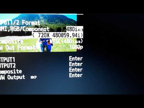

The issue is that when coming out of the V40HD, which in the menu settings shows as 480i/59.94, VC doesn’t show anything, the NTSC and sync lock LEDs don’t light up, flicker, nothing. When I keep everything hooked up the same but change to 480p, I can see an image coming through, but the sync isn’t locked so the image just scrolls as a kind of double image diagonally. When set to 720 I don’t get an image, but I see noise. So on 480p and 720 I get an NTSC LED and a flickering sync LED, but on 480i there’s no activity on the LEDs or on the screen.

Yes, I hooked the V40 up to a Sony Bravia’s component input and everything worked as intended; phone out to hdmi in on the mixer, VGA/hd15 to component cable connecting the mixer and the TV with a beautiful picture. I hooked everything back up to the synth and shot a video scrolling through the V40’s four 480 settings. You can see a test of each setting: output displayed on preview monitor, the basic patch and Visual Cortex NTSC and Sync LEDs, and the results on the small tv. So it’s known, the little tv is not at fault, it works just fine with VC, Structure, and V40’s composite out. So, I can get Luma from the composite signal just fine, or plug the composite out into the Ambrey converter, then plug that into the YPbPr inputs on VC and get what I expect, but I really want to plug the V40 directly into the VC and get a stable color image… and so far that isn’t happenin. Tell me I’m not crazy or overlooking something small, I try to do my homework, I promise haha.
Here’s a link to the video:
https://www.youtube.com/watch?v=KvBWAq1-JjA
