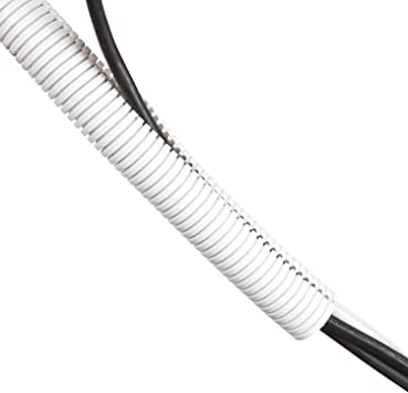

The easy way to make your own custom length snakes!

Yes!
Split loom tubing’ (above) is definitely cheap and effective (but not very graceful) for a diy snake. It’s great for something permanent and perhaps run in a rack or attached to something. 20’ of it is rather unwieldy.
if anyone is looking for better drape, have a look at tech-flex/ similar brands of ‘wire sleeve’. Kind of like the nylon version of the old finger traps you would get for a quarter at the deli. Except you buy this by the foot on Amazon. It’s low profile and comes in varying diameter based on how much cable you need to jam
Into it.
there exists also a ‘split sleeve’ that is similar to the tube but mesh and flexible if you are concerned your connectors will not fit.
I prefer the tech-flex name brand because I feel like it frays less and has more flex, but there are
Lots of options/price points.
If you are looking for the super budget solution, you can use friction tape (not: electrical
gaffers or duct for the love of cables) to wrap the cable in small 1/2” or 1/4” ‘bands’ every 18” . Or further spacing if it’s a larger cable (like feeder cable). The friction tape gums less and stays longer over time. 3m is my preferred brand it does last longer and gums less and hold better than the off brands but to each their own I think with regards to brand.
