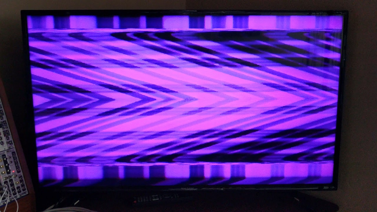

I’m trying a new patch for slow-scrolling the Diver; I’m having some success with this signal flow:
Dixie > Cadet V Scaler > BSO Quad Video Attenuator/Mixer > Diver H Phase VC in
For some reason, I cannot get smooth looping by attenuating the Dixie with Passage in place of QVAM?

I’m still having difficulties getting smooth loops. Also, the Dixie ramp into the V Sync thru Scaler/QVAM acts like a triangle wave, and I can’t get rid of the offset so it pauses every cycle. Furthermore, square waves from the Dixie into V Phase CV seem to be slewed (edit: oh, I forgot that the sliders are slewed too. I really like the default amount of slew but can it be disabled?) because it doesn’t jump immediately from one position to the next. Square waves into H Phase jump back and forth but with a little glitch at each end (edit: I forgot to send Frame sync to the Dixie; the loops are cleaner but still prone to pause or jump)
Hopefully we get greater range/resolution/control with the Diver firmware upgrade…?
Here’s the best results so far, running Dixie at audio frequency into H Sync via Scaler/QVAM:
https://www.youtube.com/watch?v=1Q4pr-PA2_w
