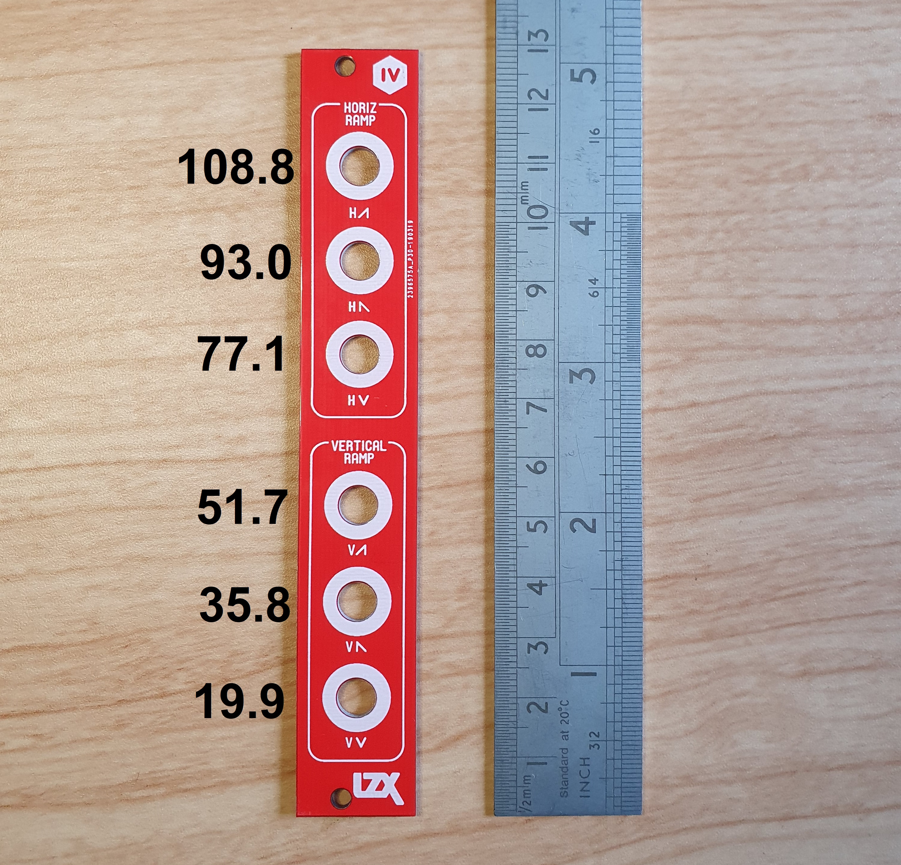

@Z0NK0UT are the dimensions of the face plate available somewhere, particularly for the placement of the jacks relative to the edges of a 4hp blank?
Alternatively, if someone has a faceplate for the IV lying around and could trace out the edges and jack holes, then scan that, that would be very helpful.

Unfortunately I don’t have the faceplate measurements (LZX doesn’t have any panels in stock), but someone with a Cadet IV handy should be able to help out.

Measurements are in mm, from the bottom edge up, to centre of each hole:
Cadet IV panel
On the centre line of the panel, of course…and may be off by +/- 0.2mm, but if you’re marking out by hand you’ll only get within 0.5mm anyway.
I’d use a 6.5mm or 1/4" drill bit, accepting the socket fit will be a bit sloppy to account for errors in your marking and drilling.

Thanks everyone for the Cadet IV measurements.

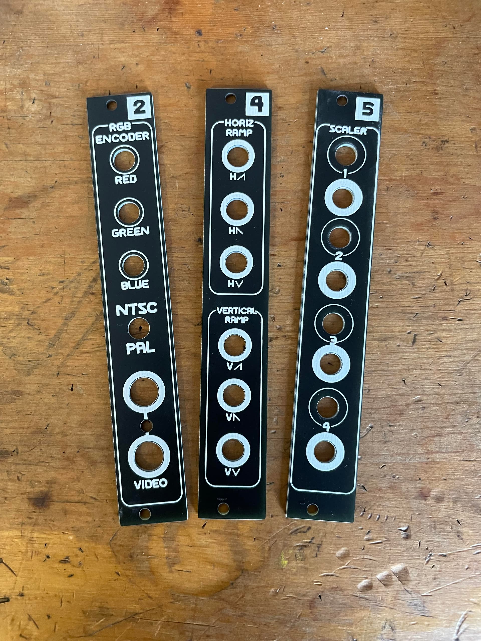

Cadet 2,4,5 panels are back! Not horrible
I’m not sure what happened to a few of the letters - the art submitted was fine on my end…
I’ve checked fit with a CUI part versus a proper PJ302M but the CUI part is larger diameter… the single 302M fit like a charm once i nutted it down. will maybe tighten up holes on rev2. More details in the readme…
all the files for the process are here, as well as a really rough breakdown how I did it - see the read-me.
GITHUB PANEL FILES
I apologize its using not using open source software, but I’ve been using eagle for 15 years and its hard to stop when I really want to just cruise on something. Happy to mash a file into another format if someone needs.
