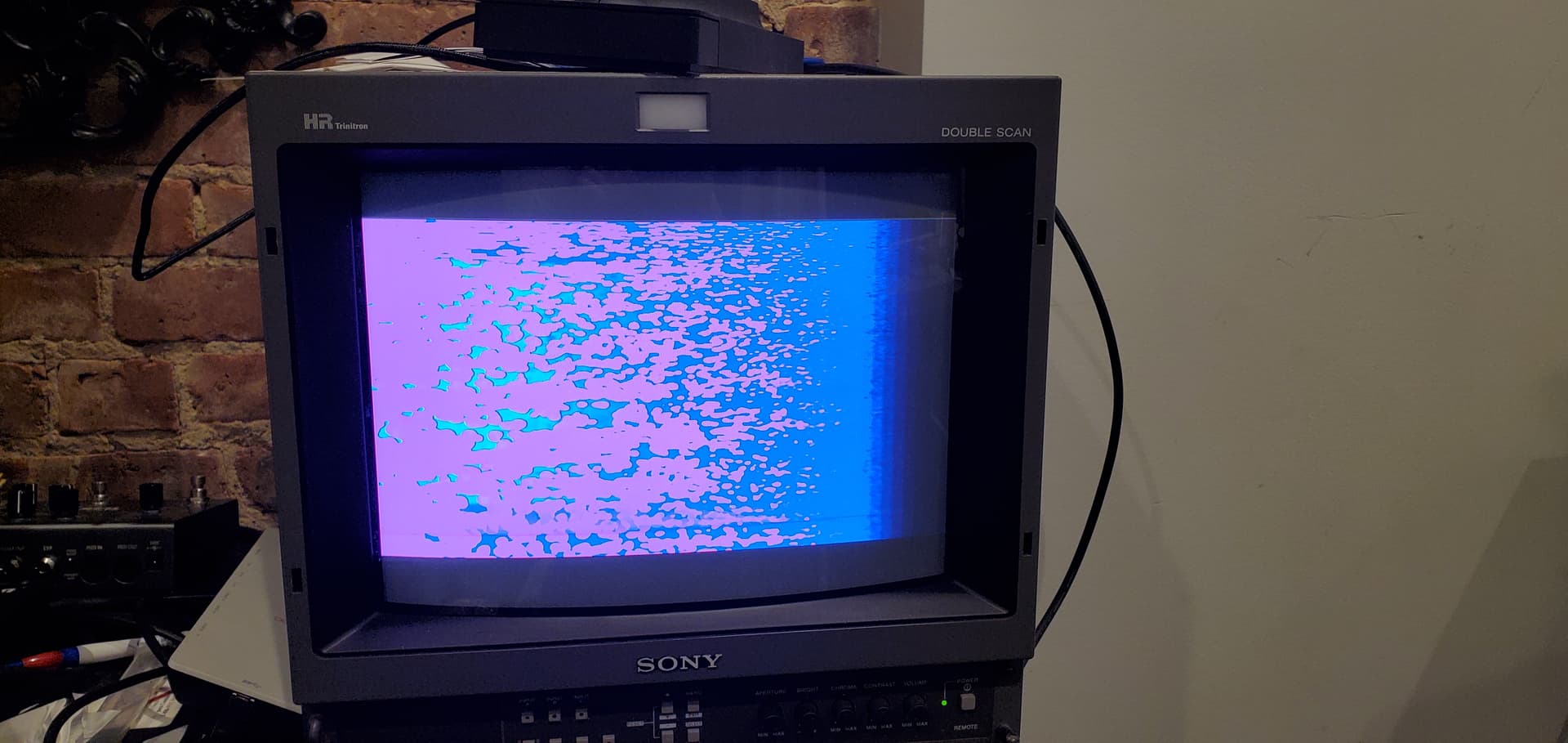

#5 — anticipatexpectation · 2021-09-02
Sony trini phms. Can ONLY do HD component video. Will not display 480 over component so no cortex or ambry component converter plus composite signal
20210228_173531
Some hd v440 feedback
