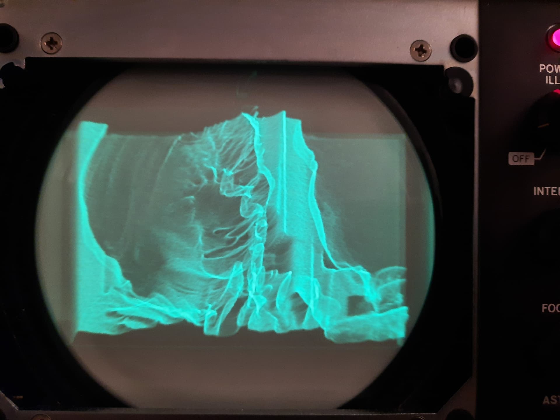

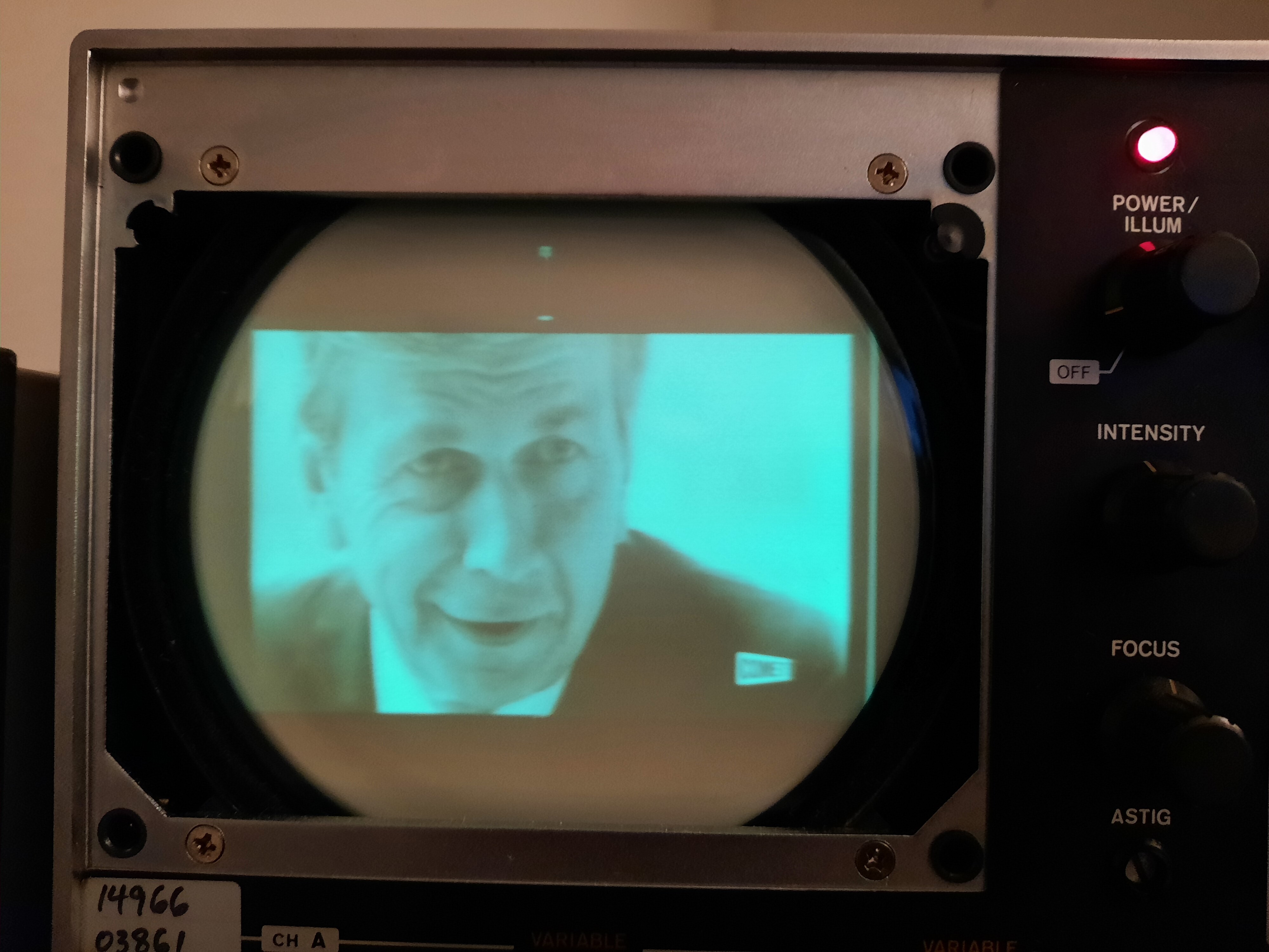

#21 — dryodryo · 2022-05-31
Thanks @Rik_bS for reminding me that I don’t need a Chromagnon to do a simple test. And guess what? IT WORKS! This is a 1080i signal, it’s fuzzy but working!
20220530_2107531
So I feel safe revealing model numbers to anyone who asks privately.
Awesome sauce
#22 — dryodryo · 2022-05-31
BOOM!
20220530_2143431
This is just adding the luminance to the X and Y sawtooths.
