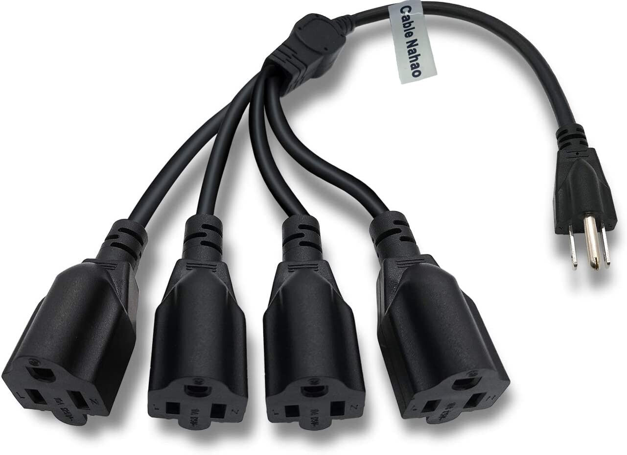

I don’t know that the splitter adapter would be rated for that amount of current, is the main concern I would have. It’s probably fine. I would personally get one of these and run the separate wall warts individually:
These cords do a good job of keeping wall-warts bundled together and are space efficient for power strip access. There are lots of benefits to a more distributed power arrangement – easier to debug if you have an electrical or installation issue to figure out, easier to replace a bad wall wart or keep a spare, etc. So I wouldn’t be super attached to the idea of powering everything off of a single source. At least not for performance concerns.

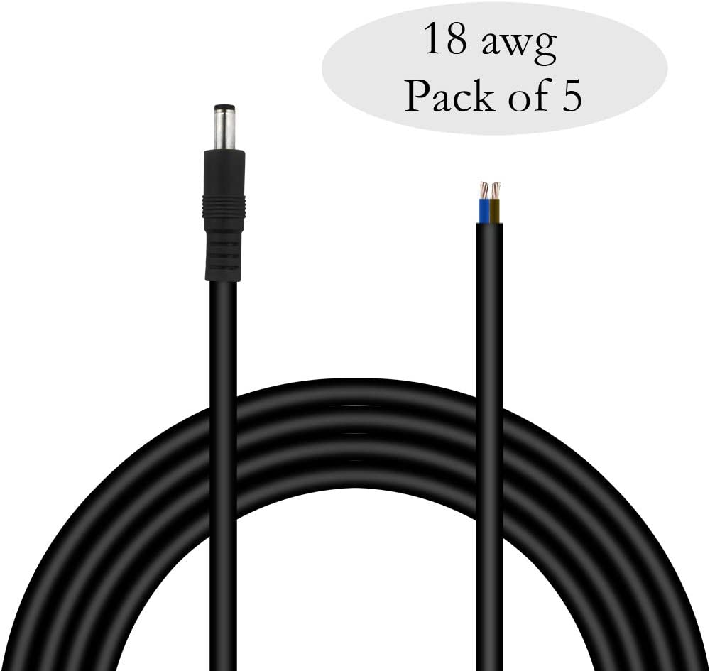

I purchased this power supply, this power distribution strip along with some DIN rails and power pigtails.
The power supply is fanless, zero noise. I’m fortunate that I have space in my rack to fit the DIN rail and power supply.
This is working great. I’ve been able to ditch six or seven wall warts for the BMD equipment, etc.
