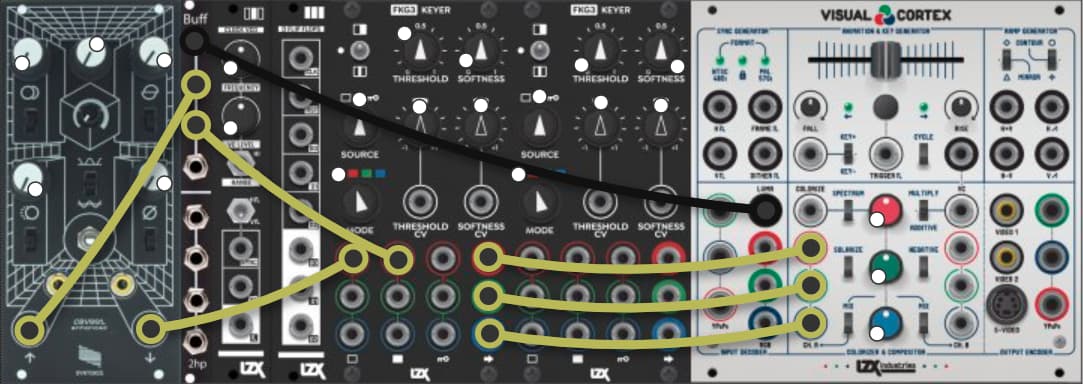

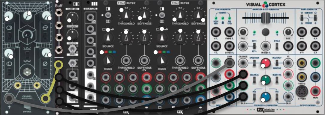

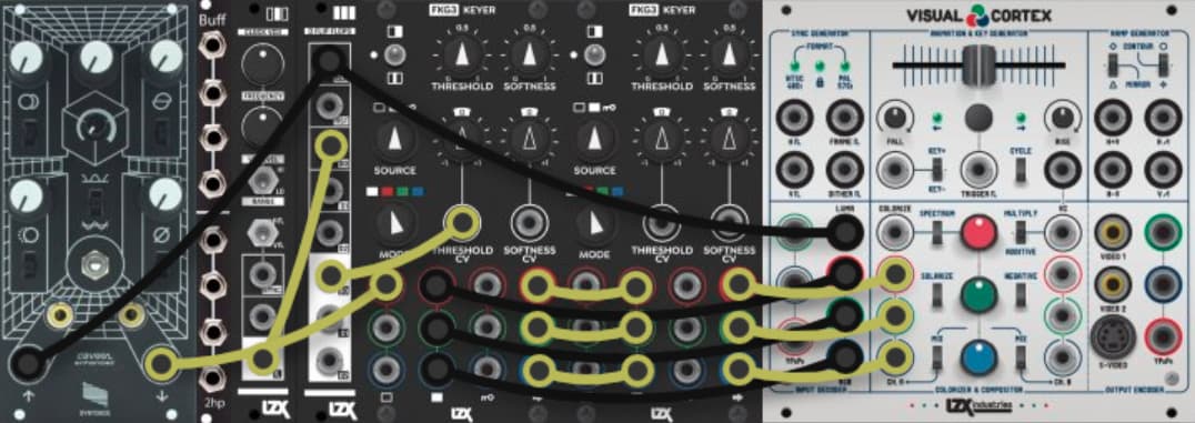

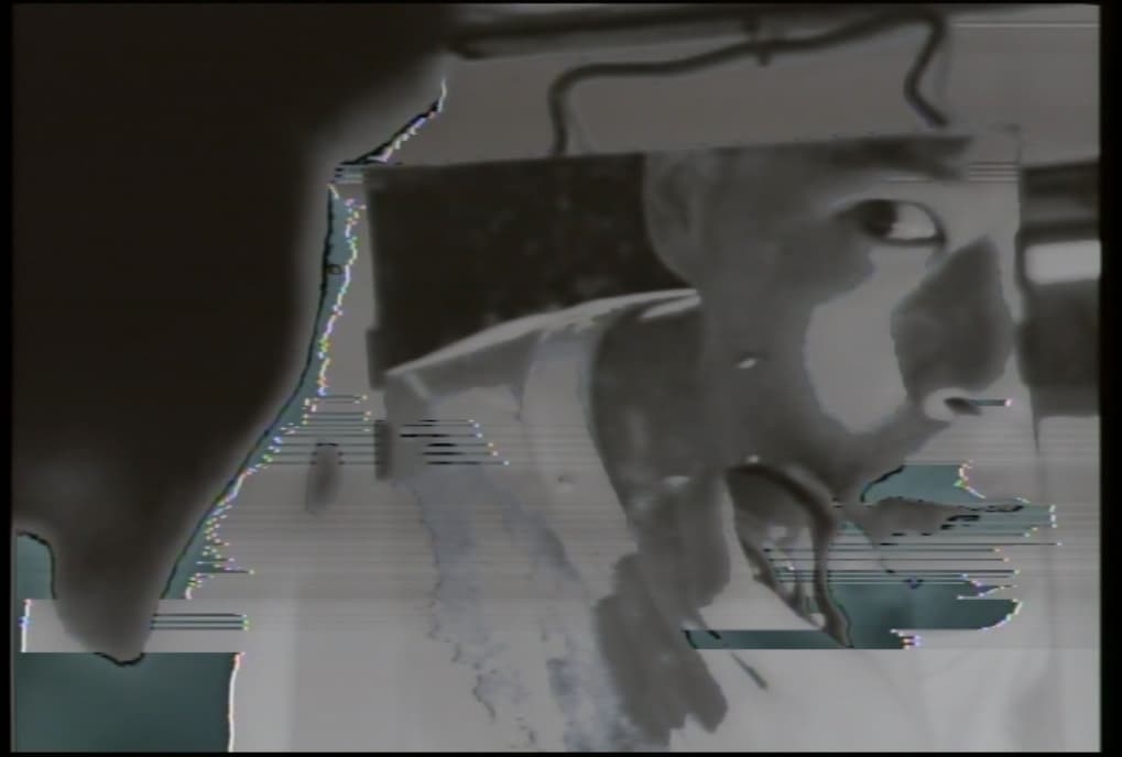

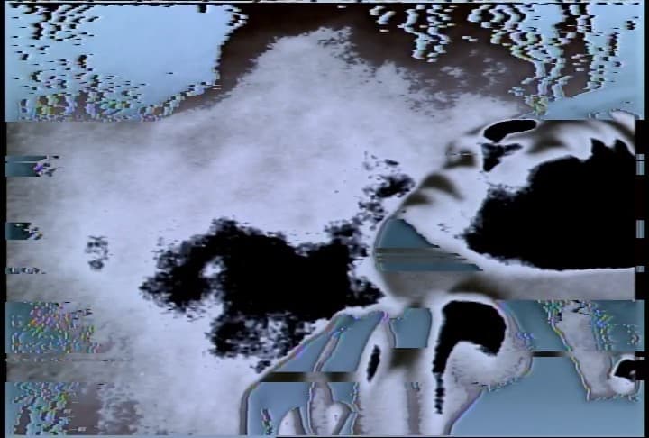

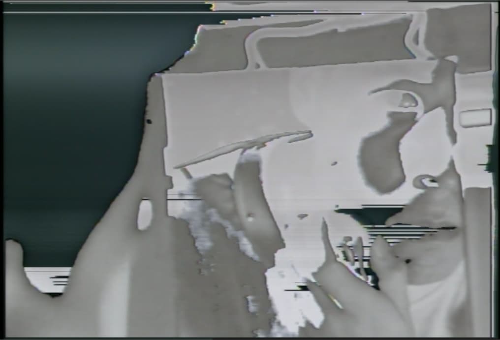

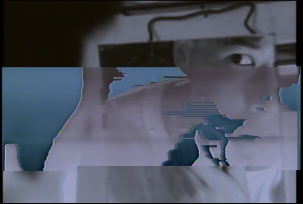

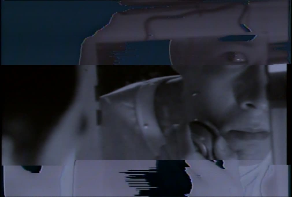

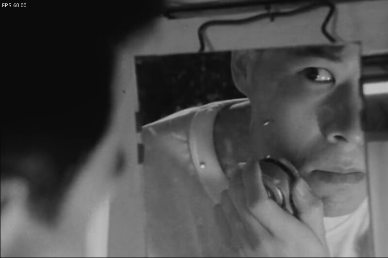

Hello. I am here after working in a series configuration with FKG3 and noticing a blue discoloration of the both RGB and monochromatic video streams with CBV001. To begin, here is the patch diagram:

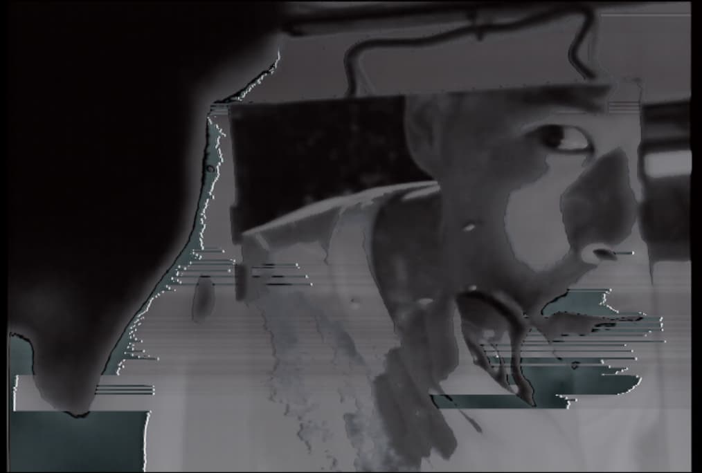

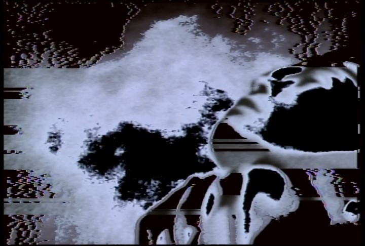

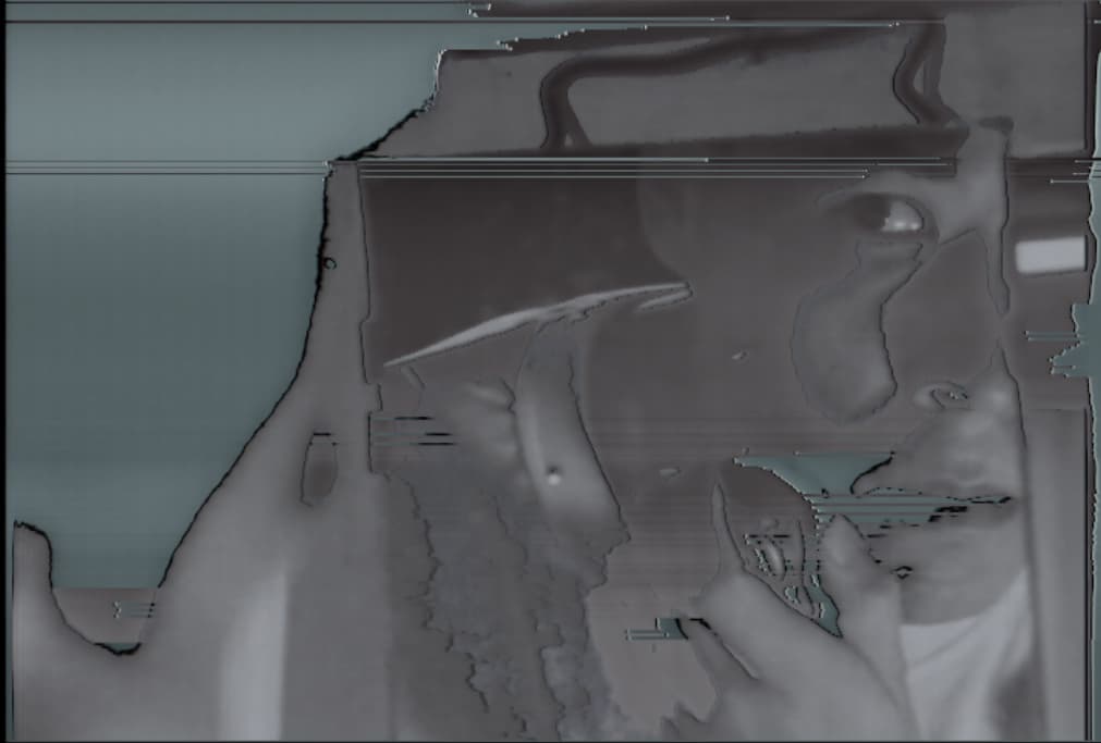

Some examples:

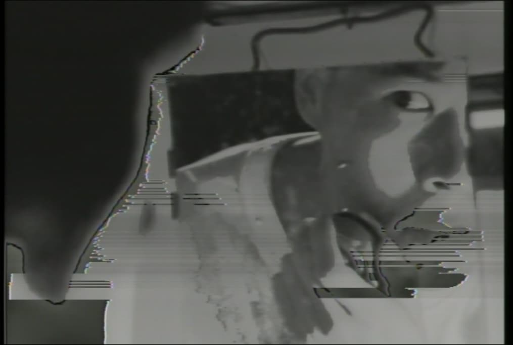

Source B&W
FKG3, normal
FKG3, inverted
FKG3, outline
So from my experimenting with this, at all settings on the first FKG, the tint is visible. At some settings on the second FKG, tint is visible unless keyed out.
- FG mode, inverted, tint appears on all settings.
- FG mode, no inversion, MAX threshold, MAX softness, tint appears.
- FG mode, outline, HIGH softness, tint appears.
Excluding the CBV001, the blue tint disappears, so this is clearly a result of the way the CBV interacts with monochrome signals. All of my converters have no hue correction applied. Mix is off on cortex. I’ve tried the out of CBV001 direct into the RED of FKG and also buffered into RED, BLUE, GREEN. I’m trying to understand what specifically is causing the tint.
It’s also worth mentioning the out of CBV001 is capable of colorizing when running directly into Visual Cortex as a monochrome signal. I’ve heard before that the way the VC encoder works, it’s not clipping the chrominance introduced into the signal by CBV and similar circuits. But the specific blue tint is most definitely not something I’ve seen before.
I’d like to isolate this issue down to just one module, but it seems like the interactions between Cortex and these types of glitch devices can allow for this to happen. I’m not entirely sure what, if anything, FKG3 is contributing to this.
Any thoughts on how to narrow this down?

Could you recreate this with the minimum number of modules and cables possible, and with no modulation present on FKG3?
It looks like the Blue tint is coming from the Blue output of Cortex, right? The Luma out from Cortex isn’t going to carry a blue channel at all, so if there is any blue present in the input signal it’s being stripped out, there.
Simplest possible patch though please, and with all switch positions marked, and we’ll be able to figure it out.

As a side note, I did take test captures with both color video and b&w video, opting to post the results of the b&w because it is not tinting based off the color of the video.

Well in the patch shown, you have RGB from Cortex patched into the keyer as well as the processed Luma output – so you may have your blue offset coming from that output jack on Visual Cortex rather than the CBV0001. What’s the source device? What colorspace are you receiving? Is there a possible RGB vs YPbPr mismatch in settings? (Cortex expects YPbPr sources.) That could explain a consistent color offset from Cortex RGB using a monochrome source.

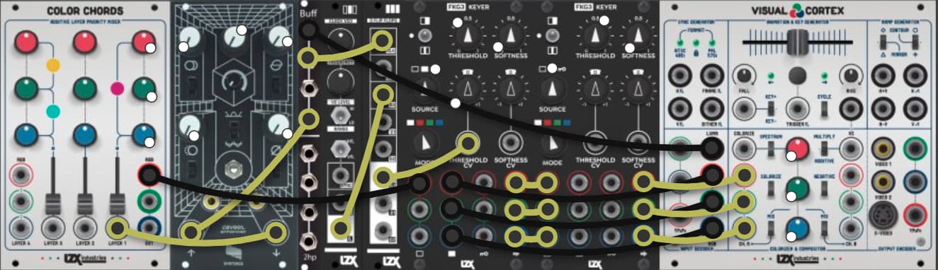

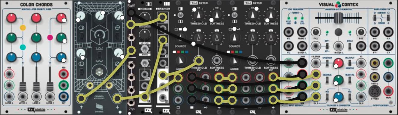

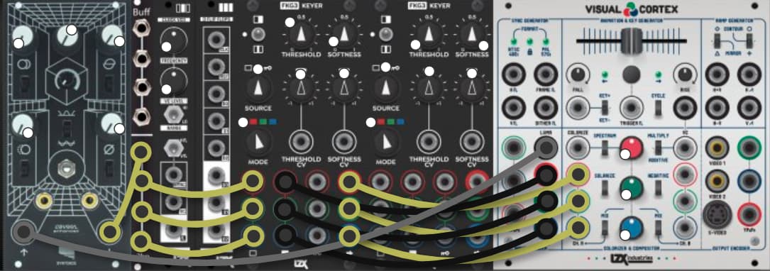

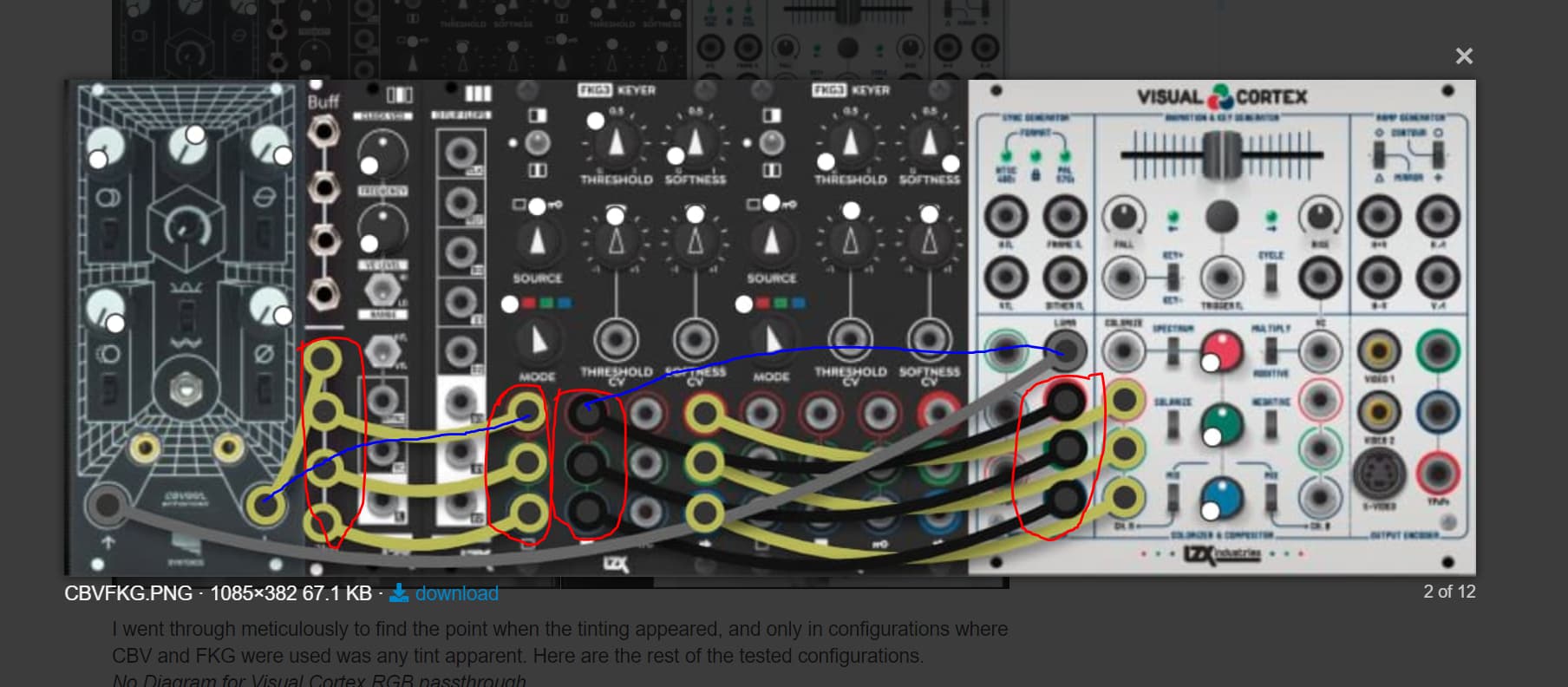

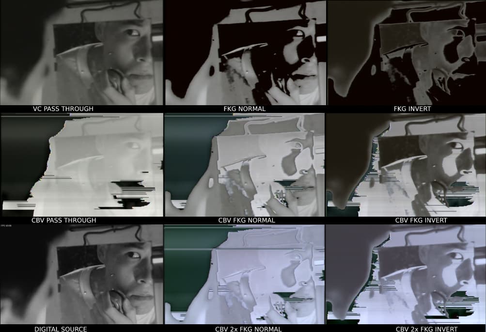

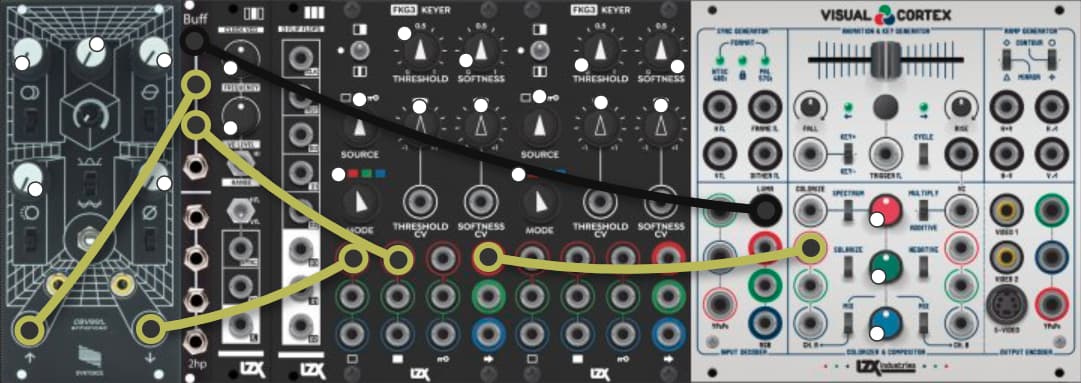

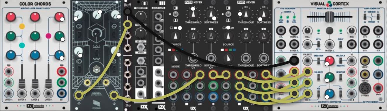

Alright, got to sit down and approach this again this morning. I have here patch diagrams for all the steps and a grid comparison as @7pip suggested.
Comparisons
As soon as the CBV passed signal through the FKG the tint appeared.
CBV as BG, RGB as FG
I went through meticulously to find the point when the tinting appeared, and only in configurations where CBV and FKG were used was any tint apparent. Here are the rest of the tested configurations. No Diagram for Visual Cortex RGB passthrough
FKG pass through
CBV pass through
CVB + FKG
CVB + FKG + FKG
At this point, I think it’s pretty easy to say the FKGs are contributing to the tint, clearly more so on the dual FKG passes. It’s hard to say that I think that the FKGs are solely responsible for the tinting, being that in the pass throughs, no tint is apparent. I’d imagine the reasoning behind this falls in line with something @pbalj mentioned on the discord server. The CBV has both an AC coupled output and is clearly not in-spec with typical LZX modules. I can say from my own uses with it I have had it colorize the final output of Visual Cortex with the sort of typical rainbow noise seen of BPCM and T+ circuit bends.
I’m still perplexed why the discoloration has this specific turquoise tone, being I’ve never seen that through any combination of modules which included the CBV. It’s also worth note that I went and specifically set saturation to 0% on then Atomos D/A converter I’ve used throughout all of the images in this thread, to remove the possibility of the converter tinting the video.
EDIT In the interest of thoroughness I’ve added two more tests and diagrams. Luma signal is buffered to avoid bleed at the input, which is an issue on the composite input, as well as with the predecessor the AVE mod.
Luma only CBV + FGK invert
Luma to RGB CBV + FKG invert
#12 — vhsdestroyer · 2021-11-04

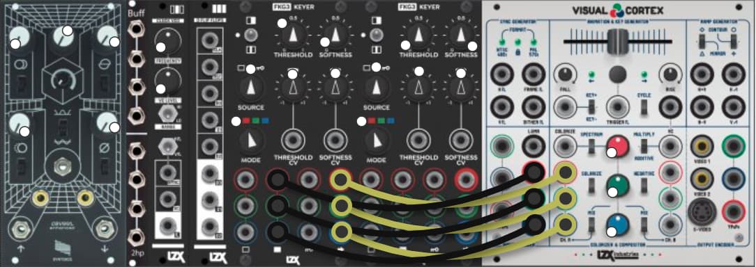

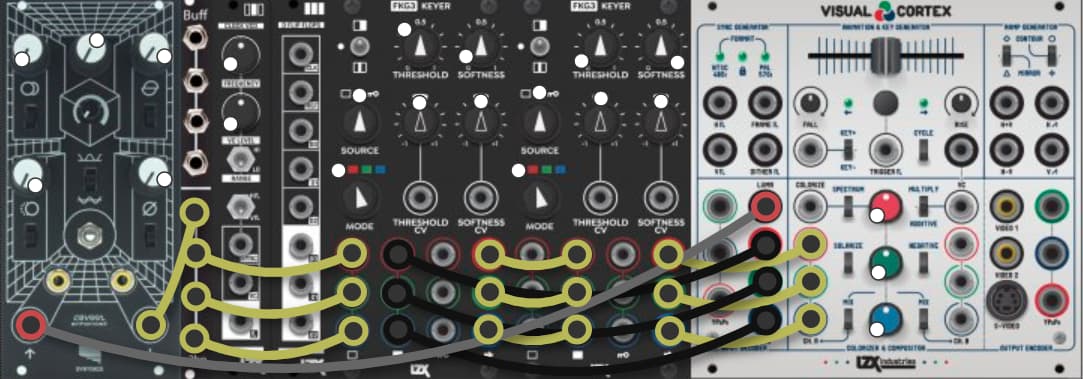

I bet what you’re seeing is subcarrier/high frequency oscillation bleeding through (from CBV) into a composite output. Do you still see the tint if you view Cortex’s Component output instead?
In any case, try simplifying the patch to this and see if you have the same tint. If so, it’s more evidence to confirm the above theory.
Shown: Remove 7 cables (red). Add 2 cables (blue).
So make use of those normalled inputs on FKG3! If the source is mono, you just patch to the red jack and the other colors inherit from it (cascading normalization scheme is shown on frontpanel diagram.)

It’s worth noting that it’s normal to get some minor tint on any analog RGB passthru in the system. 1% resistors can stack up to a few points of off difference, which could result in a light tint if you compare the values. So if you were using all this with the need to get perfect color balance, you’d be calibrating your output encoders. But in this current case I don’t know that normal tints are what you are seeing or not – we just need to find where that blue is in the signal path, then measure it, then decide if that’s outside the tolerance ranges we’re shooting for with the circuit. If you can find any possible way to patch it and still see the tint with ramps instead of with the CBV in the signal path, that would help. I don’t have a CBV here for recreating the full issue otherwise.
On the Component outputs, the blue looks less saturated than your previous captures. So that’s a clue. If you could take a shot of CBV passthru using the same Cortex settings that would be good.
#19 — creatorlars · 2021-11-04
After examining this more, my running theory is that the CBV001 output must be far outside the 0-1V input range expected by FKG3, and that this is pushing some of FKG3’s circuits into overdrive. In overdrive, I’d expect any gain differential between channels to show up in a more exaggerated degree. This appears to be happening at the inputs to FKG3 rather than the outputs (since there’s no tint in the foreground.) If you can’t find any native LZX sources (0-1V constrained outputs, DC coupled) that produce the offset error, it would support this theory. I don’t have a way to test for sure until I can see CBV001’s output on a scope.
Another X factor is your 2hp buffered mult. Depending on it’s IO impedance and opamps used, it could be doing something unexepected to the signals. If you can try using an LZX module like Passage or Color Chords to buffer the signal instead, that might be illuminating.

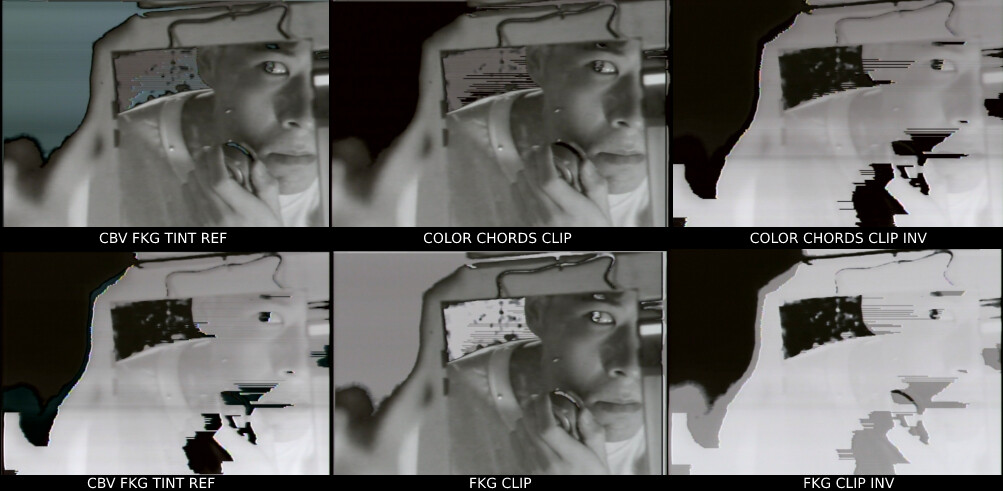

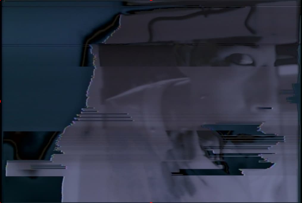

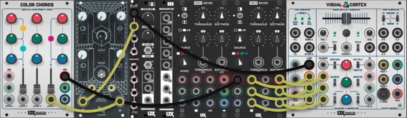

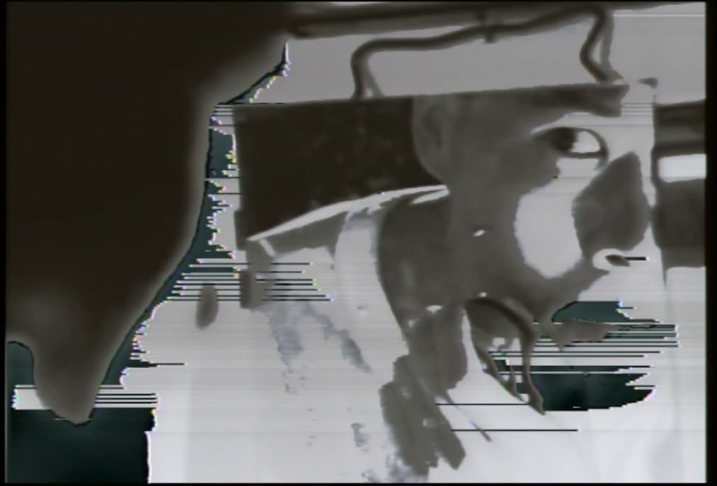

CBV001 Clipped by Color Chords & FKG3
On the inverted reference, the tint is very dark
syntonie wrote:
3.5mm jacks in/out are directly connected to the RCA in/out, so the impedances doesn’t match the LZX 100k/499R standard, signal gets AC coupled and the overall gain is little more than x2 without any distorsion involved
Well we’ve finally arrived at not just a solution to the interaction between CBV001 and FKG3, which is great, but also an answer to how and why this interaction happens. I would assume the gain of the RED channel of FKG3 is lower than the BLUE GREEN channels, which is why the tint appeared turquoise, when receiving signals above 1v. I will edit this thread in the future to document which GEN3 modules have similar interactions when receiving signals from CBV001. For now I have two more reference pictures and patch diagrams to show the difference between the normal and clipped CBV001+FKG3 patch. Thanks @creatorlars@pbalj and @syntonie for helping me sort this out.
CBV001 + FKG3 + FKG3 Before Clipping
CVB001 + FKG3 + FKG3 After Clipping
The chromatic distortion on the edge of the feedback is desired here
