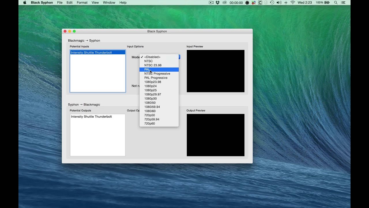

Can you open “Blackmagic Desktop Video Utility?” You will need it to configure which input is active. It took me ages to locate it on my Windows computer. There is also a piece of software, Syphon X, that is only for Mac. Here is a good video that shows both being used:
https://www.youtube.com/watch?v=piQsY5aDz88Which software “won’t recognize it” and what is the message you get? Do you mean Blackmagic Media Express?
Another setting I spent a long time finding was “Project Video Format” in Blackmagic media express. It is located under Edit>Preferences. The selection in this dropdown must match the video input detected.
When the Intensity Shuttle is plugged in and the inputs are configured properly, the bottom left hand side of Media Express will show the detected video format. If it detects a video different than the Video Format you select in the drop down, it will show in red and there will be no capture.
Media Express is admittedly bad. Maybe using Syphon X will give you better results.

I use the Thunderbolt Intensity Shuttle with an older Mac and it works fine (with Black Syphon; I find the Blackmagic software to be garbage). Though I also mostly use a standalone recording setup these days (Blackmagic Analog to SDI > Blackmagic UpDownCross HD > Blackmagic Video Assist).
