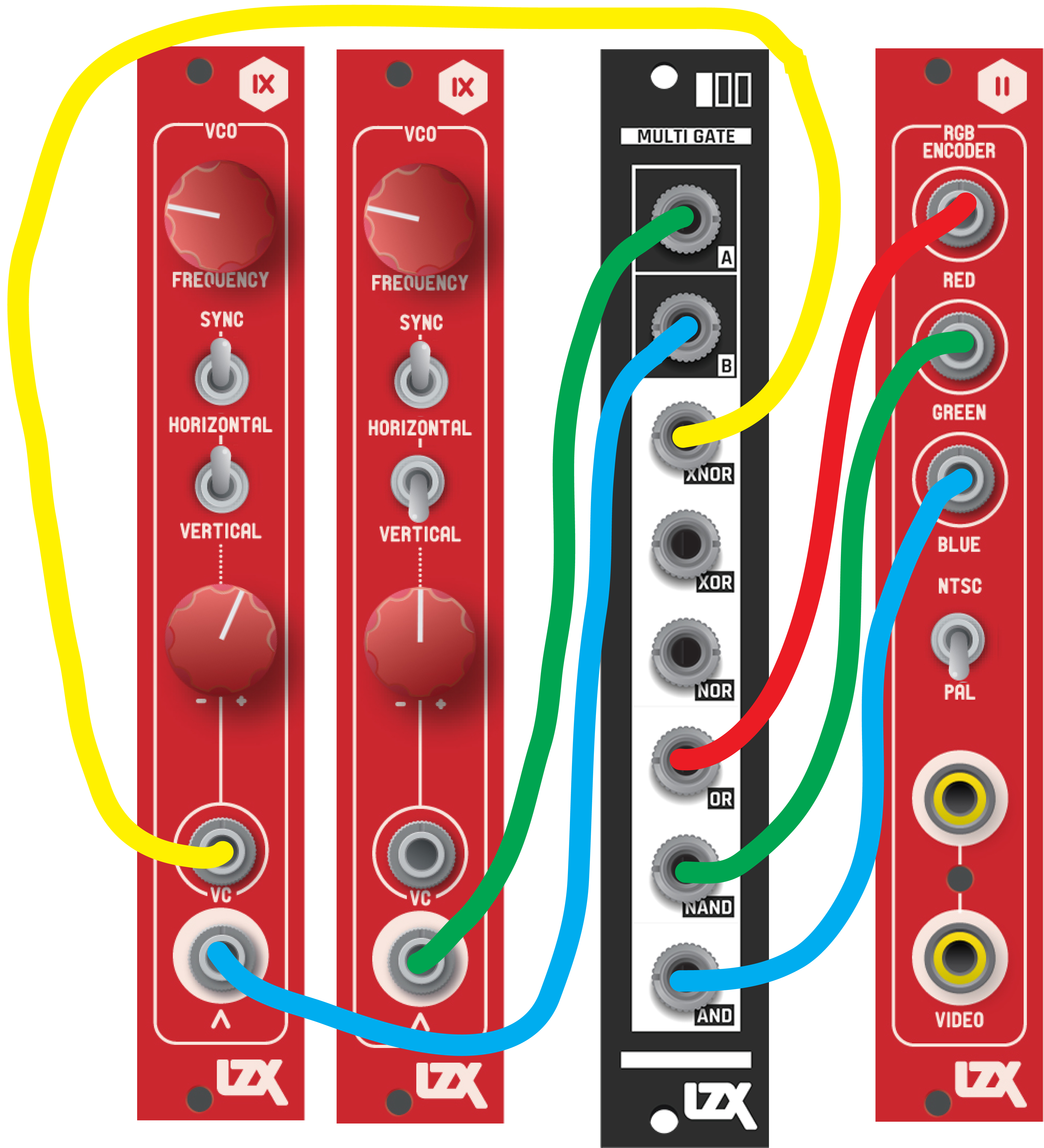

multigate:
Here are 2 patches I just made. I hope you have all featured Cadet modules.
first start with this basic patch: (leave out the yellow feedback patchcable first.)
logic%20patch1
try all outputs of the logic gates. switch 'm up to get other color configurations
play with the frequency controls and the patch the feedback path (yellow line)
Next, try modulating the oscillators with more sources, like a Ramps + another VCO or feedback from the logic gate. Use the Processor to temper/invert the modulations
You should see colorful intersecting shapes.
You can also use the Video input module instead of a VCO. this gives very cool options, like masking .
See my posts : Cadet / Castle gallery for examples of this. /forum/t/250/#post-3

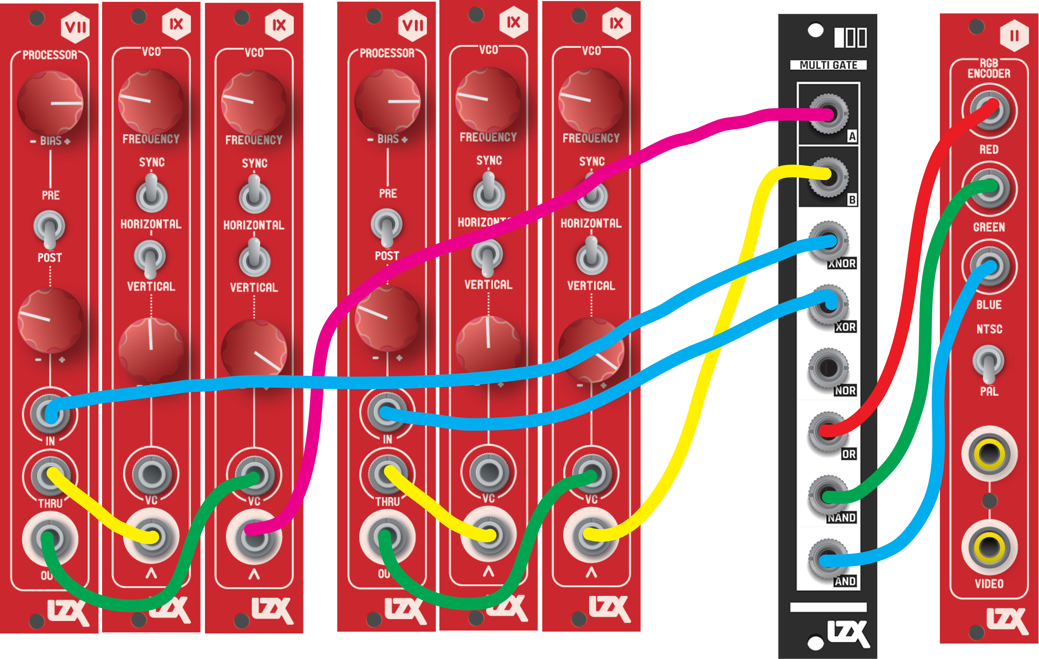

Next:
logic%20patch2
twist all knobs to get to know this patch. the feedback paths make funky shapes.
play with the frequency of all oscillators, cv inputs, Processor knobs etc.

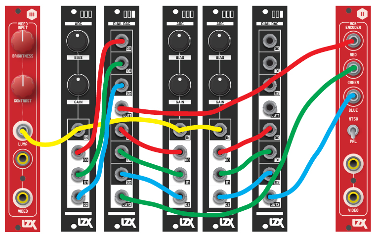

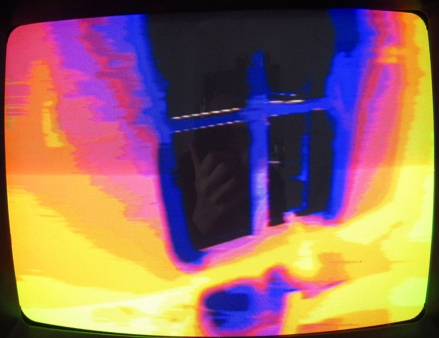

Castle ADC and DAC patch
DAC_ADC

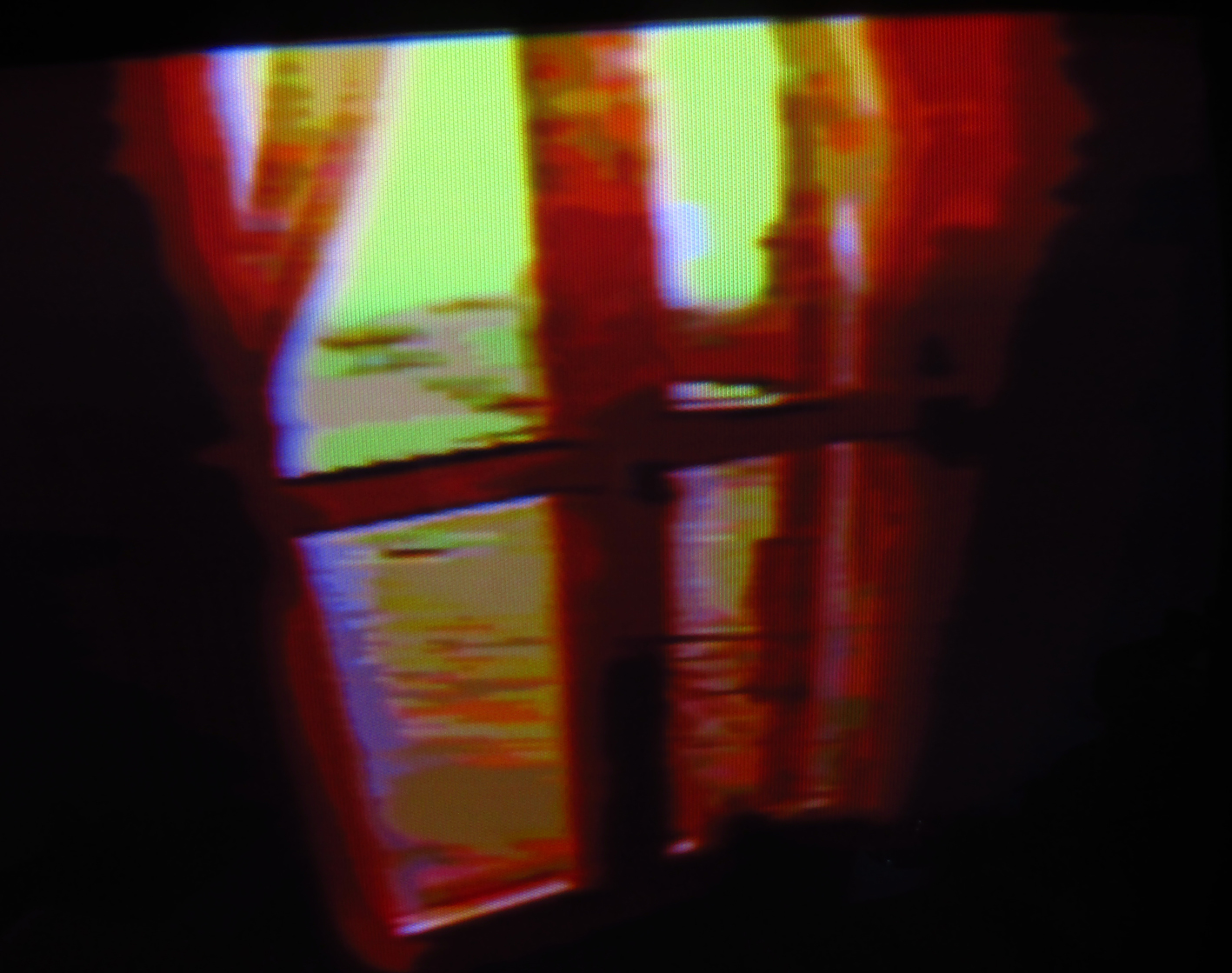

the idea is to recolorize the B&W video input. Use a camera for best results.
I have finished my second ‘dual ADC’ panel, so I could finally try this trick.
Adjust the brightness and contrast + ACD pots for setting this up.

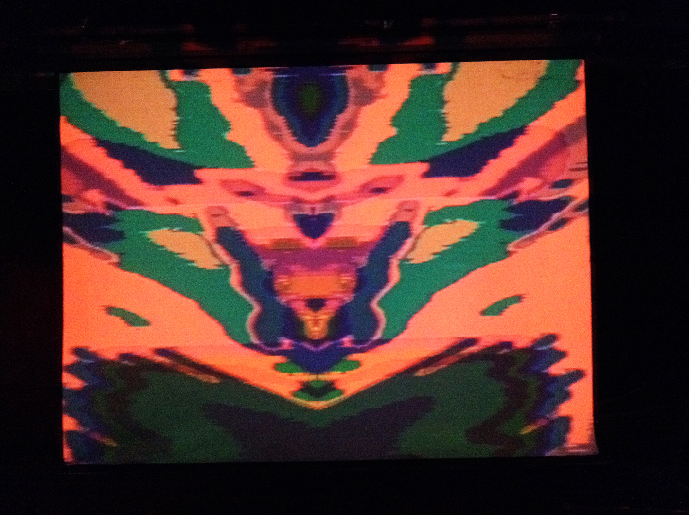

The 3x ADC and DAC can give you 9 layers of overlapping color mixing. You can get close to ‘full color’, or go wild with heatseeking images . re-order the DAC inputs for even wilder ‘paint’ effects. This is a very good basis for extreme feedback stuff. see last picture.
Add video VCA’s in between to get voltage control over all brightness values
-sorry about the screenpics. I still have to install my new videograbber.
deur1
kleiner
underpants

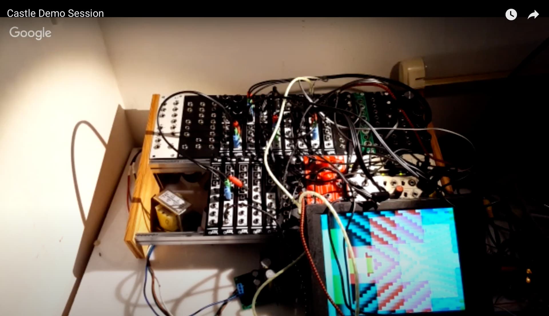

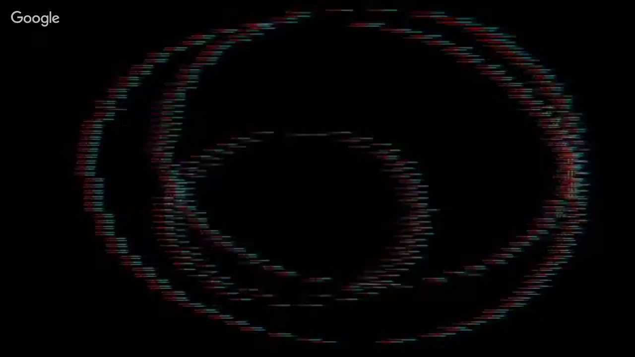

I am sending myself mad trying every multigate/counter combo to get this lovely repeating pattern from a triangle/diamond ramp. It’s from Phil’s castle patching session on youtube (link below), but the stream cut out juuuust before he put this together. It kind of looks like a staircase/stairs/frequency multiplied pattern, but it doesn’t look like he uses one in the patch.
Screen Shot 2022-10-15 at 15.50.55
https://www.youtube.com/watch?v=F5J3e_ziX6s

The finer details in the still photo look to me like it’s an H ramp + mirrored V ramp (presumably from Visual Cortex) run through a Castle Counter. (There might be something else in play too to get the vertical chunkiness?) I think that should get the repeating patterns that are increasingly offset over half the screen and then decreasingly offset. I’m less sure about how the chunky color bits are done, because I think there are several ways to do it (at least just based on that still).
