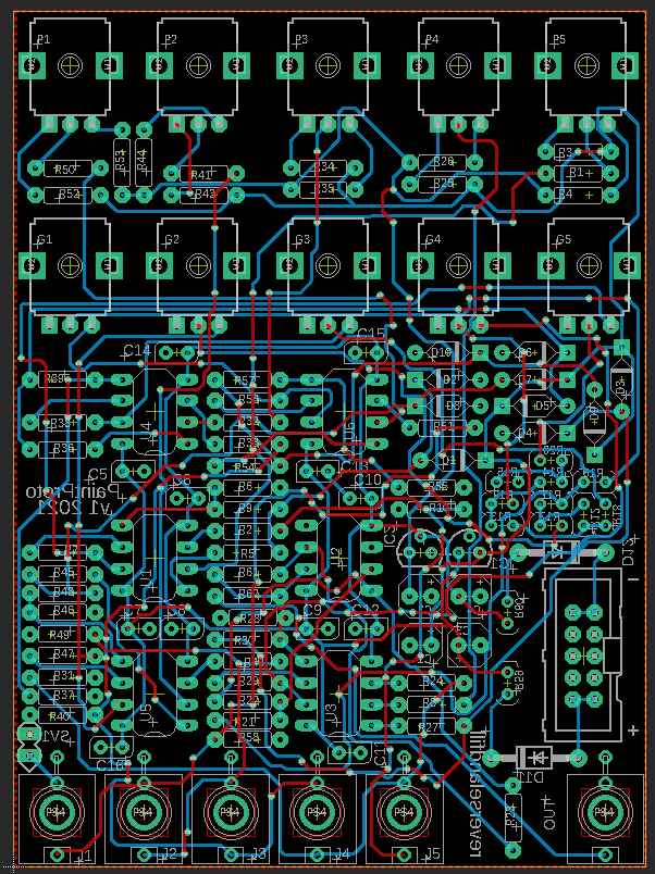

The first prototype is ordered!
The idea is to make a sort of posterize module (as featured in the Panasonic MX30 and the likes of), but with a lot of control.
So I made a design with 5 layers, which are 5x comparators with width and strength controls.
They can share the same input (they are normalised per input), but can also have their own input (for experimental stuff)
The outputs are routed into a R2R ladder and through an amplifier.
The first proto will test if this works as intended.
The next proto ideas:
voltage control over all stages
separate outputs for each stage
sandwiched pcbs
sequenced comparator output (5 step 4017 + 4066 gate)
SMD & ADA4851 (instead of LM6172)
If you have any tips or feature ideas, let me know!
picture: big pcb for testing. the final product will be smaller!

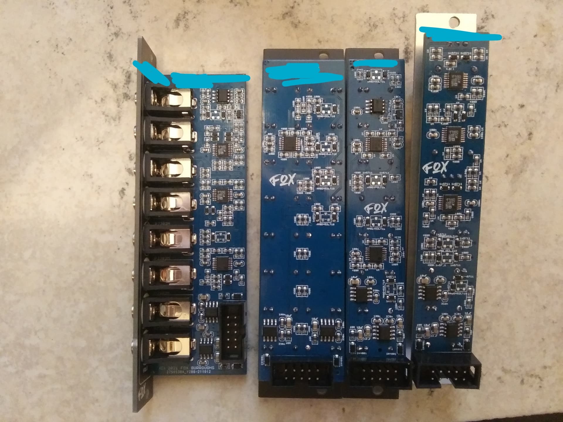

#3 — Fox · 2021-11-28
7805 / 7905. Many of the cadets, castles and expeditions use these and they come in a wide range of footprints and currents. Sometimes “traditional” isn’t all that bad.
I’m using them on all of my yet-to-be released SMD modules.
example

#12 — reverselandfill · 2021-12-10
the first test of the prototype looks good!
#13 — reverselandfill · 2022-02-11
update:
- The r2r dac works but I don’t like the looks. I’ll try a sort of active mixer config next.
- I miscalculated the range limitation resitors of the comparators, so that needs fixing (made a sim already that works much better)
- I want to add a sort of sequenced output , going to check if that will work with a 4017+4066. this also will need some syncing I presume
There is some overlap with another project, so they might merge. We’ll see
