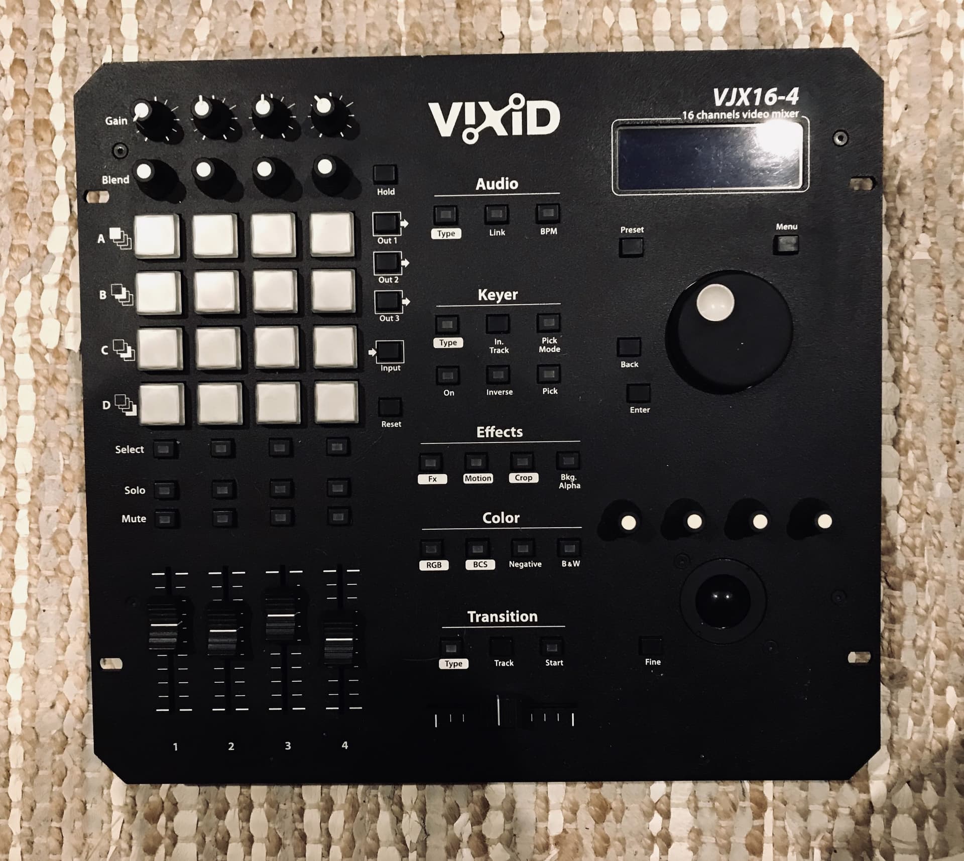

Vixid
You’ll have a very hard time finding one at a decent price though.

#8 — jwsmithwick1 · 2021-11-27
Wow! That video mixer is incredible! The per-channel preview screens are particularly amazing. What a workspace!

Just what I was thinking. I wish I held on to my VIXID

Omg, I want this! Where do I look?

I see one come up for sale maybe every 18 months to 2 years or so, in the usual places (here, Scanlines, eBay, ReVerb, FB video groups, etc.).
Last time I saw one for a price I personally consider tempting was ~5 years ago. Wish I had bought that one. Oh well.
