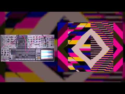

Have you tried following along with the first part of this video?
https://www.youtube.com/watch?v=66idEw9uqFk Pay close attention to trim-pot and slider positions on Fortress and knob positions on Visual Cortex.
