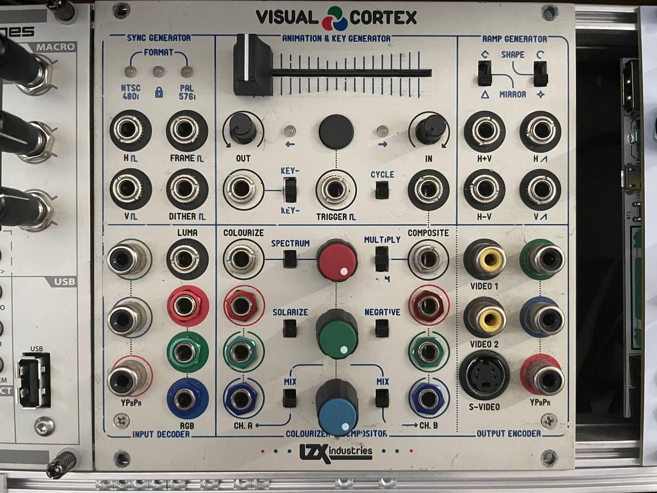

Hey y’all! I super lucked out and managed to grab a Visual Cortex from a friend and I’ve been having a ton of fun playing with it. I’ve started noticing though that parts of the front panel are fading, and that makes me super sad! Check out the “SUM” label on the composite input, and the diamond and circle in the ramp generator switches.
photo_2022-01-12_11-13-57
Can I do anything to make sure these don’t get worse? I know it’s a well-loved module and I’m personally familiar enough with the functionality to not be messed up if the labels go, but ofc I’d love to preserve the thing’s resale value and its factory-beauty :3

Yeah I sadly noticed this with my VC too even though i handled it with care.
The panel even got some yellowish hue too it when i compare it to picture of a brand new one or other white/silver modules in my audio rack
:frowning:
Maybe somebody could make a replacement panel for it?

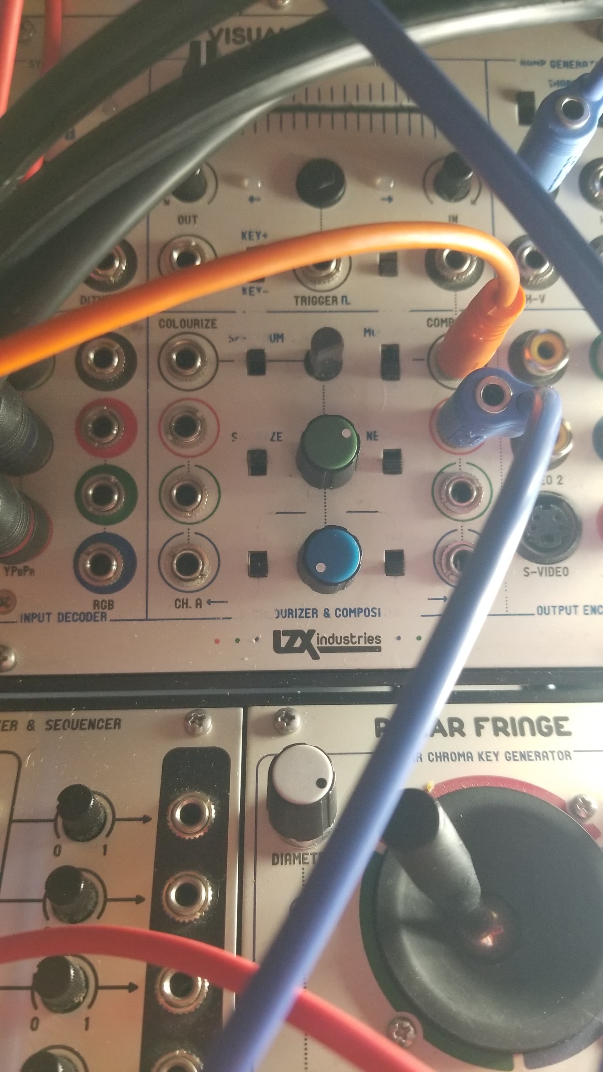

Hell, I hope to wear all my face plates beyond recognition. That cortex version is def most susceptible - now I understand why.

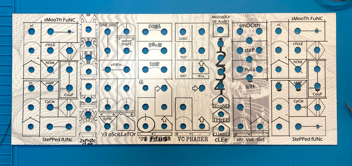

One of the beauties of paper face is that you already have a template (your original panel). I just did this serge panel (with a punk rock spin). It’s got a matte film coating though so licking will be less effective, unfortunately!
