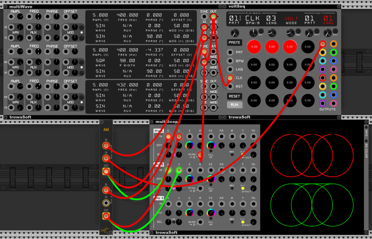

I like to use a sequencer, clocked by the “plotter” to position the copies where I want. The length of the sequence determines the number of copies. Also, blanking (red shapes) can be achieved with a square wave, with less than 100% pulse width, modulating the intensity. Otherwise you get connecting lines between the shapes (green shapes).
vcv_shape_copy

Not yet actually. There are a few different scopes, and a milkdrop vis module. We (trowaSoft) have a suite of ISF based video synthesis modules coming soon. This is our 3 layer oscilloscope with line + fill color & alpha, and blend modes per layer. It’s in our plugin pack (scope, oscillator, sequencers, OSC in/out) on the VCV library. Check it out if you like, it’s free. VCV Library - trowaSoft
