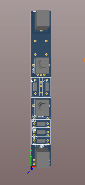

#7 — FloorHouse · 2022-01-18

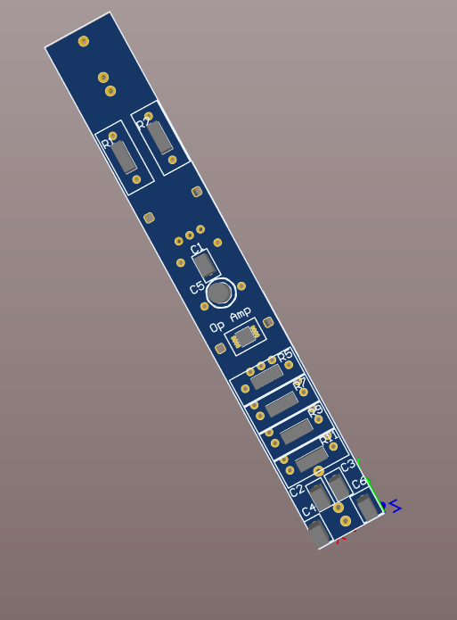

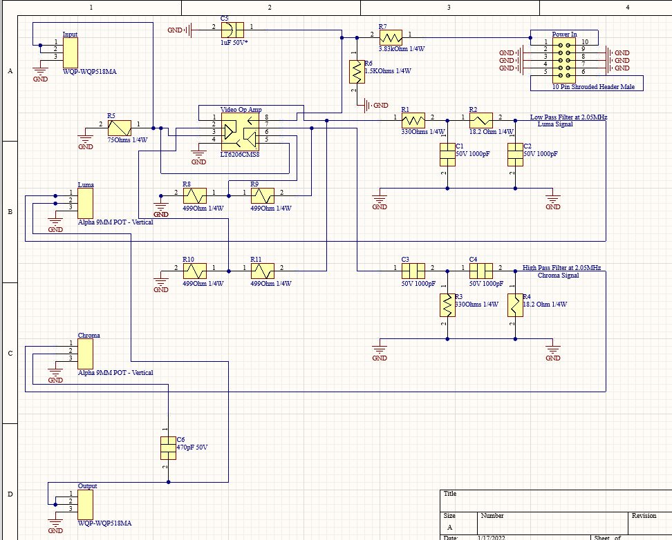

I did some research over the weekend and designed RevA of a 4hp solution to exposing Chroma and Luma.
I think this should work, going to order some parts and boards this week after cleaning it up a bit. I’m a little peeved I couldn’t find a through-hole replacement for the LT6206 Op Amp (the pitch on these pins looks tiny!).
The general idea is:
The input goes to a splitter
One of the two outputs of the splitter goes through a low pass filter to get Luma, the other goes through a high pass to get Chroma
Luma and Chroma go to distinct potentiometers for attenuation control
The attenuated Luma and Chroma get recombined then sent to the output.
If this works then I’ll look into other ways to modulate luma/chroma for more interesting effects.
#8 — creatorlars · 2022-01-18
Looks like a good start! Have you simulated the circuit using SPICE or built it up on breadboard/protoboard? This circuit should be easy to simulate using something like LT SPICE.
You will probably need to add buffering on the outputs of your filters – both after the filters themselves and after the attenuation pots. You’ll also need a 75 Ohm video output buffer before your final output, driven at double normal gain. Right now all of these parts are going to interfere a lot with your filters since they are part of the same unbuffered circuit. Looking at the AC analysis of the filter and the transient analysis of the output should show you what’s going on – if you’ve never done simulation before, it’s pretty accessible and incredibly useful!
You also need to change to a notch pass / band pass topology rather than low pass / high pass architecture if you want the full signal bandwidth, but the way you’re doing it could work for a lo-fi approach. You will just be missing some sharpness that may otherwise be present in the luma edges.

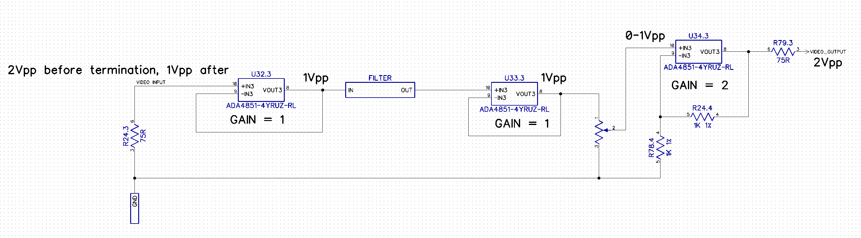

Still pretty new to all this, by “add buffering on the outputs of your filters” do you mean a current limiting resistor or do you mean implementing something like R5 after the filters as well as before the output?
I mean a unity gain opamp buffer, like this:
Also can you explain how to drive the output at double normal gain? am I just adding in an amplifier?
Here’s a rough approximation, it’s easier to show a block diagram:
Thanks for the tips!
I hope I can help! LZX exists because a lot of smart folks spent a lot of time mentoring me, it’s my duty to pass that on.
Note: What I’m proposing above wouldn’t be entirely accurate for luma gain – and there’s no consideration for sync or DC restoration. This is actually a very big circuit! It’s part of the reason for the 1V RGB signal format – if you try to handle CVBS signals on a per-module basis, the circuits get giant pretty fast just for all the infrastructure that needs to be in place. Designing stuff for DC coupled 1V RGB is a bit less annoying in that way. But you should absolutely keep pursuing what you’re working on and learn as much as you can. The most important bits for your Luma/Chroma splitter is going to be the cutoff frequencies on the filters and that you can pass the full gain from input to output drivers.

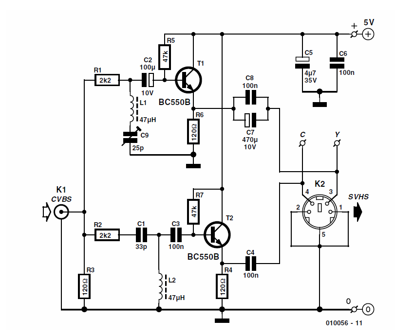

Happy to see CBV001 schematic got you into making your own stuff, even though it is a really simple circuit and uses some crude circuit bending to achieve the effects, so probably not the best example of a composite video processor. As Lars pointed out, proper composite processing involves a great amount of support circuitry (DC restore, Y/C separation, blanking, clipping, etc…) so circuit bending is kind of a shortcut to get something happening to the signal with a reduced amount of components. In that sense, Cadets schematics shows most of the required circuitry and been really helpful in my understanding of this subject.
For Y/C separation, looks like the most straightforward way is to use filters as you did. Here is a simple notch/hi-pass configuration from Elektor UK, so cutoff frequencies are set for PAL. It uses single supply/transistors buffers so signal get AC coupled at the output, but the filters could be put in between op-amps as you did/Lars shown to avoid AC coupling. Also the op-amp stages would allow to adjust the gain of the signals that would be a bit attenuated by the filters.
YC Separator Elektor
(Complete article available here videomagazines/CVBS to SVHS - September 2001.pdf at main · Syntonie/videomagazines · GitHub)
I tested it and it works decently, I wasn’t really satisfied with the fact that there was still chroma left in luma, some devices were still picking colors, so would probably have asked to remove the burst too.This made go into the digital decoder/encoder rabbit hole, as this will give a clean Y and C, with the ability to choose between different digital filters, but asks to be set in I2C using a microcontroller, and some FPGA processing to keep the output in-sync with the input, ending in a fairly complex implementation.
Then if the goal is to recombine Y and C later in the circuit/system, a not perfect filtering is less of an issue. Here is a test I did with Y going to a single comparator (converting it to a 1-bit b&w signal) and adding C afterwards, with some modulation from 2x Castle VCO of the comparator threshold. (sorry for the crappy picture extracted from an old IG story)
YC Recombining
Old composite video processors are a good resource to look for those kind of filters, here is the Vidicraft Proc Amp (NTSC) http://soundexcellence.com/old_products/ProcAmp_5-Schematic.pdf with the filter labelled as “Chroma Trap”. It’s pretty interesting as it is all discrete, from sync extraction to actual video processing.
There was a PAL adaptation of this circuit published in Progetto Elektor (Italy) videomagazines/ProgettoElektor_1987_07-08 Color Processor.pdf at main · Syntonie/videomagazines · GitHub so filter cutoff is set for PAL subcarrier.

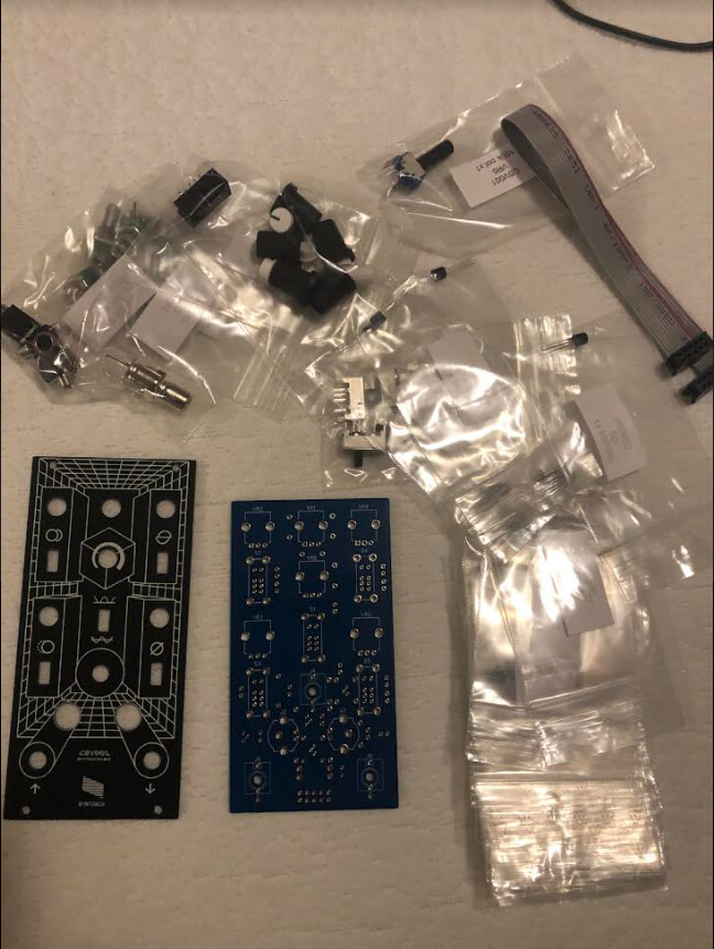

I actually just received my CBV001 and my hacked 10 hp rendition today:
Very excited to put them together tonight and debug my version using your’s.My version includes a “Drop-In” board that does all the signal processing and a front board for the control/power interface. If this format works I’ll probably design future devices to have similar “drop-in” style boards to handle standard support circuitry.

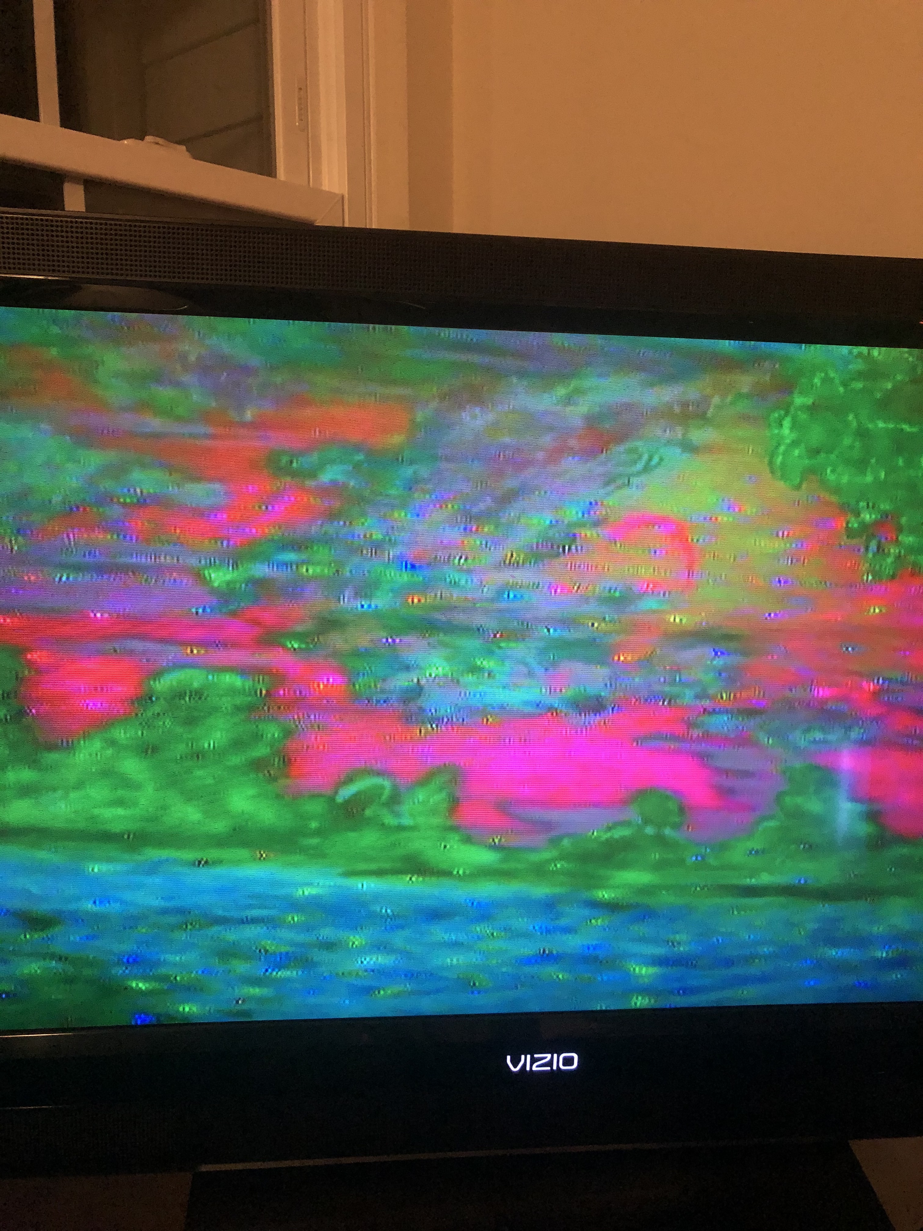

#13 — FloorHouse · 2022-03-10

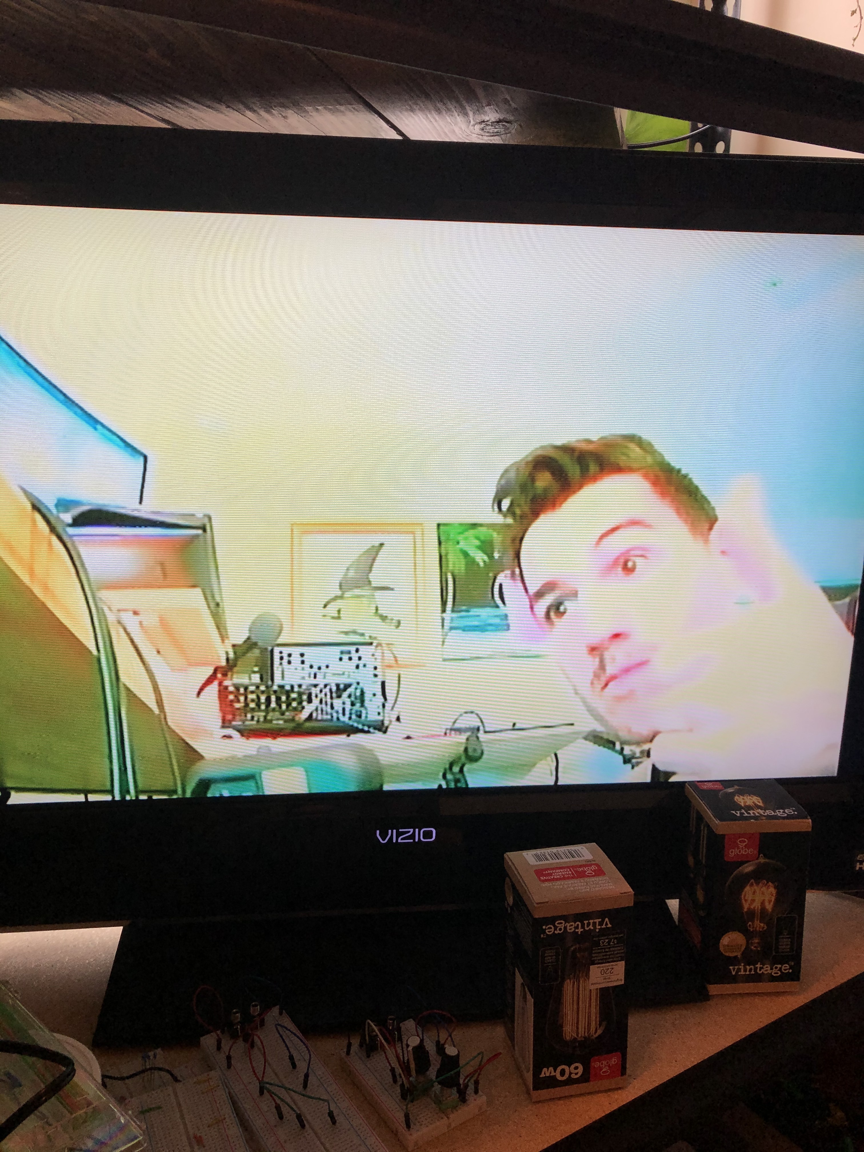

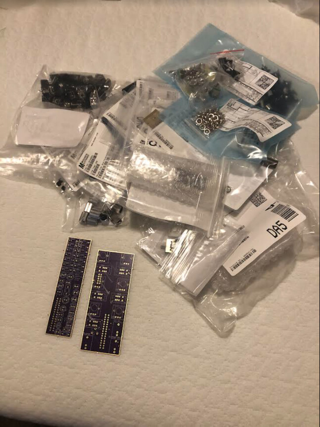

Finally got around to ordering RevA of the Luma/Chorma controller, and guess what . . . it didn’t work!
I decided to sit down and breadboard out something that could achieve what I want instead of designing complicated circuits in Altium and hoping they work when they show up (even though Altium is a lot of fun).
I made a passive lo-fi glitchy full color to grayscale doo-hickey and proto-boarded it.
It is essentially an input split to two signal paths A and B
Signal path A goes to the low pass filter from the schematic I posted earlier.
then it goes to a 1k potentiometer and into one half of a 100k potentiometer.
Signal path B goes directly to the other input of the 100K potentiometer.
The 100k potentiometer’s output goes to the output.

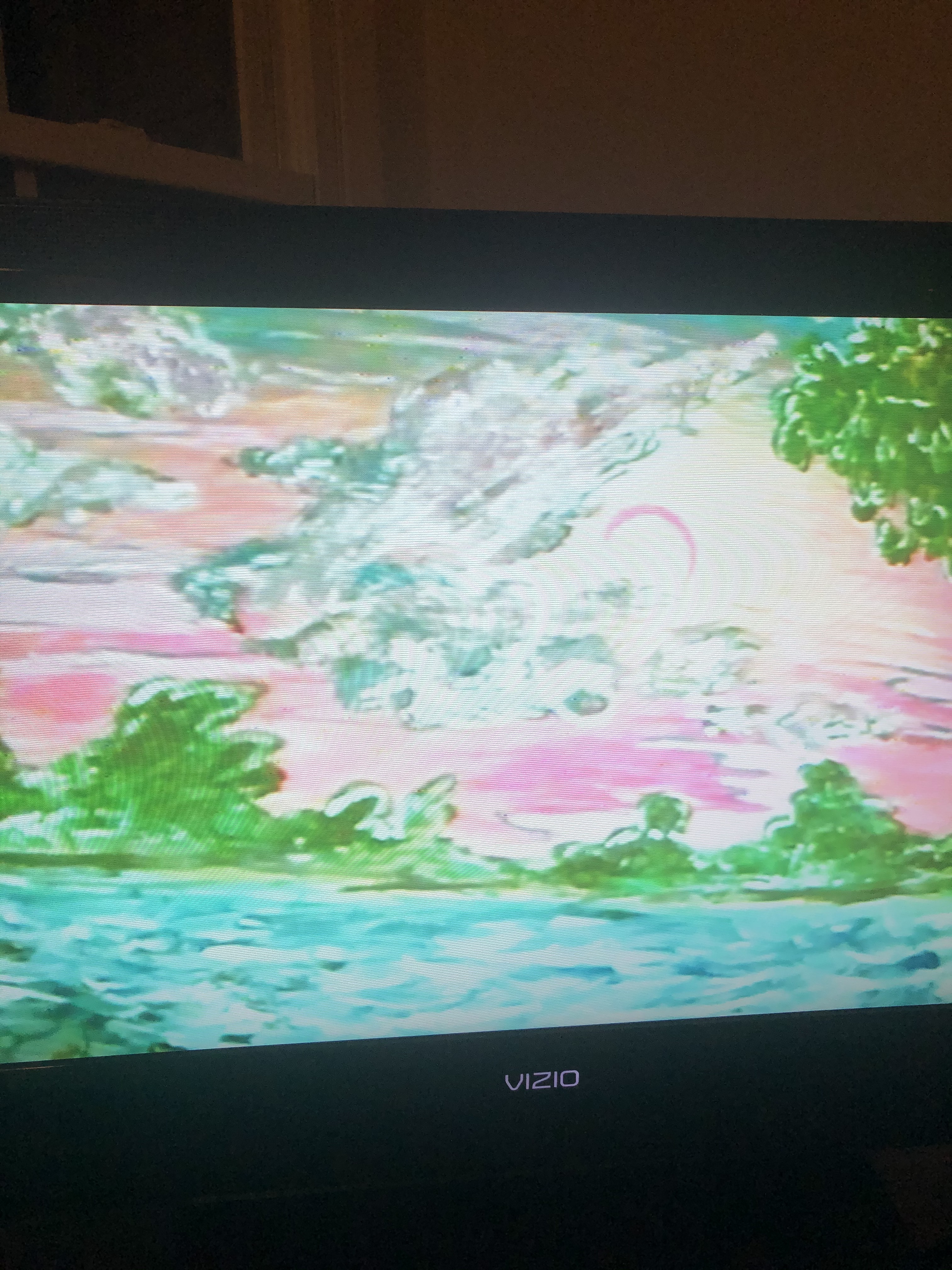

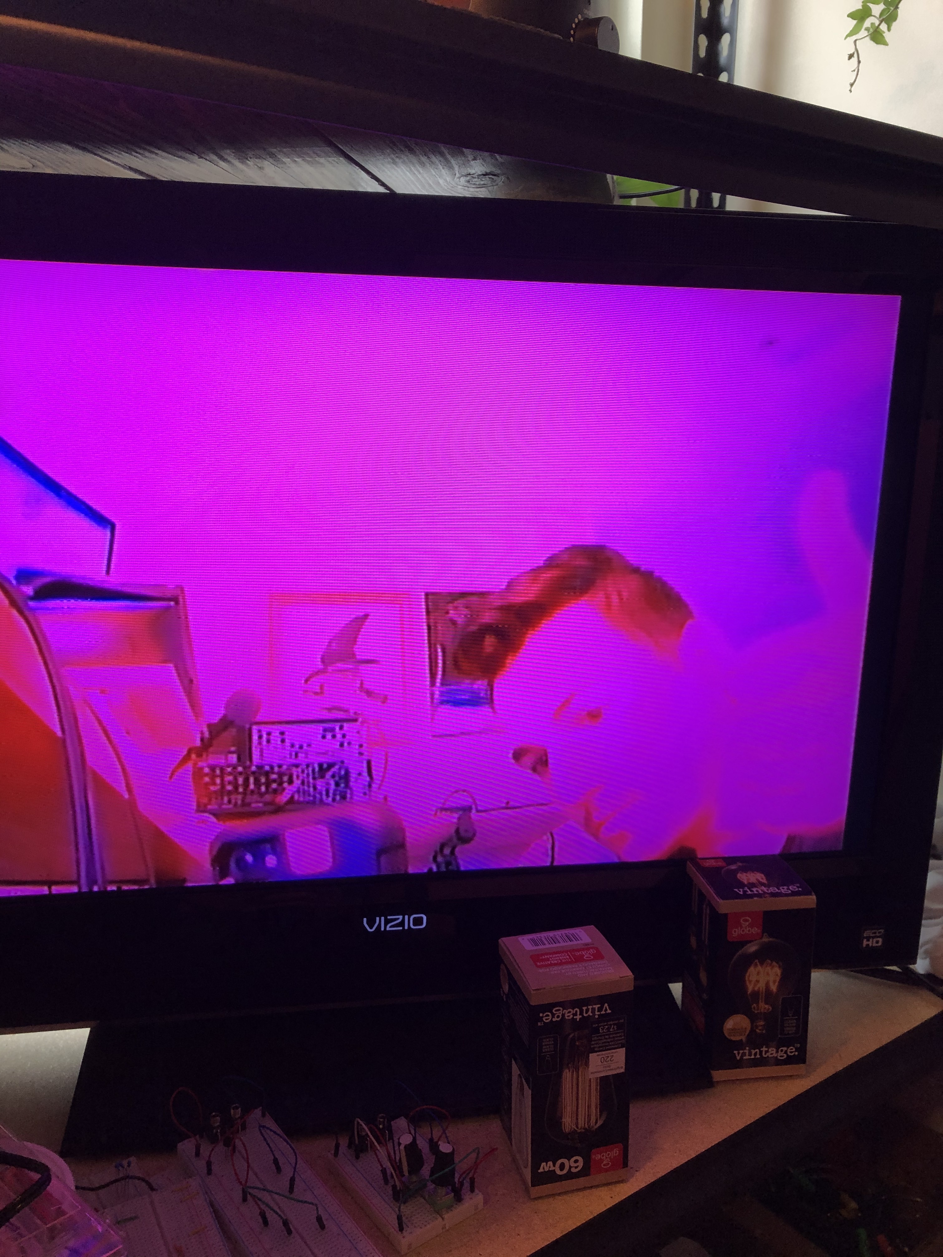

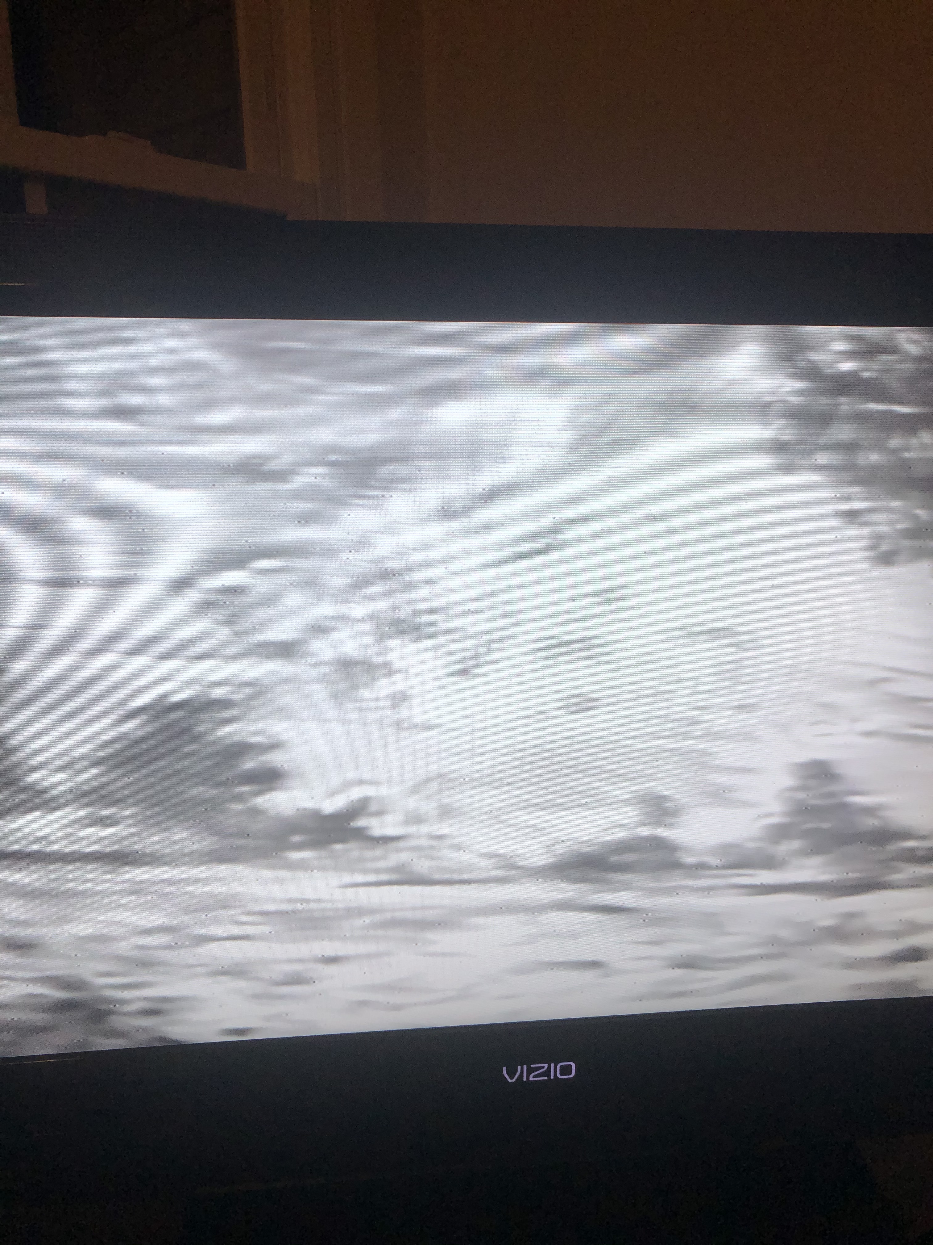

Some pictures below: Color
Color
Grayscale grayscale
Saturated Saturated
Now breadboarding out the chroma side of things, but it is not coming out as easily as the luma.

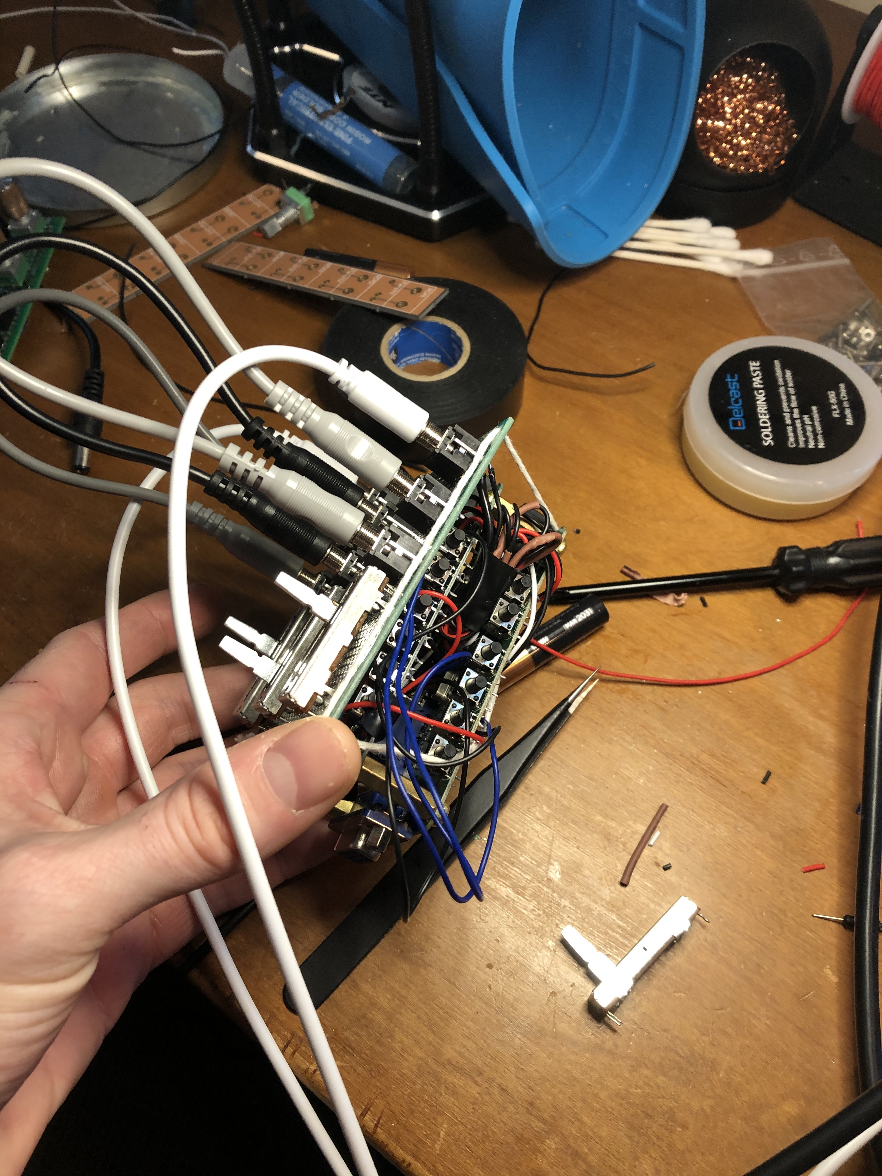

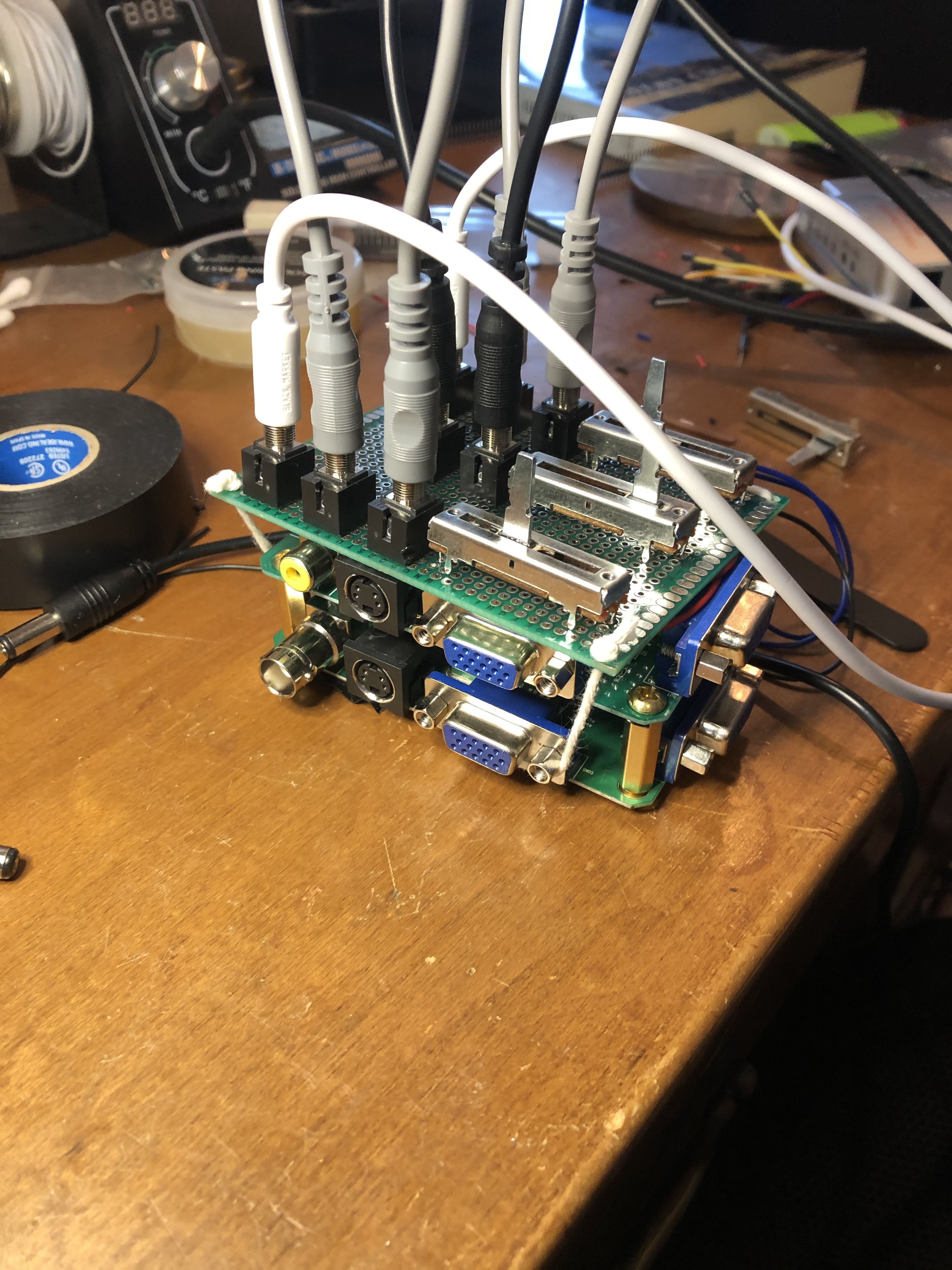

#14 — FloorHouse · 2022-03-23

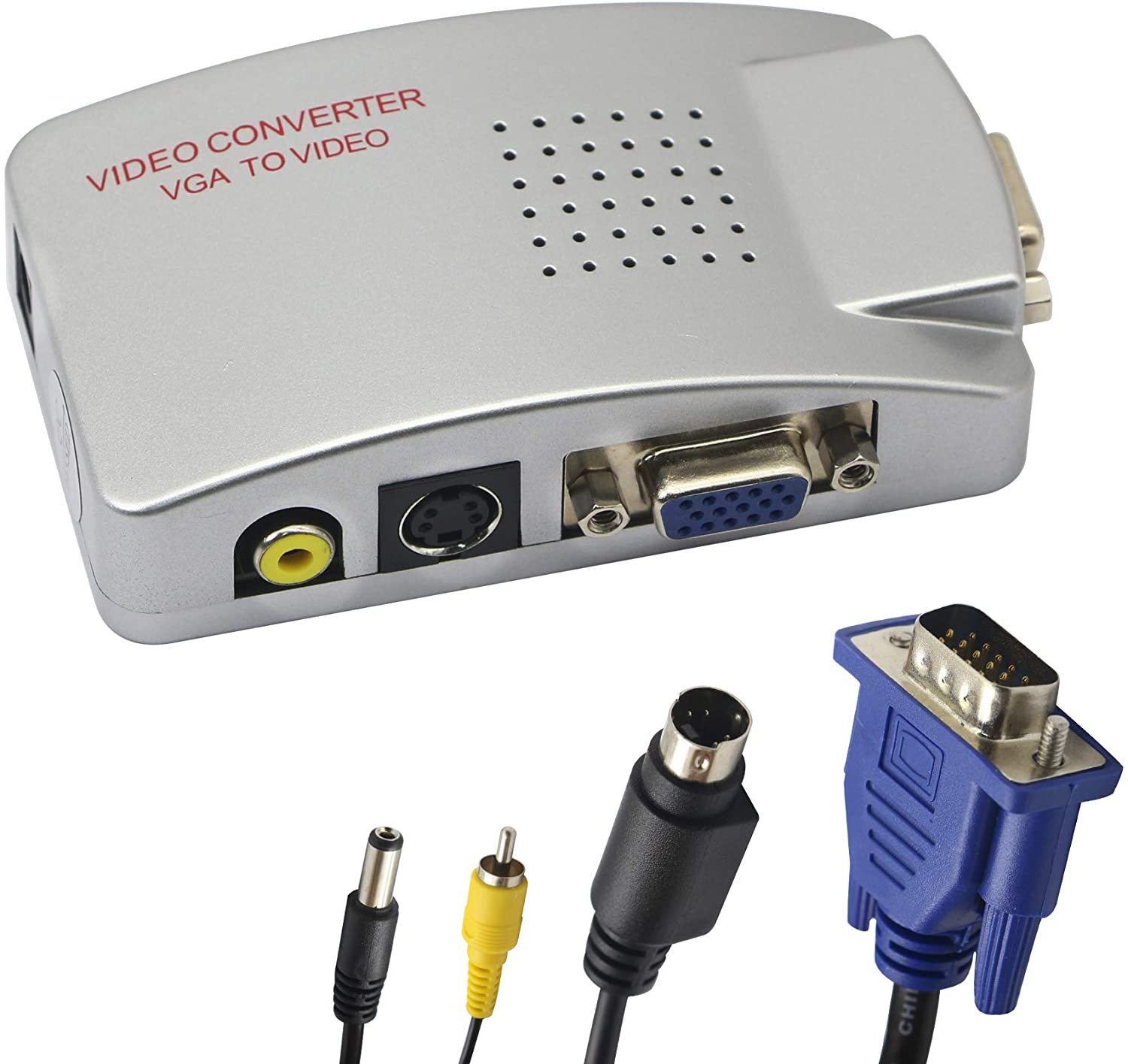

I ended up solving the “Composite RGB controller” as @creatorlars suggested, I convert it to VGA, expose the RGB signal paths, then convert it back to composite using some stock boards from Amazon:
amazon.com
https://www.amazon.com/Adapter-Composite-S-Video-Converter-Monitors/dp/B08DCNBZG2Supported VGA input resolutions: 640x480 (up to 85Hz), 800x600 (up to 85Hz), 1024x768 (up to 75Hz), 1280x1024 (up to 60Hz) and 2560 x 1600 (up to 60Hz). Adjustable NTSC, PAL, PAL-M, PAL-N and SECAM formats. Input port: VGA input Output port: Video...
$15.99Link: Amazon.com: GINTOOYUN VGA to RCA Adapter,Composite VGA to Video,S-Video...
amazon.com
https://www.amazon.com/Composite-Converter-Transfer-Projector-Computer/dp/B081SBNJ58AV S-Video VGA to Laptop Computer PC VGA Monitor Converter Adapter BoxProduct Features: VGA, 4 pin S-video, AV in; VGA out. Convert VGA/S-video/AV to VGA.Enable DVD/DVR, set-top box, etc to be displayed on PC monitor or LCD.Single button for easy...
$15.19Link: Amazon.com: RCA to VGA Adapter, Composite AV S-Video RCA VGA Female Input to VGA...
I wire up some patch jacks from Thonk for the input/output.
I added in patch points for the RGB out (from the composite to VGA board) and RGB ins (from the VGA to composite board) then some added in some 1k sliders between the RGB in patch points and the VGA to Composite board (though next time I’ll use 100k sliders for complete signal extinction).
The final product looks janky, but it would fit behind a eurorack panel!
IMG-3329
IMG-3328
and some demo shots:
IMG-3330
IMG-3331
With this I can control the intensity and path of RGB signals.
Further improvements I’m thinking of for this project:
  1. Plug and play" adapter board so I don’t have to do so much hacky wiring between the boards and the frontpanel
  2. Front panel so I can mount it into a eurorack case
  3. Linking the power in from both boards to drive them in parallel
  4. feedback?

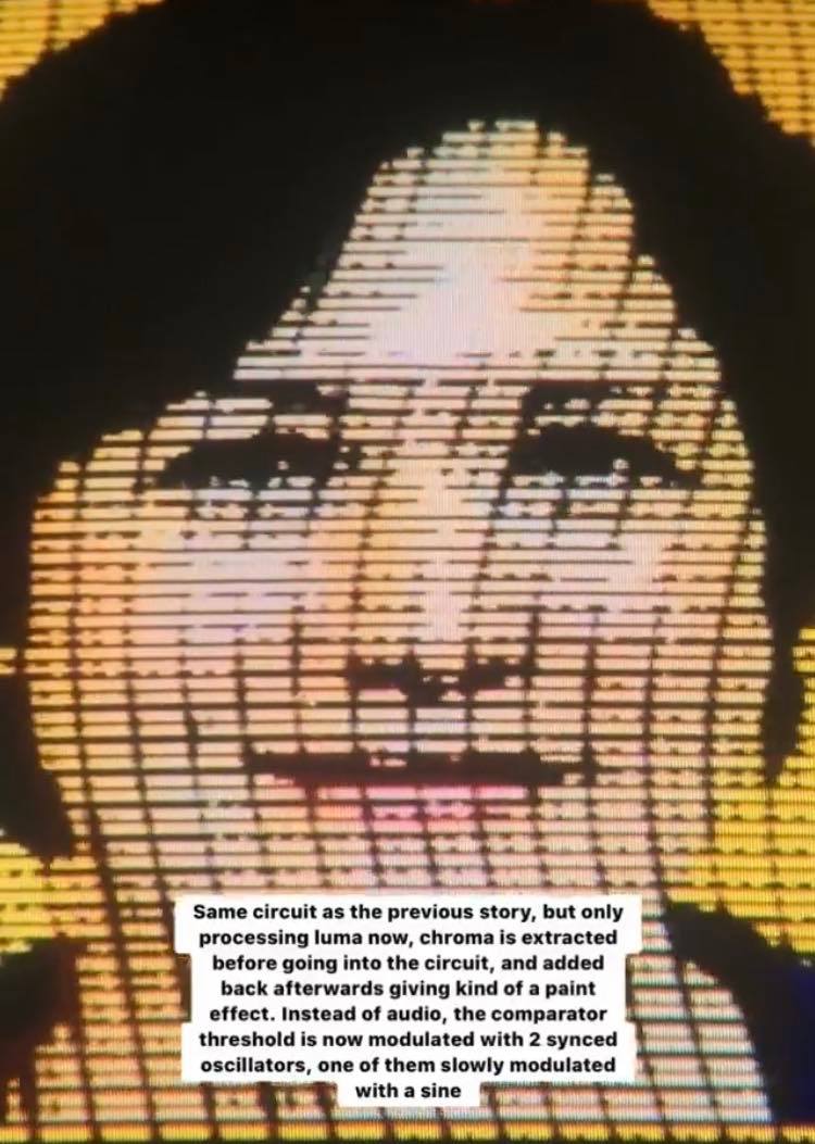

During the experimenting I did to get to this point I stumbled on a few other glitchy lo-fi circuits that make some cool effects.
I’m going to make a new thread to go over these circuits and pose some questions I’ve run into so far.
The solution I came up with is by no means original, I’ll credit LoFi Future with my approach.
I would have preferred to come up with a full through-hole component based approach, but I’m just not there yet.
I’m happy to mock up a diagram if anyone is interested, but it is fairly straight forward and you could turn to LoFi Future’s site for a similar but well documented solution:

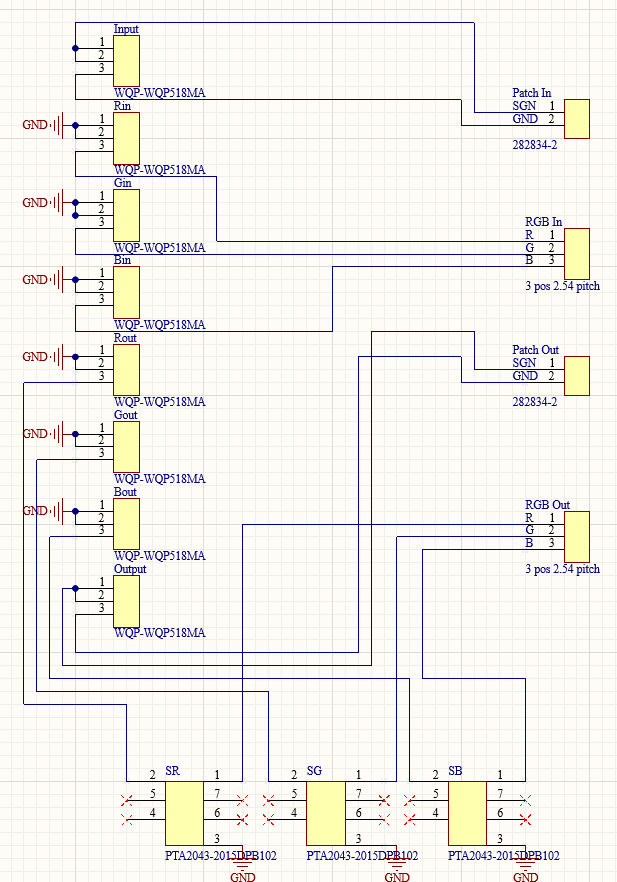

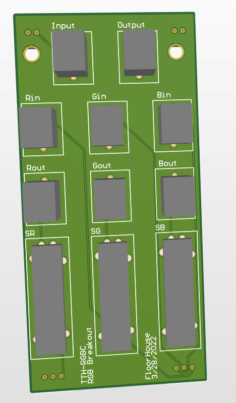

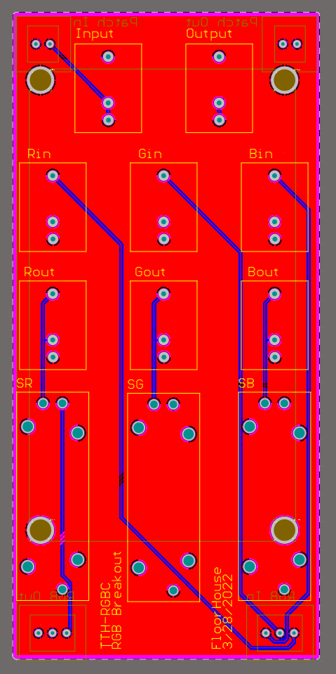

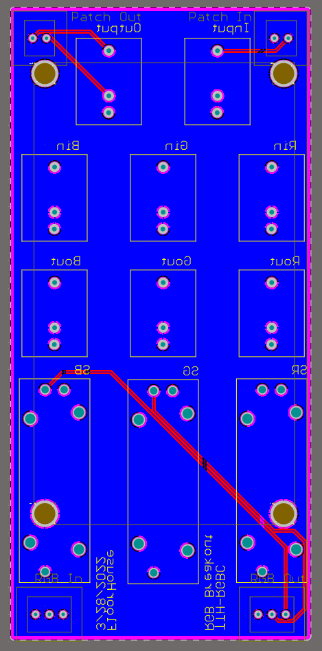

Whipped up a board:
RGBBC1
RGBBC2
RGBBC3
RGBBC4

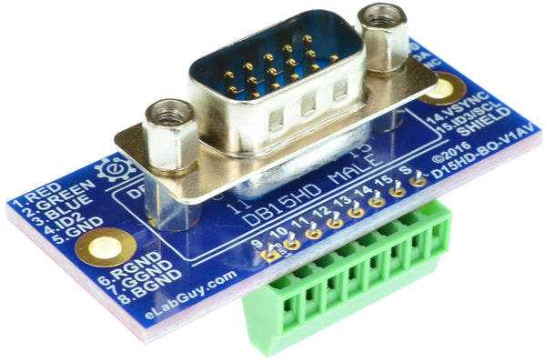

Uses the VGA to Composite/Composite to VGA boarts, sliders and patch jacks mentioned in the last post.
I also use 2x 2 pin @2.54mm pitch terminal blocks to handle the composite signals and 2x 3 pin @2.54mm pitch terminal blocks for the RGB signals
Unfortunately most VGA cables take up a lot of headroom, so I’m planning on using 2x of these to keep the package tight:
eLabBay
https://elabbay.myshopify.com/collections/breadboard/products/d15hd-m-bo-v1av-db15hd-vga-male-breakout-board-vertical-d-sub-elabguy?variant=30284175427D15HD-M-BO-V1AV Description: D15HD-BO-V1AV is a simple DB15HD VGA vertical connector breakout board. It brings all 15 pins of a DB15HD connector to screw terminal blocks or headers for easy testing, prototyping and breadboard connection. For...
PRICE: From $8.28 USD
Link: D15HD-M-BO-V1AV DB15HD VGA Male Breakout Board vertical D-Sub eLabGuy

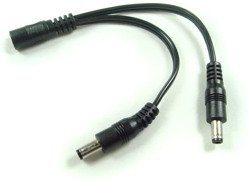

Instead of designing in barrel jack connectors to drive the boards in parallel, I’m going to use one of these:
amazon.com
https://www.amazon.com/PHC-DC-3Y-Barrel-Splitter-Female/dp/B009AZZ4ESThe plug splitter is a great way to distribute one source of power supply that uses 2.1mm x 5.5mm plug size to multiple device. This allows a network of power distribution through simple connection for small digital device that uses small amp ratings...
$6.99Link: Amazon.com: 2.1mm x 5.5mm DC Barrel Plug Splitter, 1 Female Jack to 2 Male Plugs...

Edit: Found a mistake in my schematic, I swapped the labels for SGN and GND on the 2 position terminal blocks, but this doesn’t matter since I can swap the inputs on the terminal block.

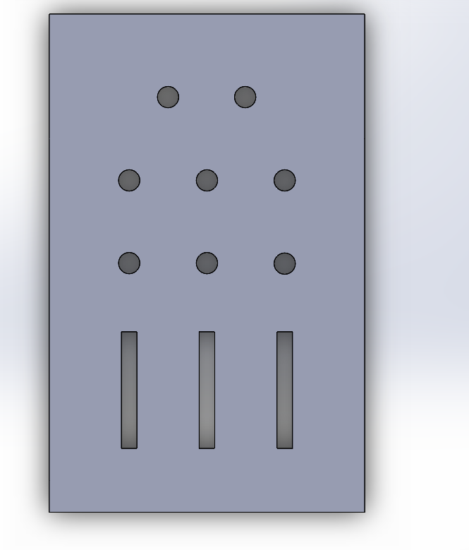

#16 — FloorHouse · 2022-03-29
Realized I have access to a 3D printer, so I mocked up a front panel design in solidworks:
RGBFrontpanel
Should be able to put everything together and test within a few weeks as parts come in and I can get them printed.
