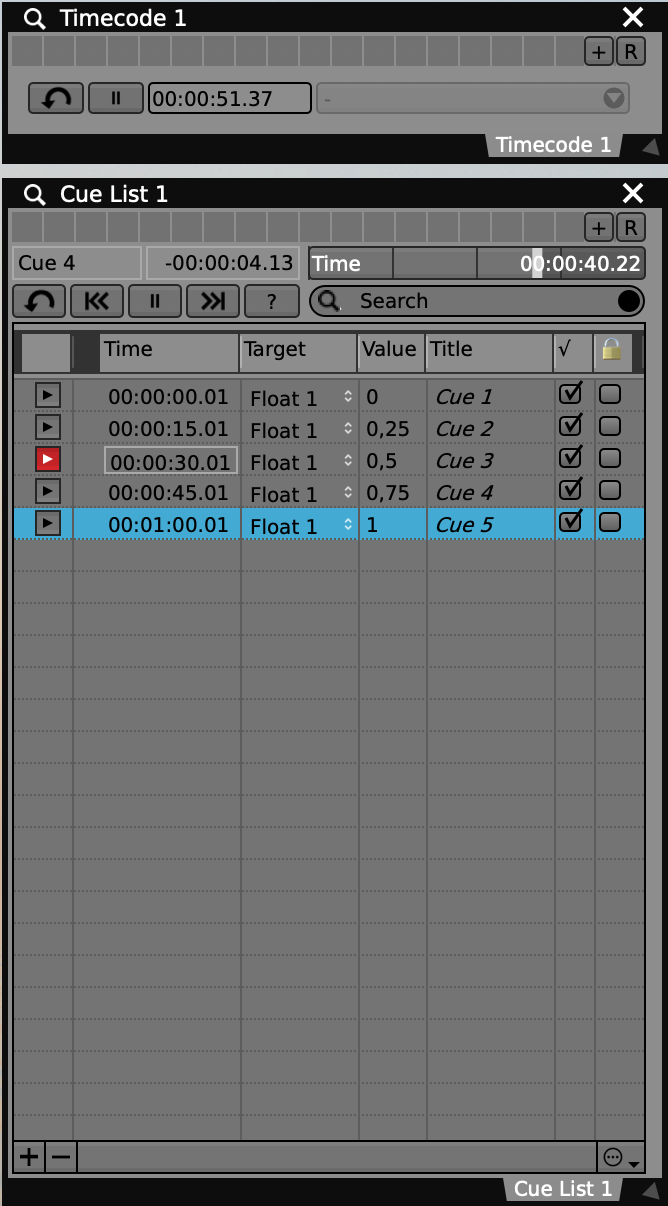

VDMX has a good implementation of something similar. Cue List.
Anything can be plugged as ‘time’ (normaled to timecode module) and the cues can go out to any target in the app (opacity of a layer, clip latch, etc). You set a fixed value/voltage output for the cue and slew/not slew.

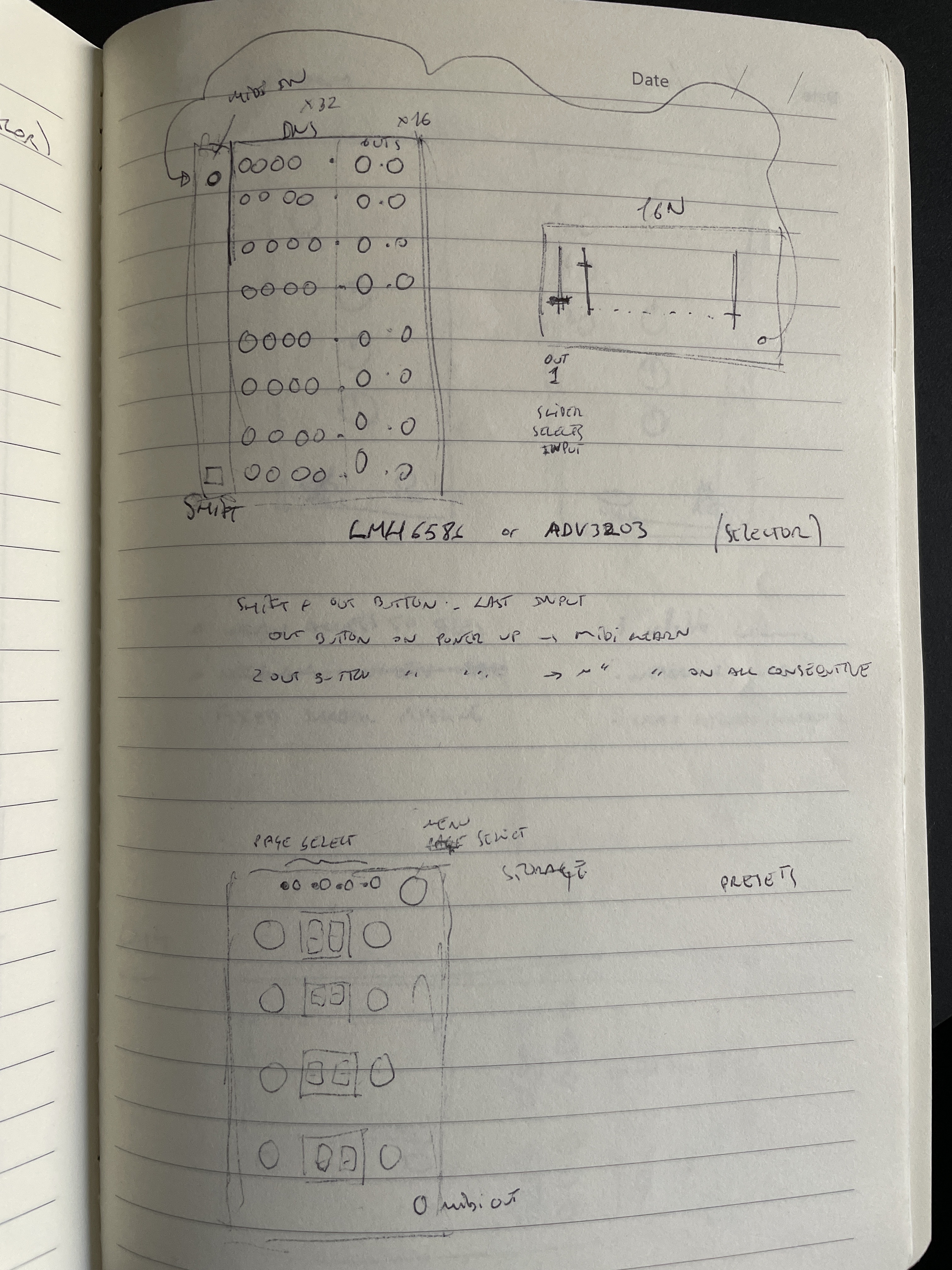

I have something similar to that in the sketchbook.
Not an animator module, more like a routing matrix with midi sequencing.
It’s a core module with 32ins and 16outs (lmh6586 or adv3203), as a huge matrix and midi-in.
A second module much simpler would be able to store the ‘patches’ and communicate via midi.
The midi communication opens up the possibility of using a 16n for example to choose the in for every single output (though with very little resolution per slider) or sequencers.

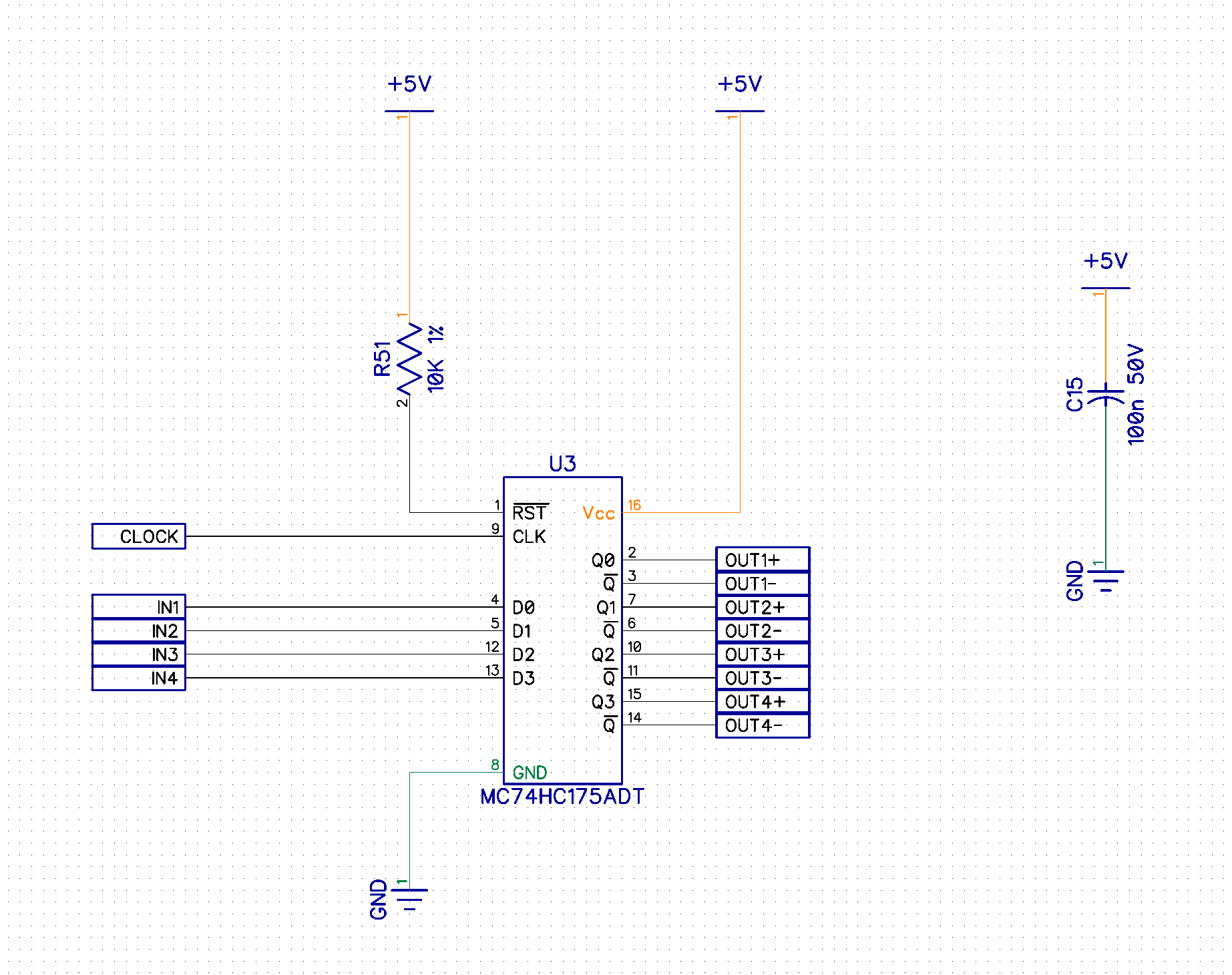

I’d have to review the castle modules, but a latch is also a “D flip flop” and I think that function is present.
Here’s how it’s implemented on gen3 modules with a 74HC175 quad latch IC. (Note all input/output voltages are 5V and you’d need to have comparators on all inputs going to a 3.5mm jack of course – this is just the heart of the circuit.) You can just feed VSYNC or whatever latch clock you want to the CLOCK input.
