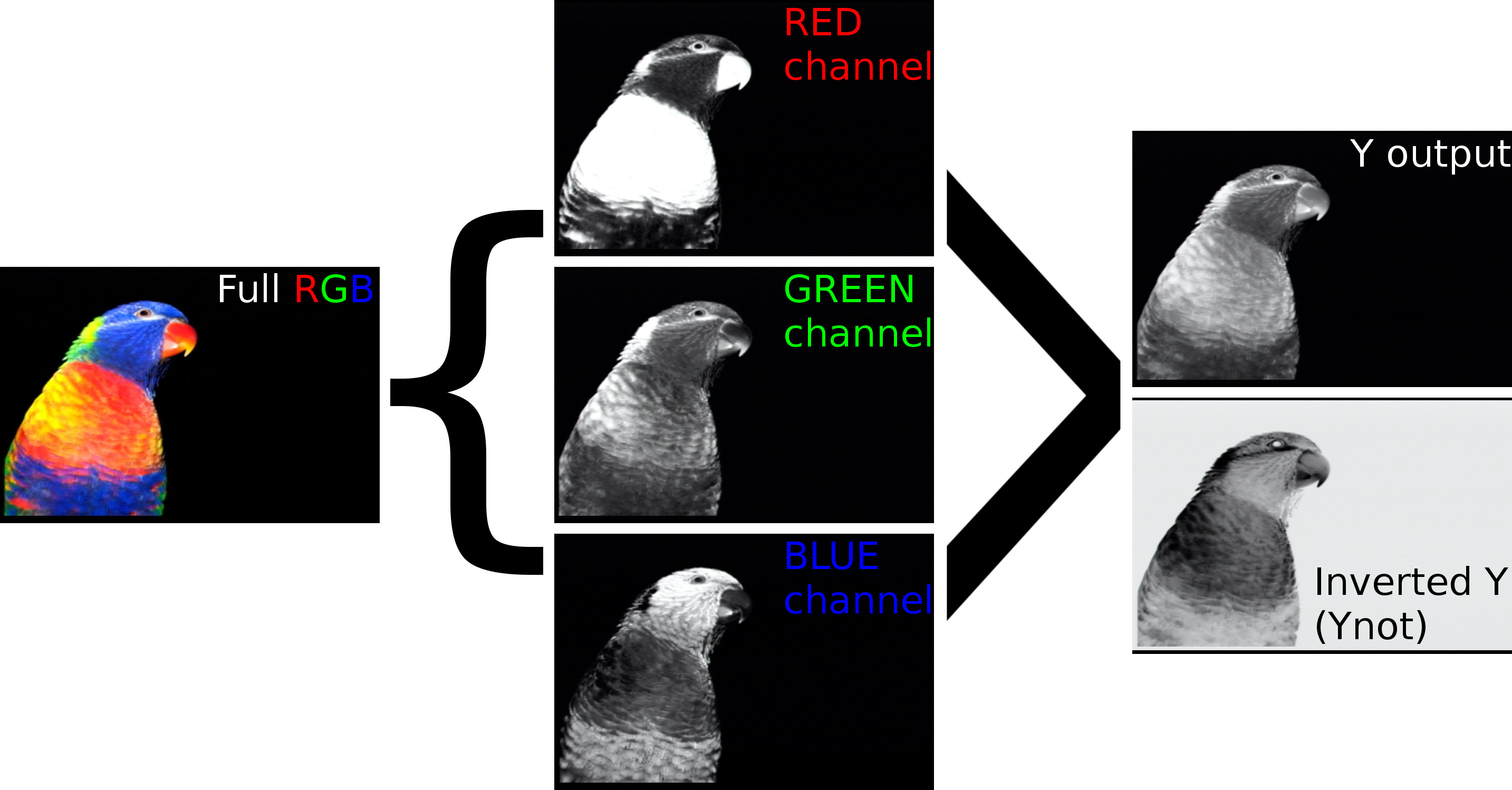

Description:LUMA (aka: and y not) converts an RGB image into the greyscale equivalent Y. Y is the specially weighted mix of R, G and B that accurately represents the luminance intensities of each color as they are perceived by the human eye according to the “International Telecommunication Union Recommendation (ITU-R) “BT.601.”
Much like B&W TV.
Y is an important signal for patching because neither Red, Green nor Blue alone can accurately represent a full color image’s perceived brightness levels. Consider the differences in this example:
exmpleRGB2Y
You may recognize the term on LZX’s Memory Palace, CTBC, the forthcoming TBC2, and Visual Cortex (as Luma), etc., but this gives you the same function in a minimal 4HP package and it can be applied to any RGB set – not just hardwired to an input amp, for instance.
tl;dr Users may now get Y from any arbitrary RGB set they choose. LUMA also buffers the original RGB inputs and offers an inverted Y.

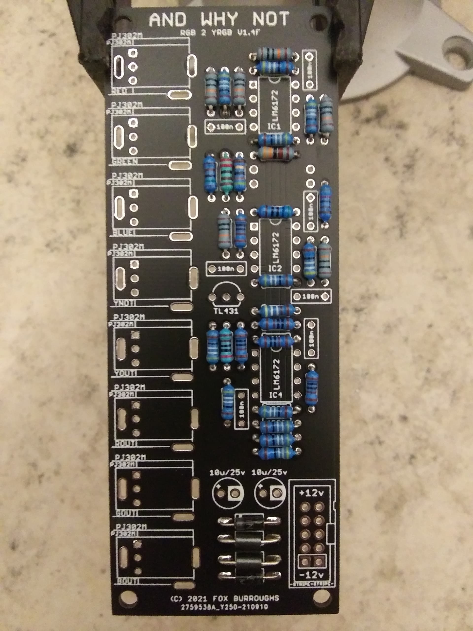

Step 1.

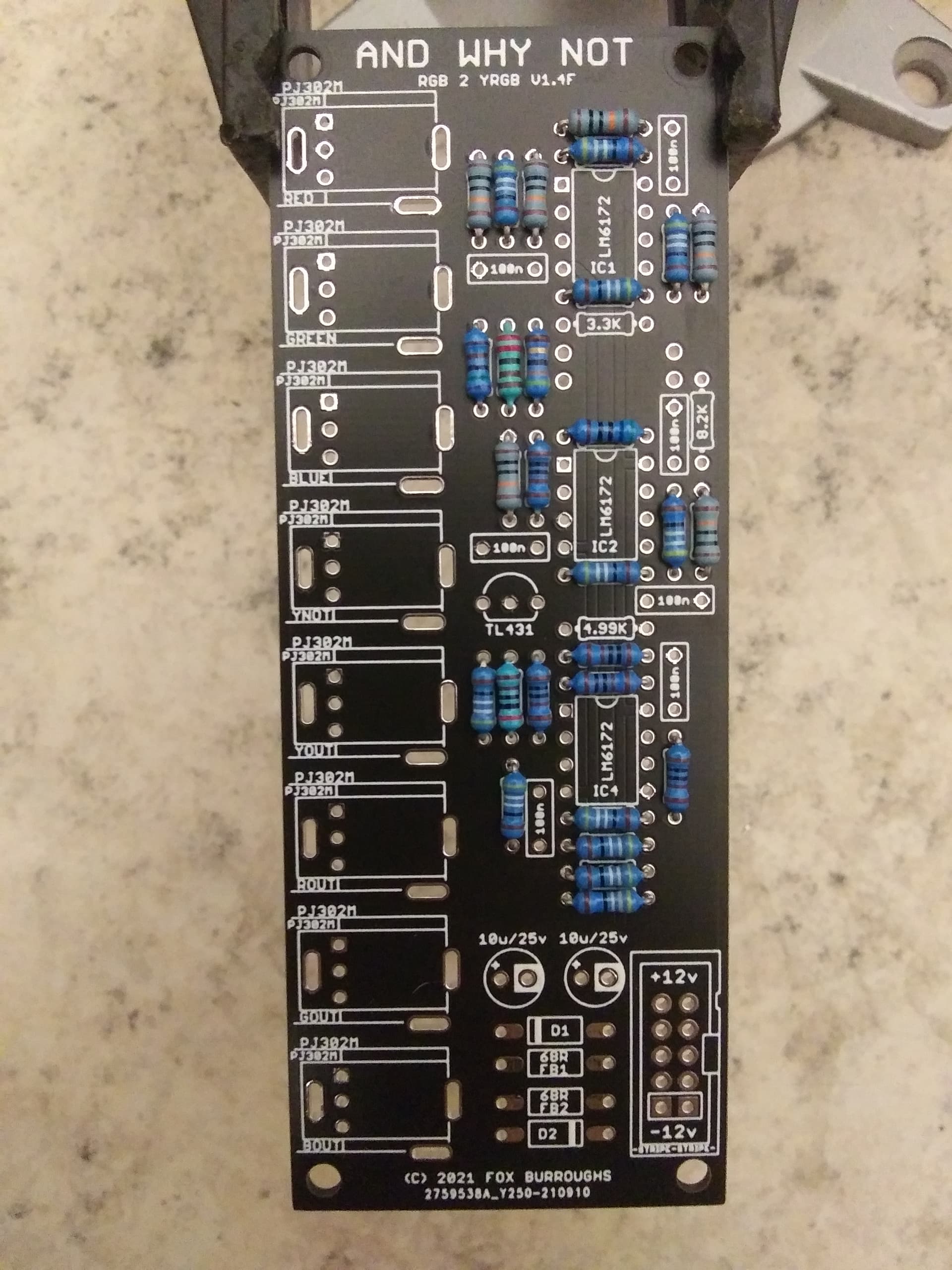

We will start by populating all of the shortest components. Place all twelve of the 499 ohm resistors.
I suggest soldering all of the resistors at once after you’ve finished populating them into the board.
20210927_205811
Step 2.
Next populate all of the 1K ohm resistors. There are five.
20210927_210000

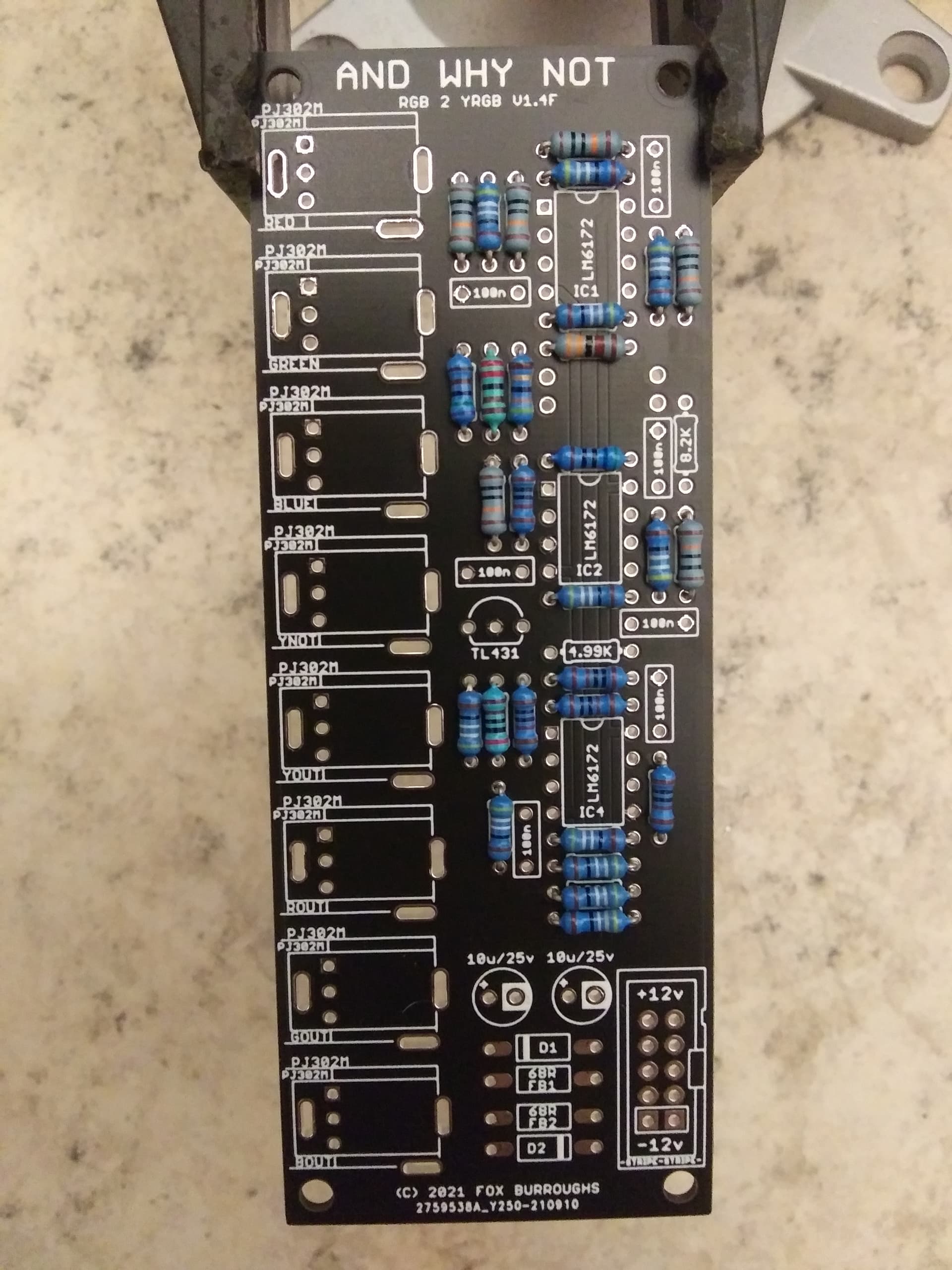

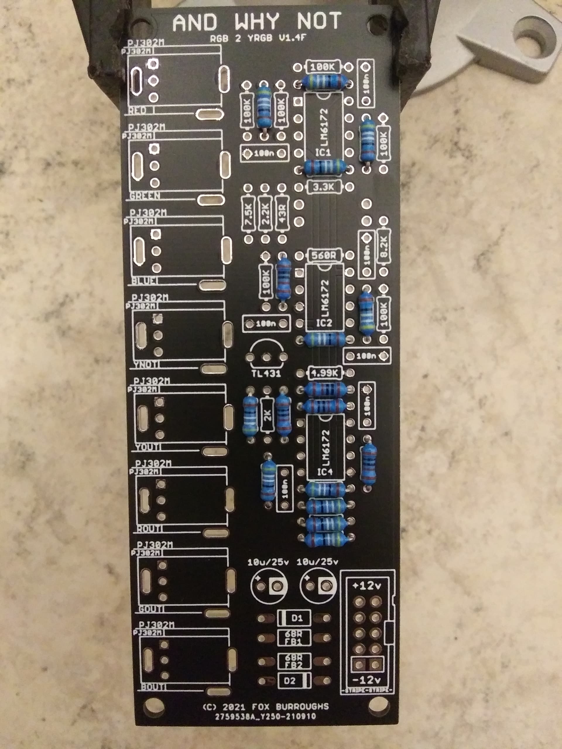

The remaining resistors are all different values but only have one of each. We’ll move through through these ones a little more quickly.
Populate a single 43R
20210927_210238
Populate a single 560R
20210927_210317
Populate a single 7.5K
20210927_210350
Populate a single 2.2K
20210927_210423
Populate a single 2.0K
20210927_210550
Populate a single 3.3K
20210927_210615

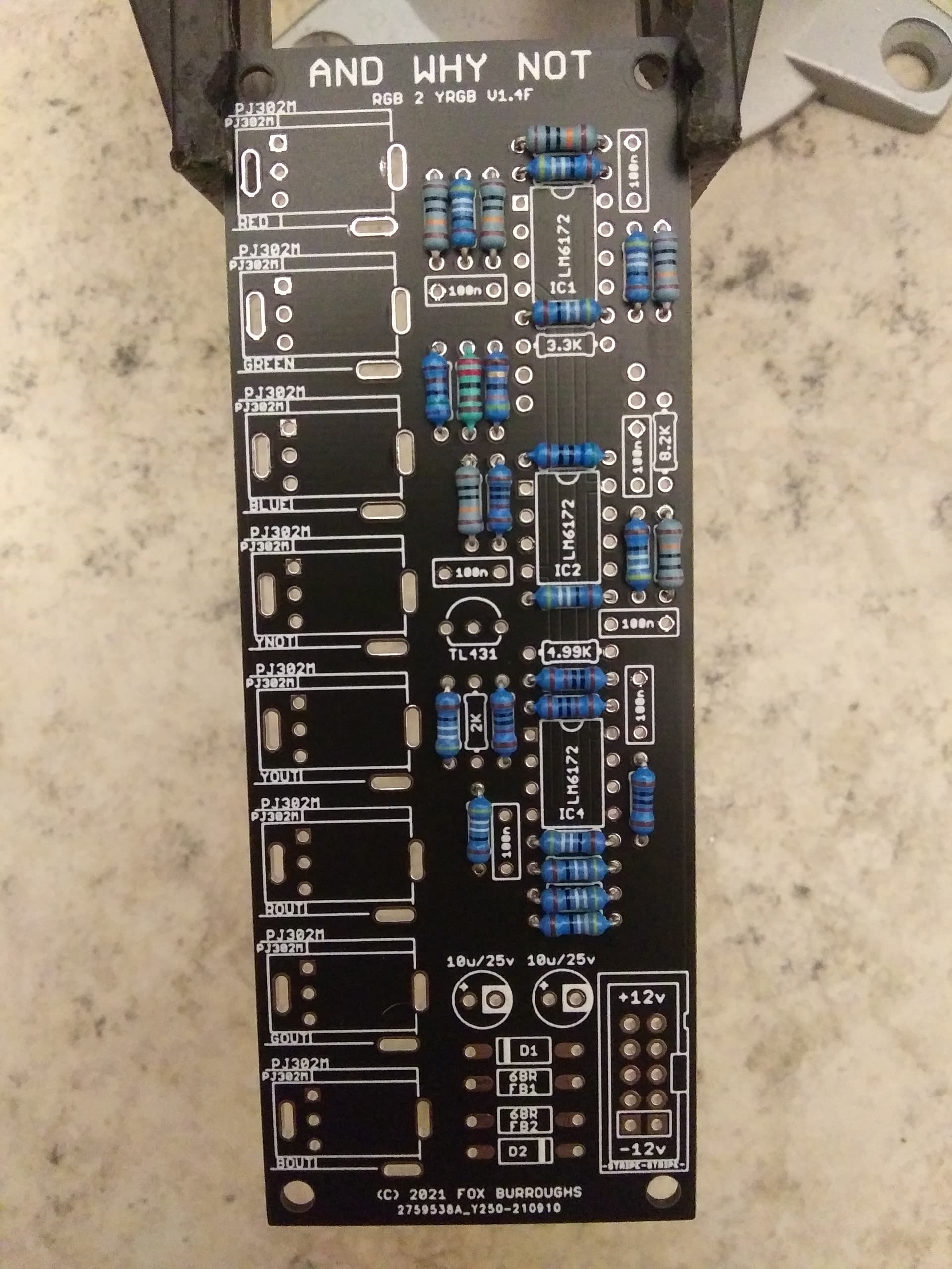

Populate a single 4.99K
20210927_210650
Populate a single 8.2K
20210927_210720

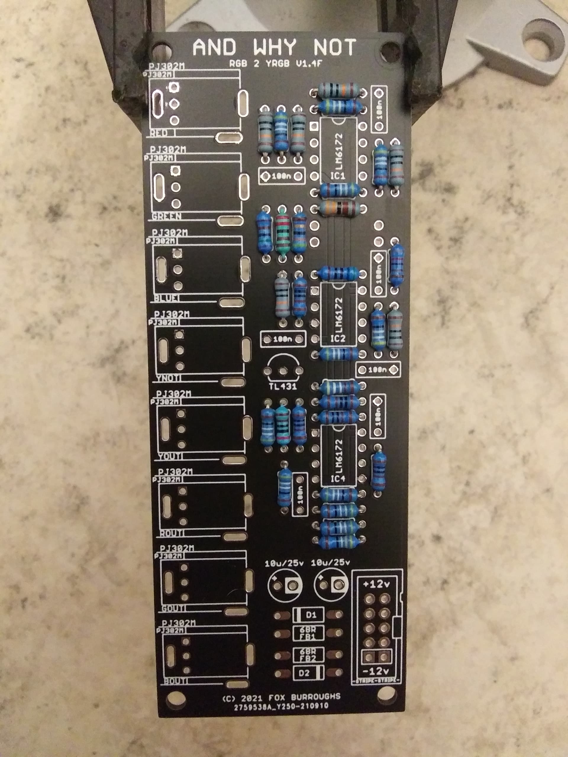

Step 5.
If like me you have waited to populate all of the resistors before soldering, you may do so now. Carefully flip your board over onto your work space and solder them in place. Clip all of the leads.
Step 6.

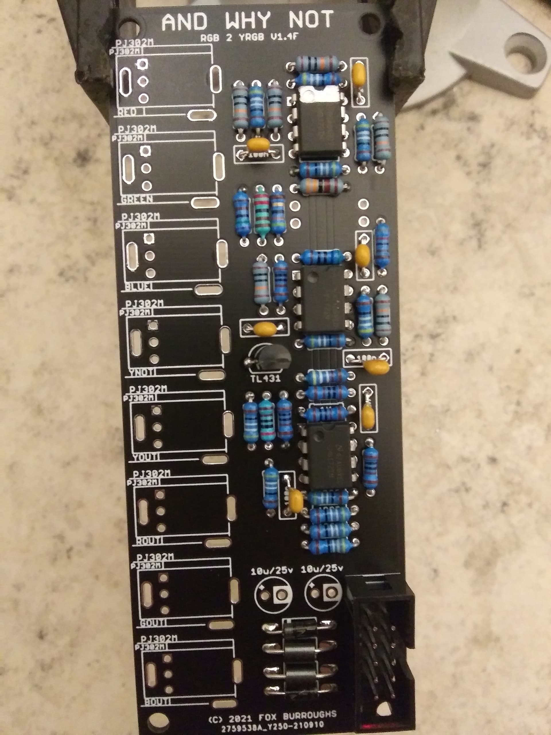

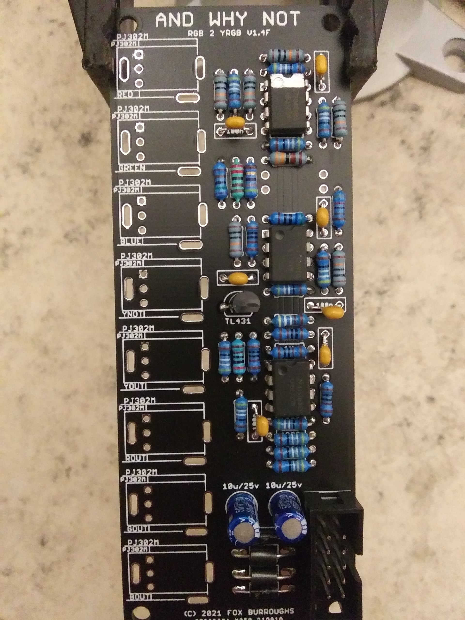

We’re moving on to the taller components now. Populate both ferrite beads and both diodes. Solder and clip leads. Take note that the diodes are polarized and the stripe on each diode must line up with the stripe on the silk screen.
20210927_211849
Step 7.
Now populate all seven ceramic capacitors. Solder and clip leads.
20210927_212005
Step 8.
Populate the TL431 in place lining up the flat side with the silk screen. Solder and clip leads.
20210927_212223
Step 9.
Now you may populate all three of the LM6172 op amps. Be careful to place them in the correct direction. The silk screen shows a circle where pin one is to be placed. Pin may be identified on your chip by the adjacent dot in the plastic encapsulation.
20210927_212337
Step 10.

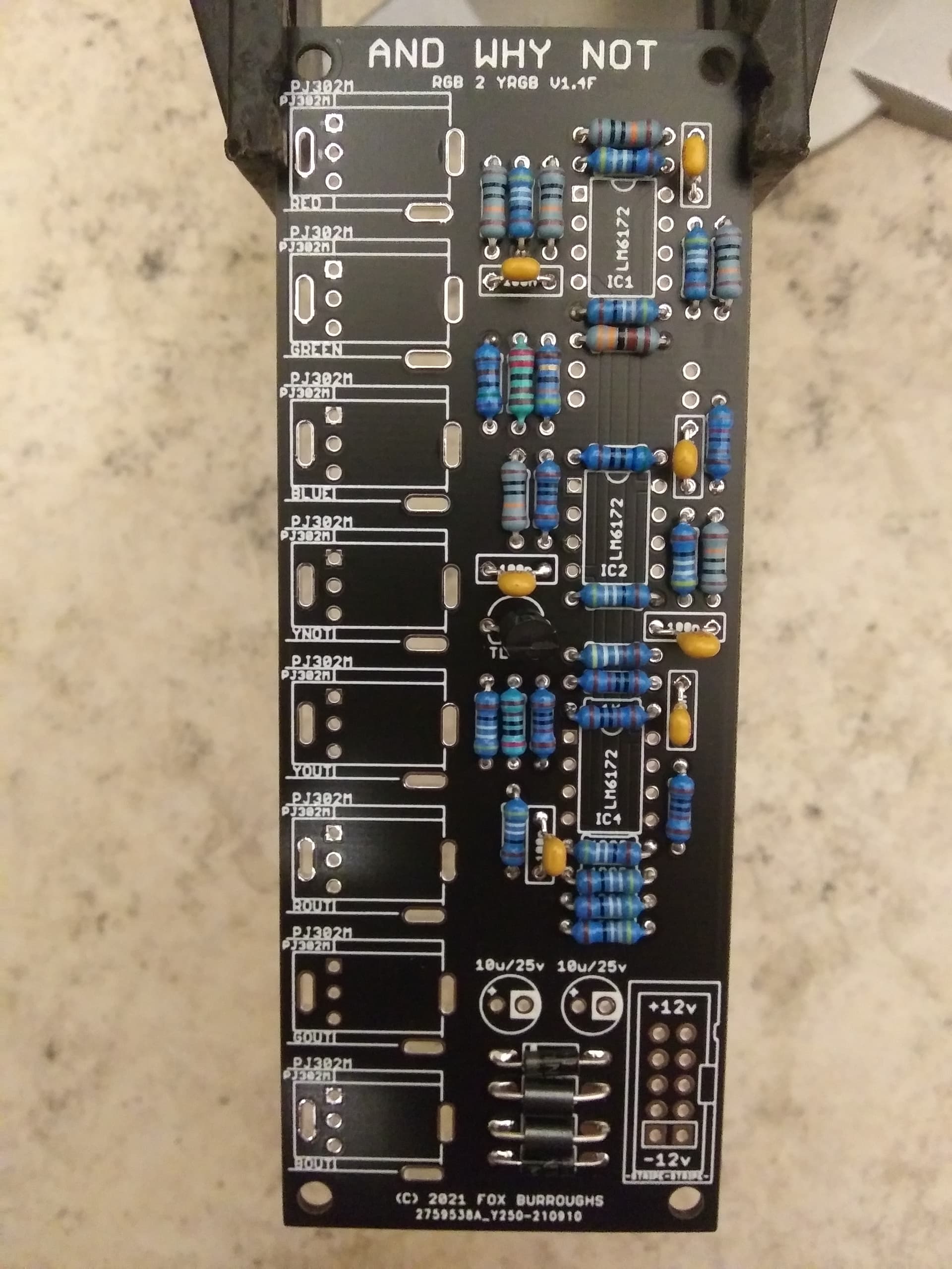

Populate the 10-pin power header. If you have selected a shrouded header box as I recommend, you will see a cutout on one side. Line this up with the silkscreen. (The cutout faces out)
20210927_212646
Step 11.
Now populate both electrolytic capacitors. These parts are also polarized so line up the stripe on your caps with the pin that is circled. Solder and clip leads.
20210927_212717

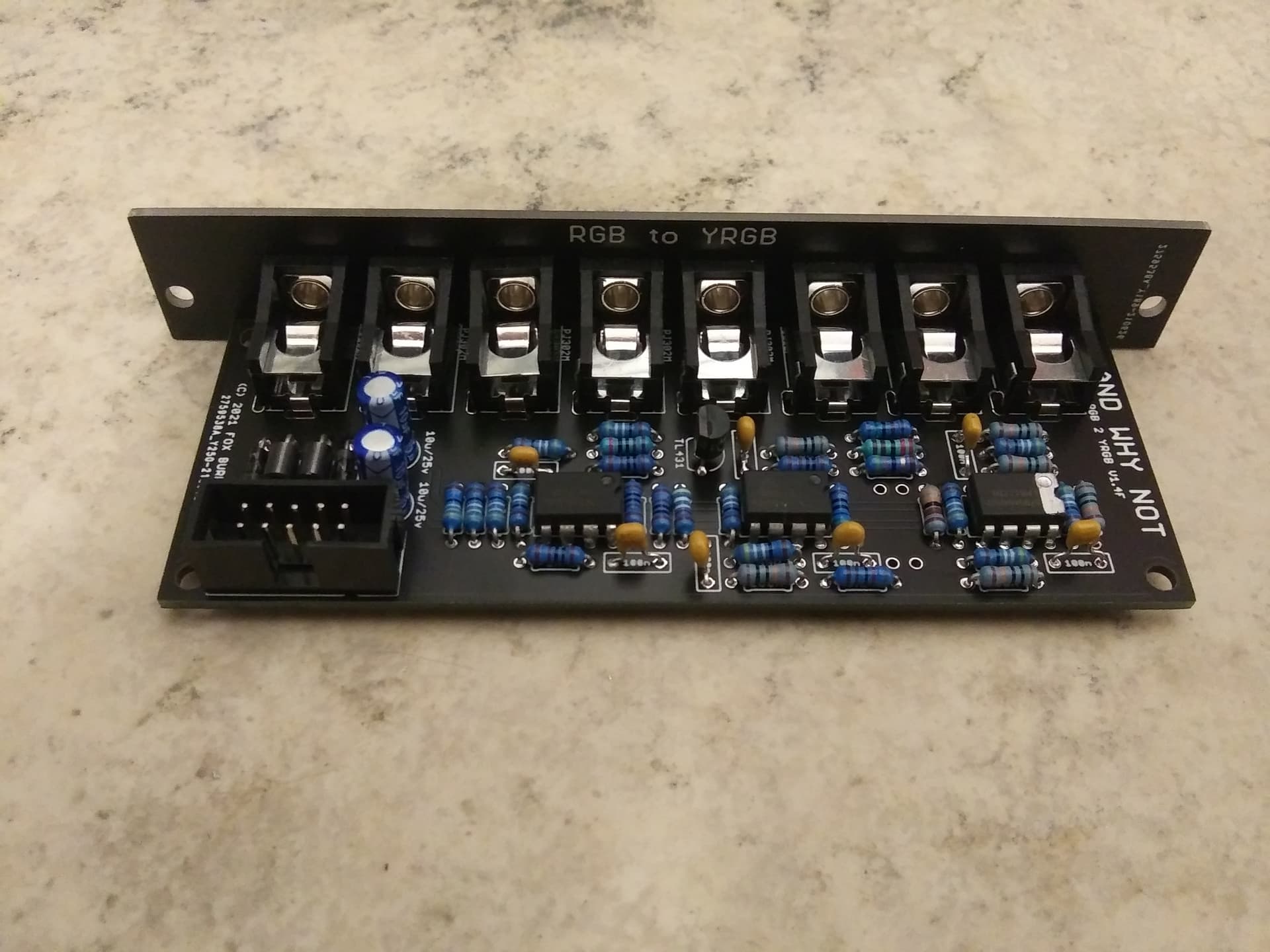

Finally you may populate all eight of the jacks. I suggest populating all of them and attaching the faceplate before soldering. This ensures that each one of them is lined up.
20210927_213018
Step 13.
And to finish it off, I highly recommend you treat yourself and color code all of the ins and outs with some befaco banauts. Two of each red, green, blue and yellow.
Go ahead and test out your work.
20210927_213639
