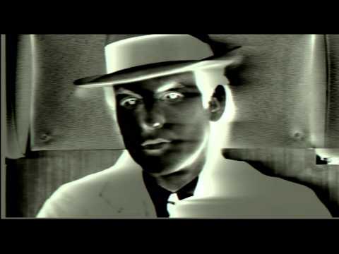

OK, I misspoke… it’s not that the Differentiator only has edge detection on one side. Rather, I meant to say that the effect is one-directional. Looks like an emboss filter. With extra smearing. Not really my thing.
https://www.youtube.com/watch?v=VB5X0HPBzgk
