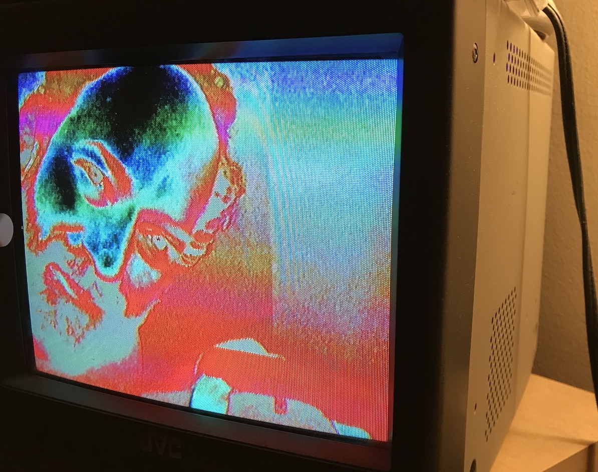

I hadn’t tried it yet but just quickly connected a few things to try it… and it worked great! I did as rempesm and lars recommended. A quick little self portrait as proof:
IMG_7178
Sync: Camera → Cadet 3 → ESG3
Video: Camera → Cadet 3 → Staircase → ESG3

Yeah, @Vdot is right. The Cadet 3 is a composite-to-luma converter, and the luma output of the Cadet 3 is what you’d use with your LZX gear as a video (or modulation!) signal, and the composite video output of the Cadet 3 is just used for sync.
More detailed patch notes: In the case of my example picture, I’m feeding the luma output from Cadet 3 to the source input on the Staircase (which is like the red input on a Stairs module), and then using two of the /1 and the /2 outputs of the Staircase to feed the red and green inputs respectively on my ESG3 (and since blue is unpatched, the green signal is normaled to the blue input). A simple-to-patch colorization method (since luma has no inherent color).
