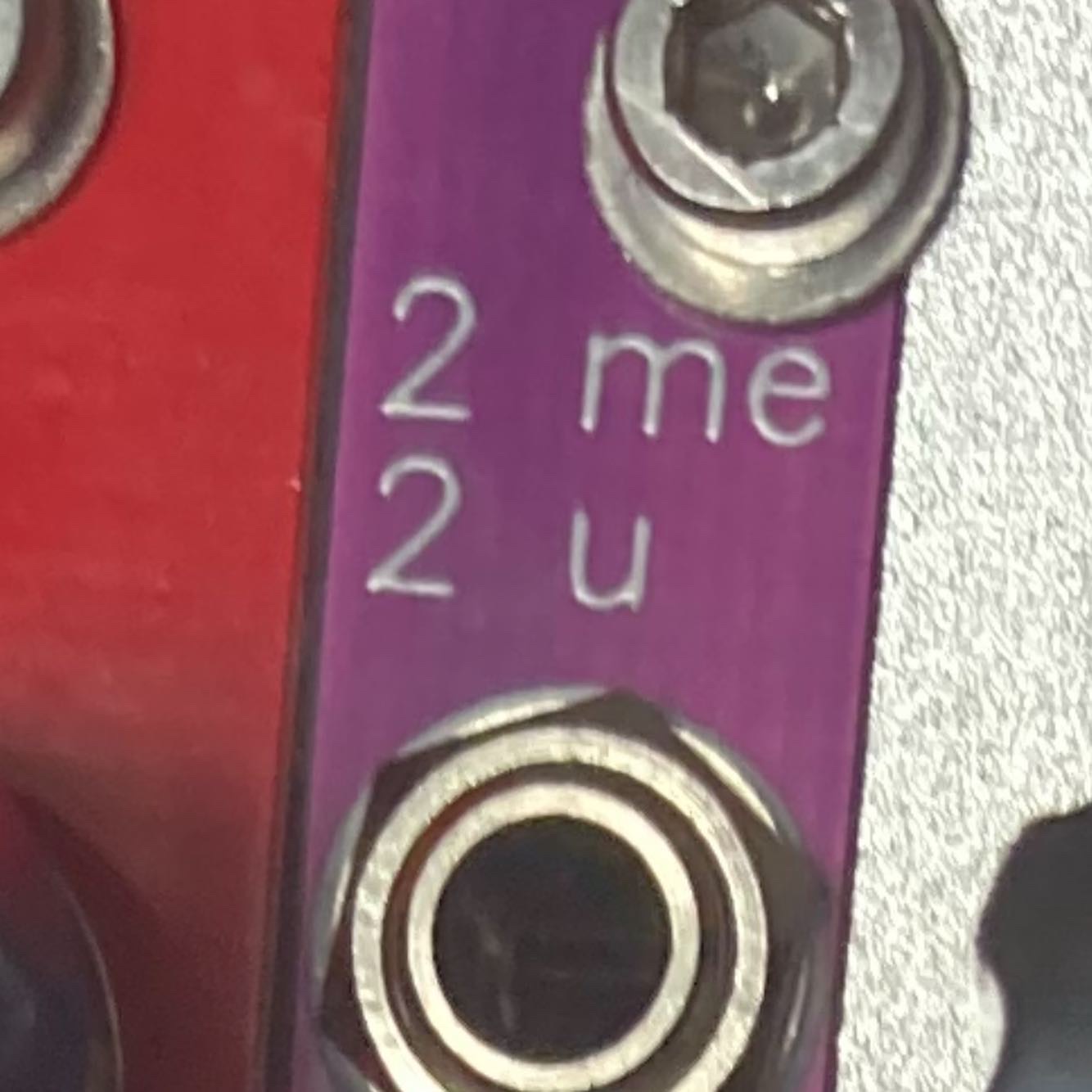

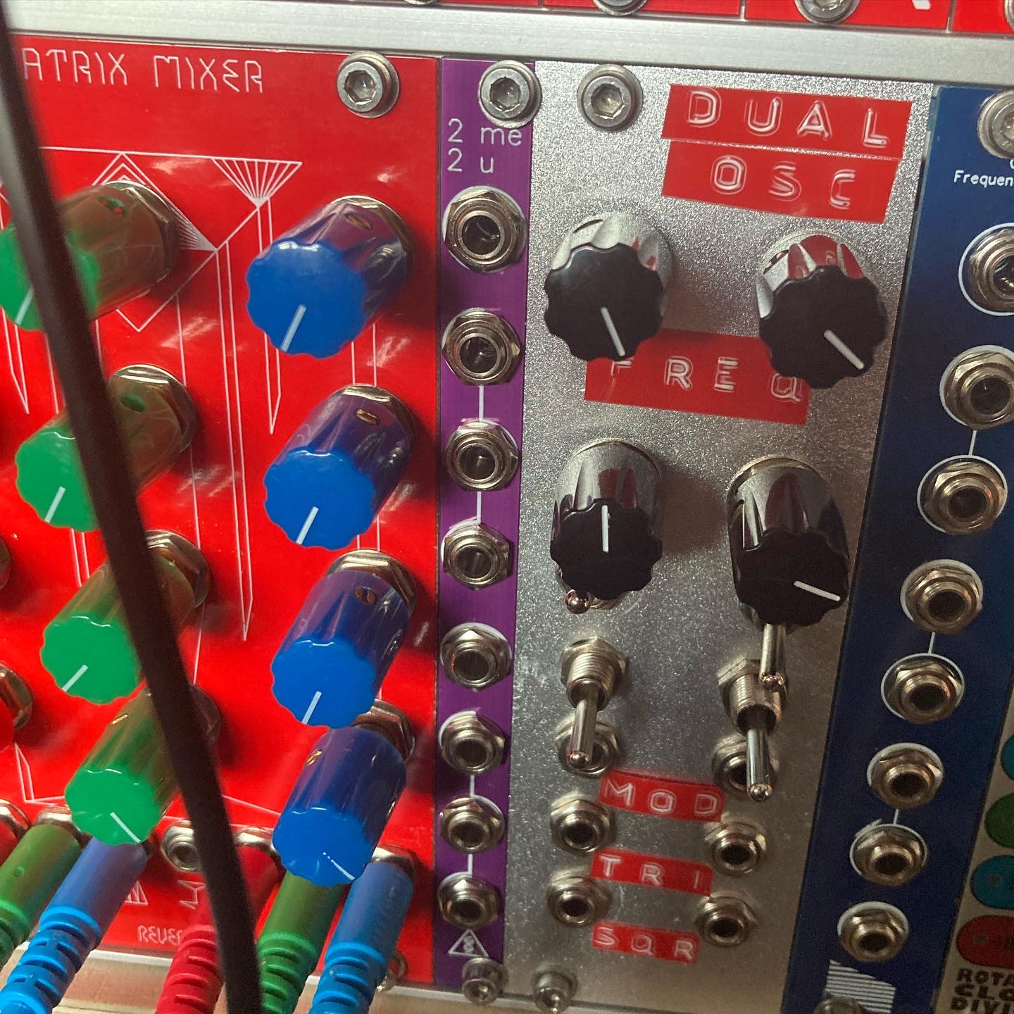

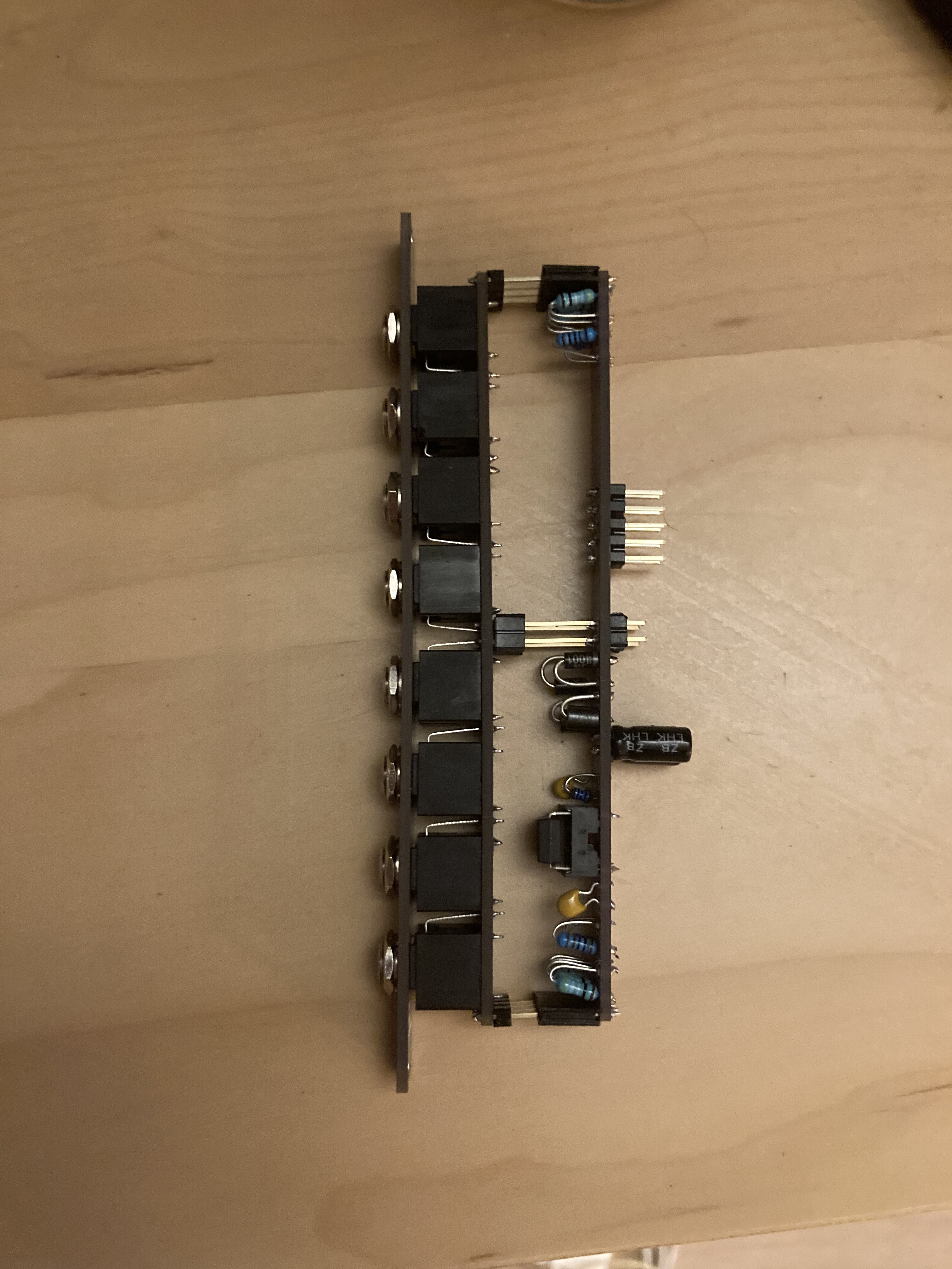

Finally my first foray into designing some DIY modules. I’ve put together a 2HP Video Mult built around the LM6172 in order to eke out a final annoying 2HP in my case. It’s normalised across the two circuits so can be 1x6 or dual 1x3. I’ve also added headers for external normalise ins and outs to 1x2 headers so multiple modules can be connected behind the panel to provide copies across a case using dupont cables or similar.
I’ve built up one which is working great and will build a second to check the external normalisation is working as I hoped. Then I’ll order some more boards (with some slightly revised silk screen) pretty soon if there’s any interest! Will post pictures and schematic below. Other projects in the pipeline too! As always thanks so much to all the designers who have made their schematics open source.

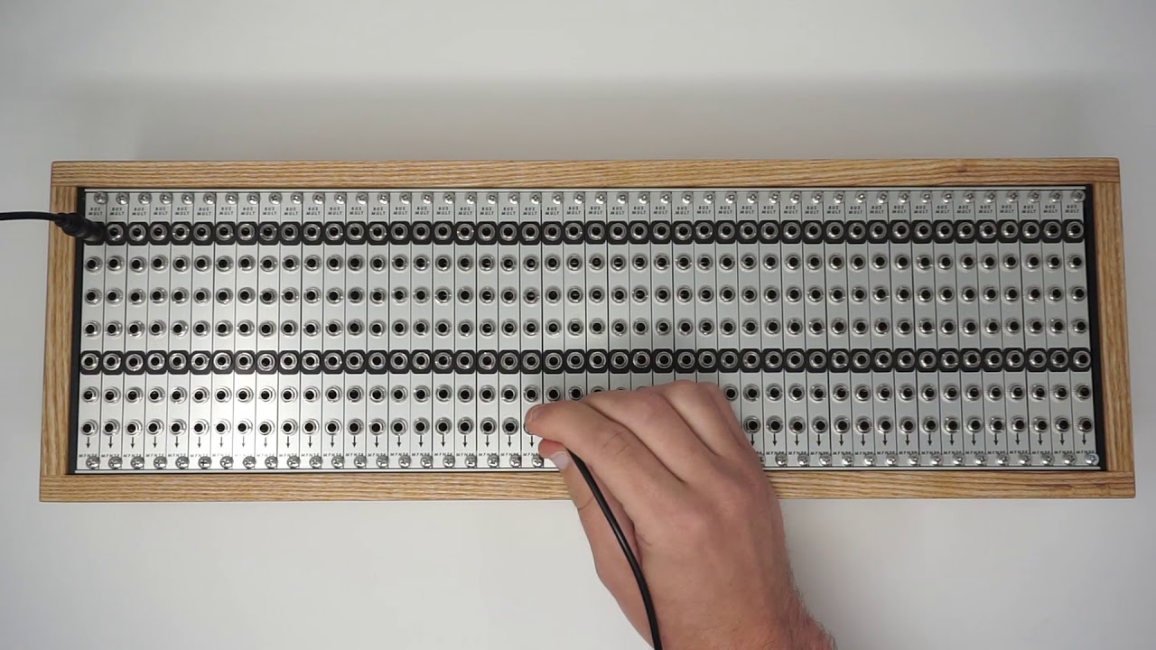

EDIT: Reminds me of Moffenzeef Modular’s unavailable Bus Mult but for video! If you build up enough of them, you know you’re obligated to do a demo video like this
:stuck_out_tongue:
https://www.youtube.com/watch?v=q4574yqvc04
